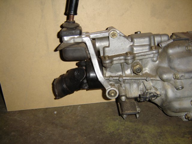

Just finished installing R154,(updated post) pic of where your shifter will move back to when you fit the Soarer extension housing I have the Chaser 154 ,which is the same as Soarer, think you will definately need a LSD,( totally different to drive compared to the smooth civilised auto, diff ratio might need stepping back a bit as well) If you have the non cable electronic speedo, wire up could cause problems, it can be done, but beyond me.

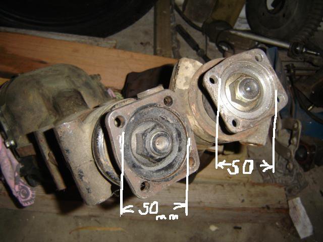

Something else to be aware of. The R180, and R200s I have that were from 260Z/280Zs have a 50mm recess in the diff flange to match the drive shaft flange on the uni. I only have this pic of 2 spare diffs(R180 on the left, R200 on the right, sorry don't have a driveshaft pic.)50mm recess indicated. the diff flange from a Z31 has a different size recess,the flange is larger,the one I measured was 58mm (don't know about the 280ZX) Make sure you get the correct matching driveshaft uni end when you find a diff.
