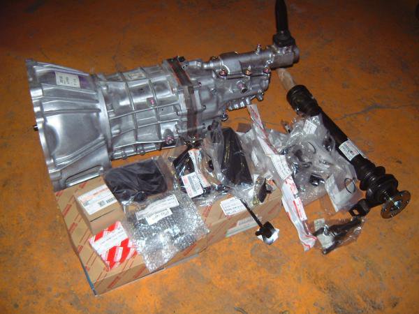

There is a variant of the R154 box, longer rear, that puts the shifter further back, it is from the JDM JXZ100 Chaser,(1JZ Vvt,206Kw @6200,378Nm@2400,factory single turbo) could also have been in the non Vvt JZX90,not sure Bad news is it is not easy to find, -

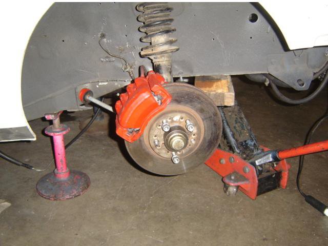

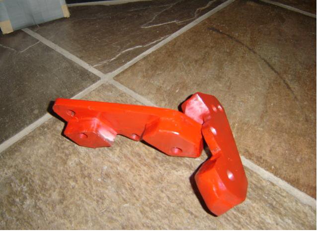

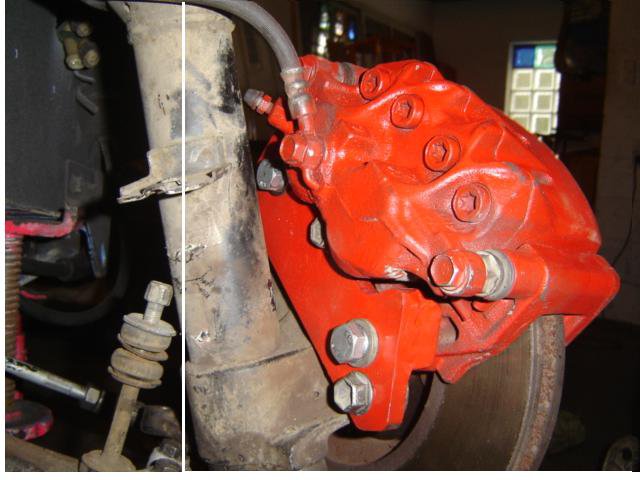

Only just noticed your post,Brakes were from NA As someone has said there are better options,but like you, had a set sitting there,so used them. Couple of pic's, the bracket, I am going to have to redo this, as when the pads wear down the bleed nipple will eventually contact the strut.(getting close now) Discs needed small amount taken out of center to fit hubs.(Billet hubs, so no point in giving you measurments) with the Supra M/S ,280ZX booster, brilliant stopping, Will only take a little thinking to set up, work out spacer, and you will have big cheap brakes (Still need to lower front, and get the wheel back a little from guard/dam) -

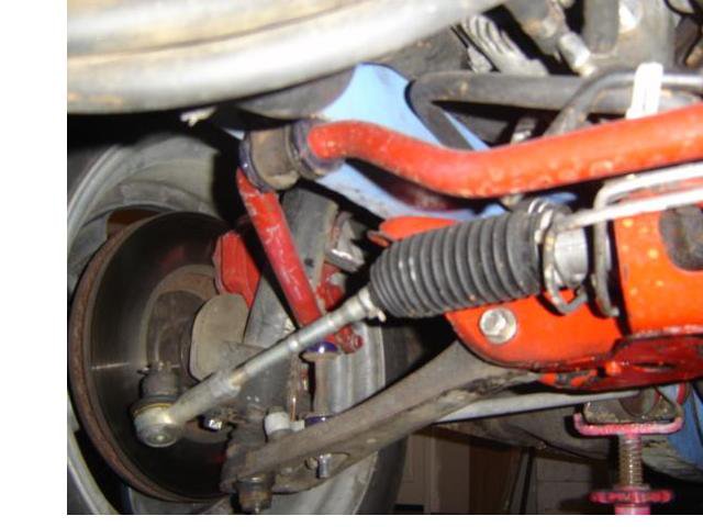

There is a Subaru rack I am chasing down at the moment, When hooked up through a control, only needs a couple of resistors to give" light" for city driving, flick a switch and it "heavies up "for the highway, Only really need the two "feels" , but through a speed sensor would probably even it out. What I have done , as the car is a cruiser, I live in the inner (inner!) city(Sydney)works great, but to the unprepared,(This has happened) with 2 turns lock to lock, it's quite easy to move the wheel an inch, and instead of overtaking, be up someones driveway on the other side of the road! It is POWER power steering!I love it, my friend ,who will never drive it again, will recover in time.(nerves that shot,shoud not be driving! ) Zgeezer, if I had read that long version before I went power- I wouldn't have! It is easier than that. -
subaru rack s30 inner tie rods long
RUSSJZ-ZED replied to zgeezer's topic in Brakes, Wheels, Suspension and Chassis
the rack I used was from a 1999-2003 subaru Liberty(Japanese assembled), 2 turns lock to lock, good feel, not too light, great for city driving,but gets a bit frisky over 110 mph(185KPH) -

that was my post, Before you rush in, check out what racks were utillised in US. In Australia two different racks were used(australian made,and Japanese) racks were quite different to each other( and right hand drive as well)I used the Australian made one which had a tie rod end about two inches shorter than the Japanese ones. Japanese ones were to long, not enough thick area on tie rod to re-thread. Was not to difficult to set up, tie rods were shortened and re threaded, steering arms needed a slight reeming to match taper Tie rod ends should not be to difficult to source, all you need is reasonably short,and inner thread that will match a re-threaded Subaru tie rod, -

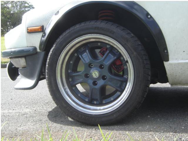

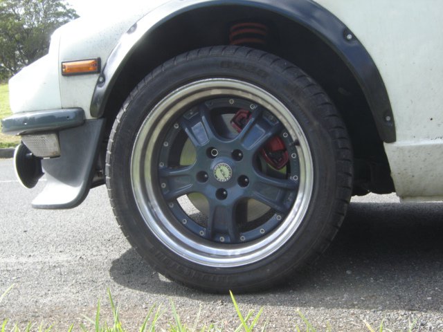

Massaging, or cutting are not options, I have a Zenon front dam and any "tweeking" of the guard will have to follow into the dam, right on the junction of the guard and dam is the problem point. The rear edge is the thickest part of the Zenon, it would deform at speed with the edge cut back. Think smaller diameter tyres may be the way to go, don't need much, only touching on left wheel on full R/H lock.Pic of wheel in straight ahead position in my gallery on classicz.com(same user name)
The offset is all wrong, the Z32s will not clear a standard spring, tried to put one on the rear of mine to reduce track, will not come close to a fit.(I run a nissan PCD 5 lug)
I have a problem with the tyres (just)catching on the outer edge of the rubber (and bending) the bottom of the front guard when on lock. -17 X8 inch wheels, 235X45 rubber, The control arm rubbers are about to be replaced with urethane,will the new urethane bring the arms back in line(if this is problem,original 30+year old bushes) or do any problems arise if I reverse the bushes and put the longer bush side to the front, to create the small clearance I need?

Pic's, I have never been able to post a pic on this site, always a problem. I have posted them in my gallery on classiczcars.com same user name. Pic of M/S and booster shows the spacer,I did not use this, just cut the studs off to same length as on 260/280Z booster- easier to adjust clevis. slight resetting of pushrod into M/S(2 minutes,plus another two to readjust clevis on pedal end.all that is required, two new pipes cost $15 at local Hydraulic shop)) This is M/s of a car that did not have ABS, the ABS M/s has a third fluid pipe, don't know if just blanking it will work. The two piston calipers were also on the TT cars until about mid 1994( someone correct if wrong) then they went to 4 pots.( This 2 pot setup also on the Chaser turbo, which was a Japanese market only car.) 2 pots were ok unless you were into big power. They bolted to same brackets so if I come across a set might give them a run.
