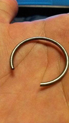

Hi everyone, recently I had to rebuild my 87 300zx turbo Z31t shafts for my 240z ; however, on one of the shafts one of the little metal C looking clip/lock/retainer broke into pieces as i took the shaft apart. The C looking metal retainer is the metal piece that goes on the actual middle shaft that must be pressed or "compressed" with a flat head or some sort in order to RE-assemble the cv's just making this thread since im searching for the specific name for these so i can search online, or in case anyone has some spares they are willing to barter with. attached is a file of what the clip looked like
il re-measure the long onee for sure definitely sounds like i got my measurement wrong on that one. putting them on for some reason was simple enough. yeah i did that i reversed the gear so the (flat) surface bottoms out on the stop shoulder of the spline i figured it would have too much play otherwise. when taking them off however to re sent them to you. it was a pain in the ass taking that bastard off. used a 2x4 on the short one and it came off with two hits, but the longer one had to be forced out with a hammer directly so i got a few hits on the shaft on the way lol. the "snap ring" that goes in the groove on the shaft ended up broken into three pieces so seems like il have to replace that.
