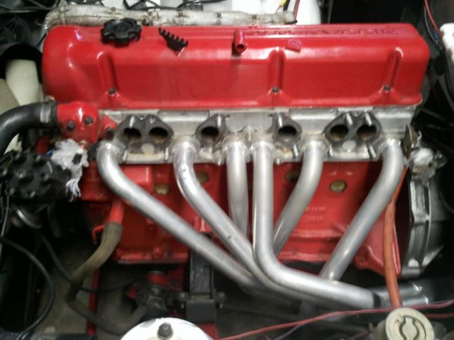

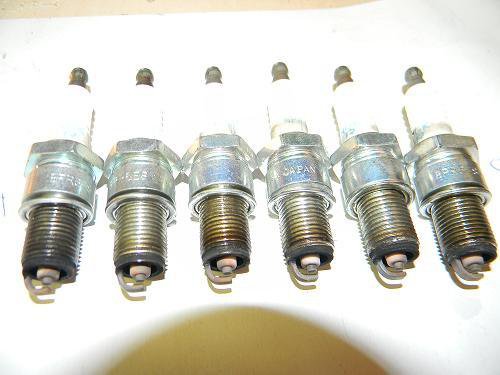

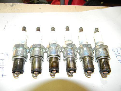

Here is a picture of the spark plugs in order from Left-front engine to right-back of engine. with the current setup. -
				erratic fuel air ratio readings
wickiewicked240z posted a topic in Trouble Shooting / General Engine

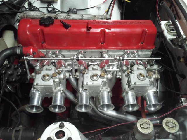

Just installed a AEM wideband I welded the bung right after the msa 6-1 header flange. I have tripple 40dcoe webers they are basically stock except for the 29mm chokes. timing at around 16*, idle is stable at 900-800 rpm. Now my air/fuel gauge at idle is not stable it jumps around between 11-14. Could a vacuum leak at the intake manifold gasket cause this. -

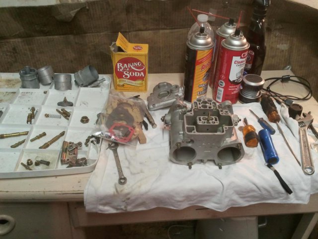

	I got my webers rebuilt kit from italy on monday. Today I finished soda blasting one of the carbs since Im going to rebuild them one at a time so I won't loose parts.

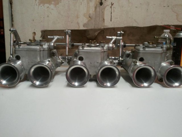

				40 DCOE throttle linkage length
wickiewicked240z replied to wickiewicked240z's topic in Miscellaneous Tech

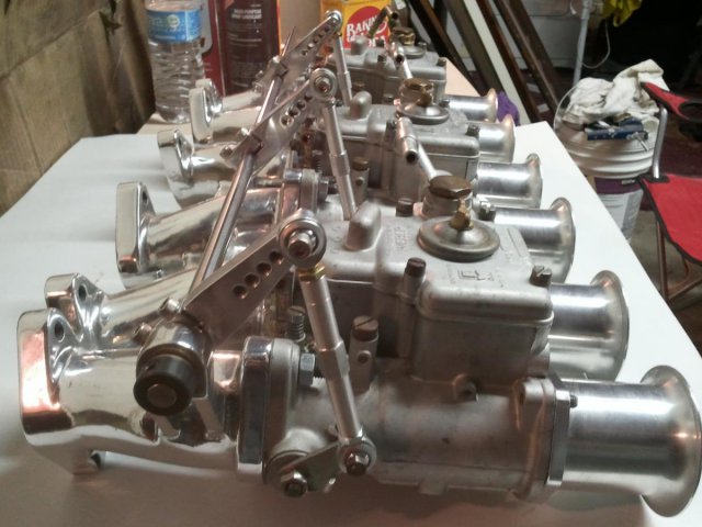

I know everyones setup is different. Just wanted a general measurement since I'm making my own linkage. And needed to get the right length rod. -
	Does anyone know the length of the linkage for the triple weber DCOE. There are 3 adjustable linkages. From center hole of one heim to the other. thank you
