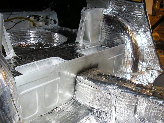

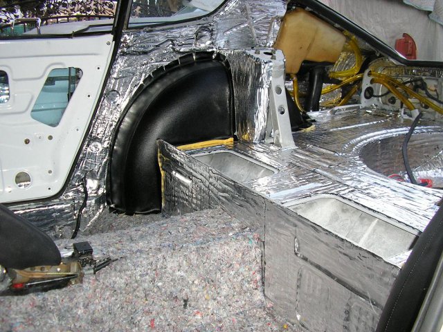

	finally finished my speakers box for 2-6x9 and 8" woofer all in the same box but each has its own chamber, I also installed some HID's H4 High/Low kit.

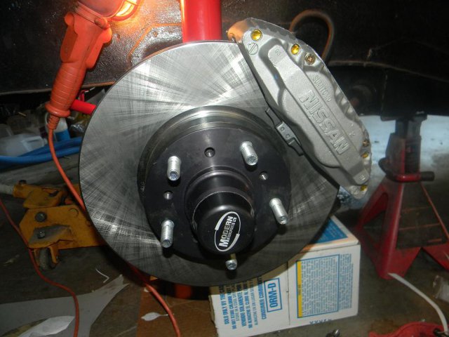

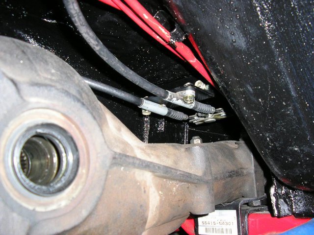

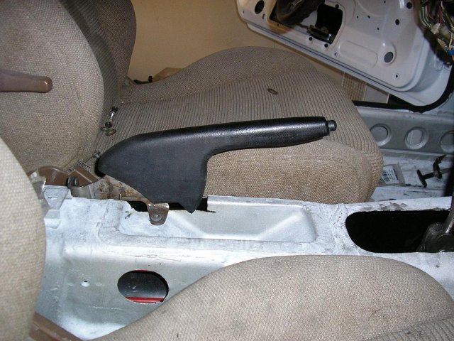

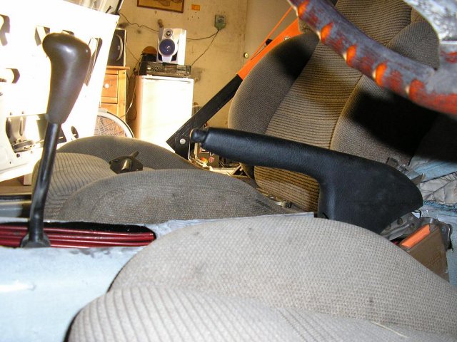

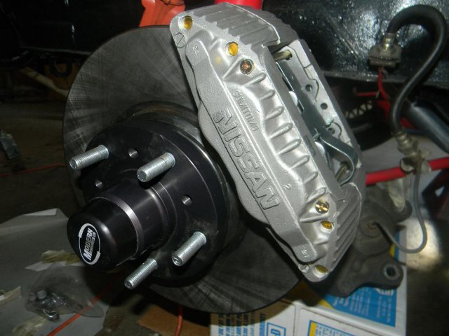

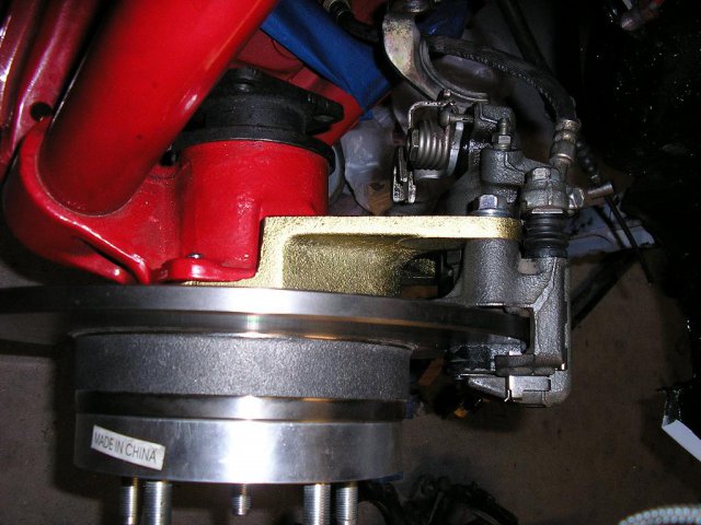

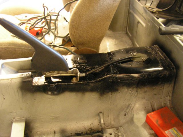

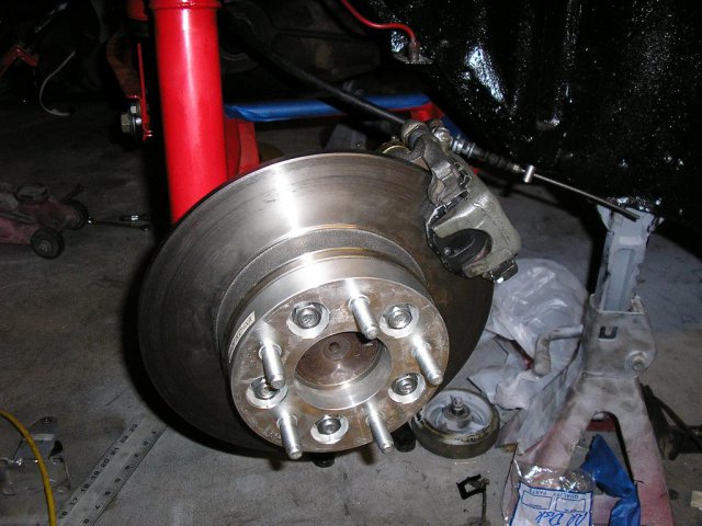

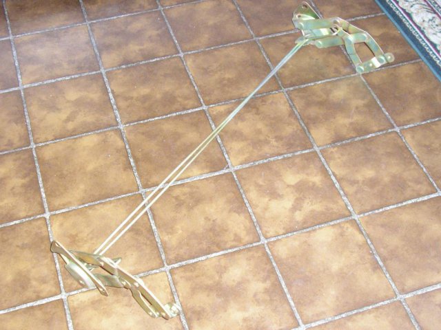

I wanted something different so I installed a 240sx emergency hand brake, and I'm using modern motorsport bracket with 240sx rear brakes. I also upgraded to a 280z brake booster. -

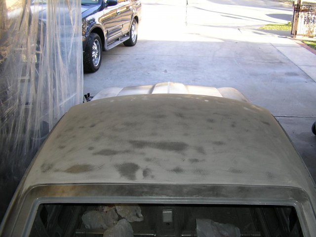

wickiewicked240z replied to wickiewicked240z's topic in S30 Series - 240z, 260z, 280z

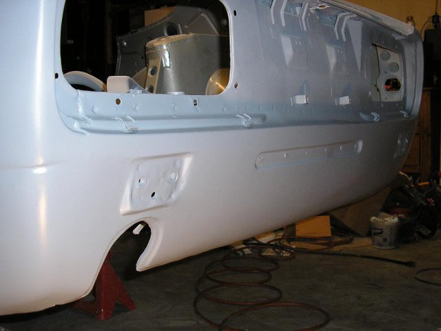

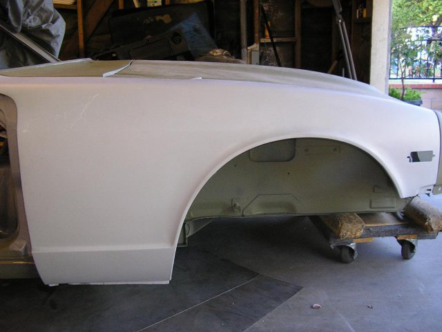

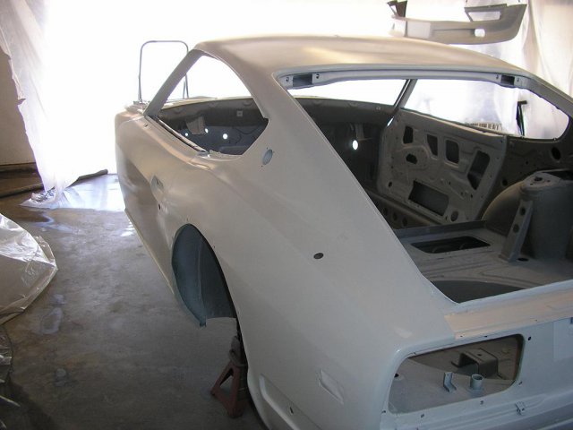

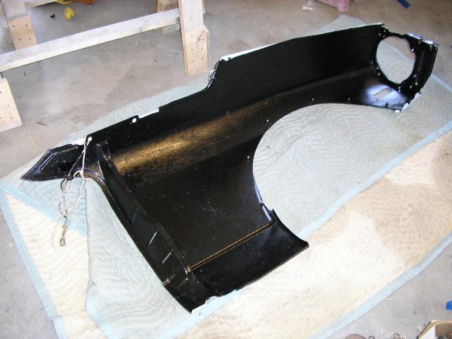

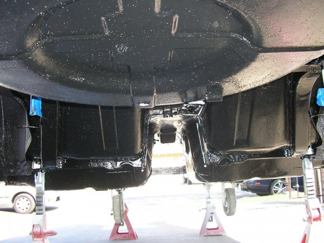

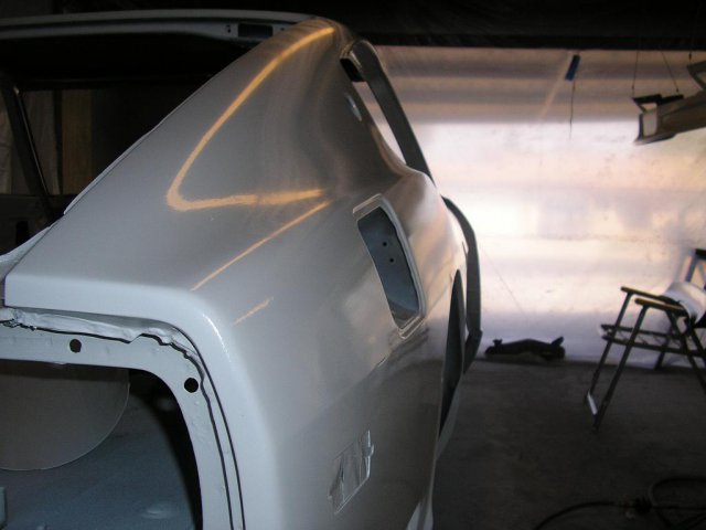

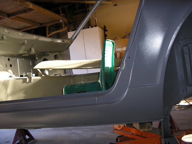

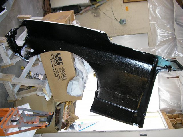

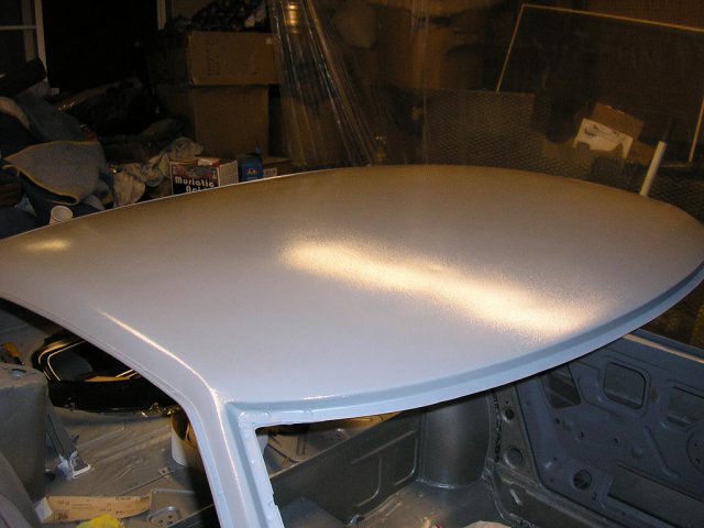

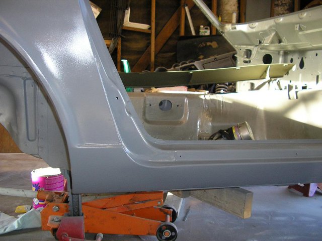

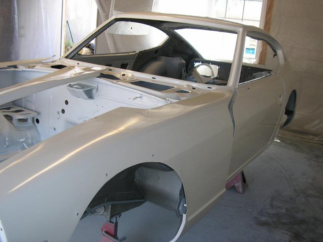

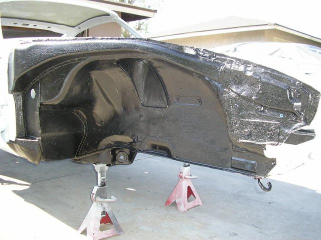

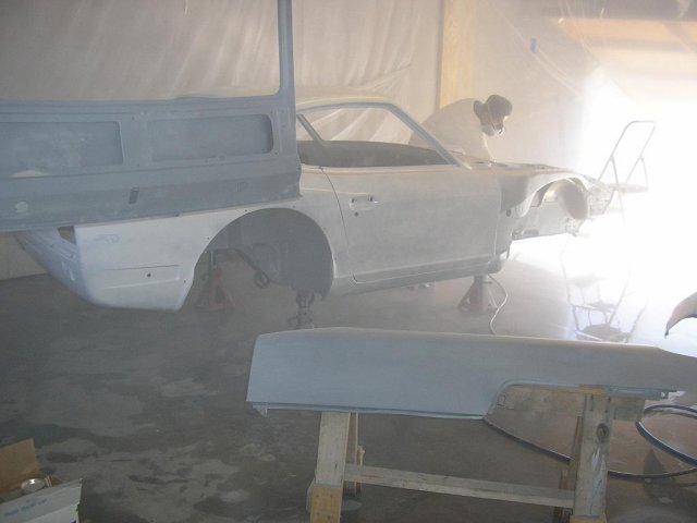

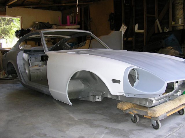

Car being painted I used PPG Arctic White Its a chevy color. The guy charged me $300 to paint it in my garage. I painted under the car with black undercoating to protect it from rust this includes the fenders and everything I think water is gonna be touching. -

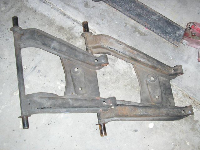

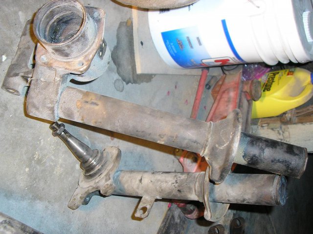

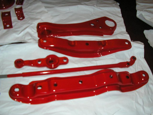

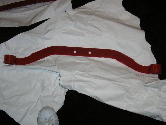

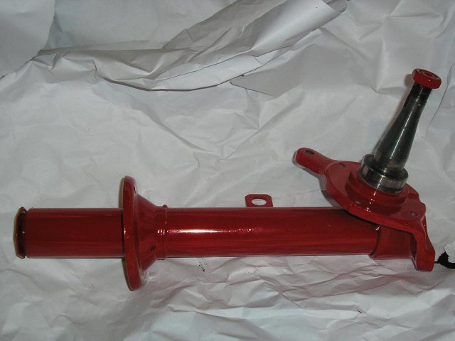

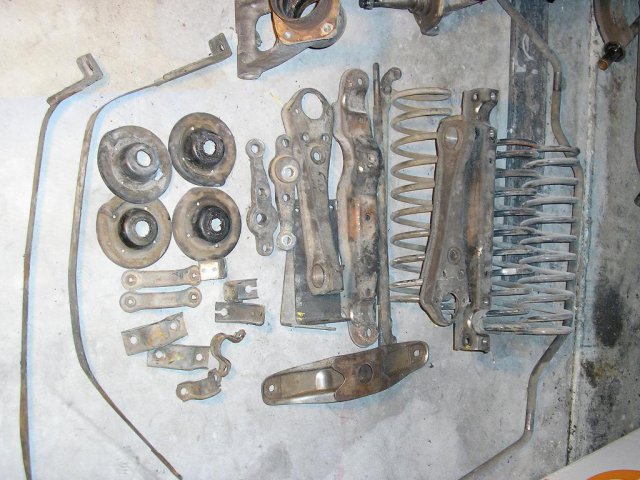

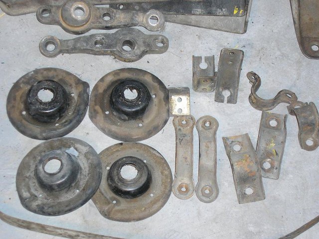

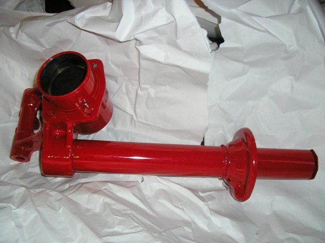

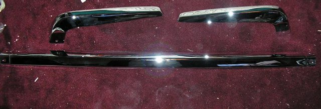

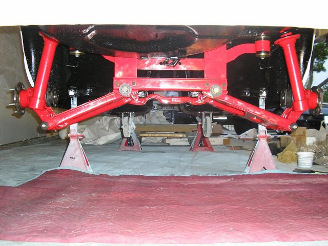

Here's a few goodies. I had the front and rear bumper rechromed straighten and all the rubber taken off and holes welded for a clean look. $250 for each bumper I also had some stuff plated or anodized don't know the correct term. Had the suspension sandblasted and powder coated cause I wanted to last for awhile and don't want rust plus it stand out more. -

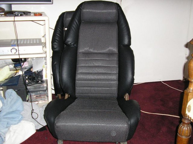

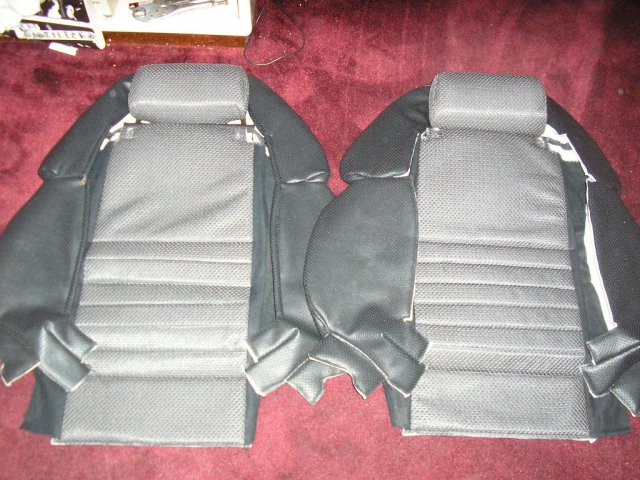

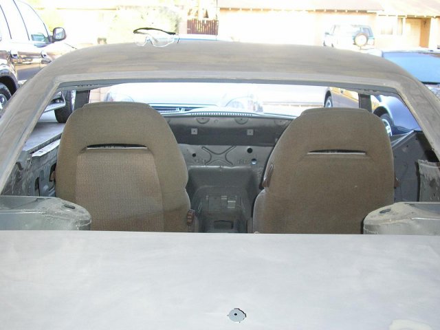

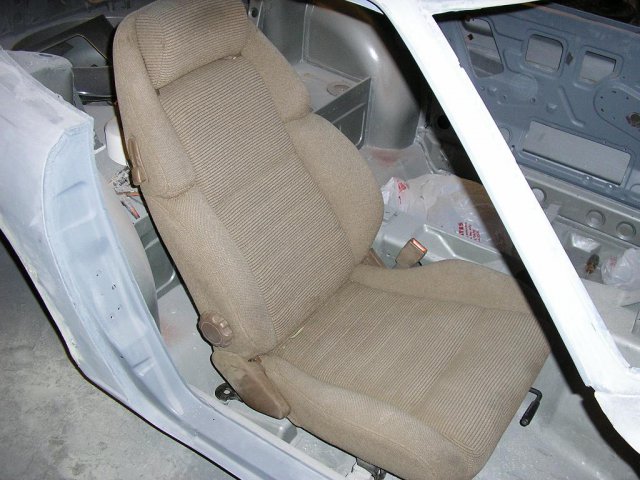

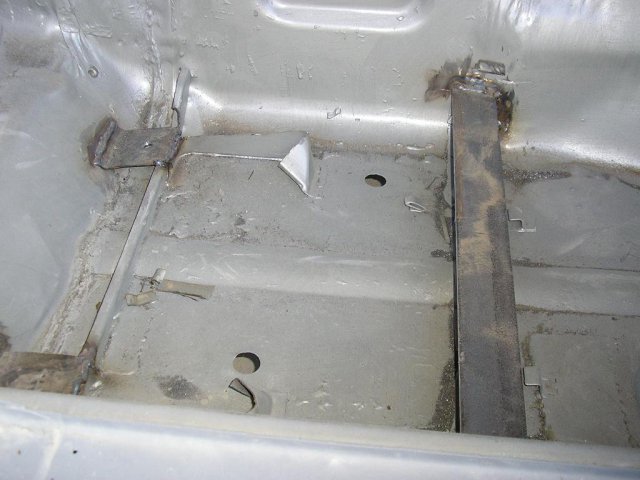

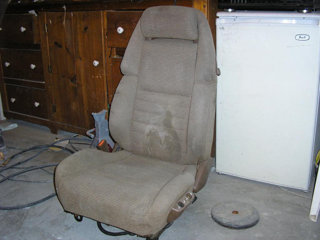

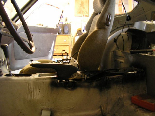

I bought some z32 seats I got them cause they are way more comfortable than the originals plus I like the way they hug you. I had to make brackets to bolt them up to the floor cause If I would of use the stock ones it would have been to high plus I wanted full function of the power seat mechanism. The last 4 pics the seats are bolted to the brackets in their final position. -

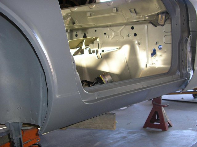

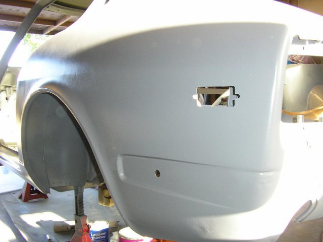

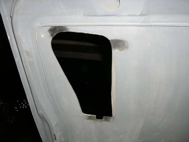

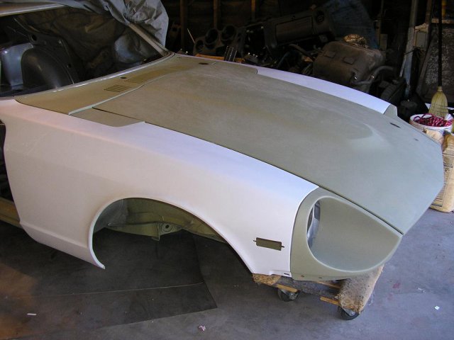

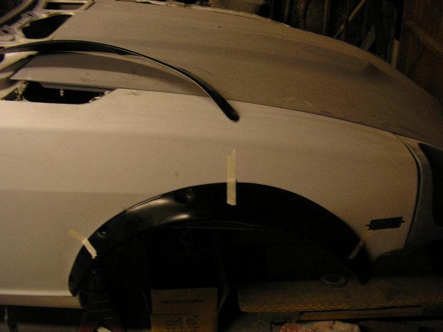

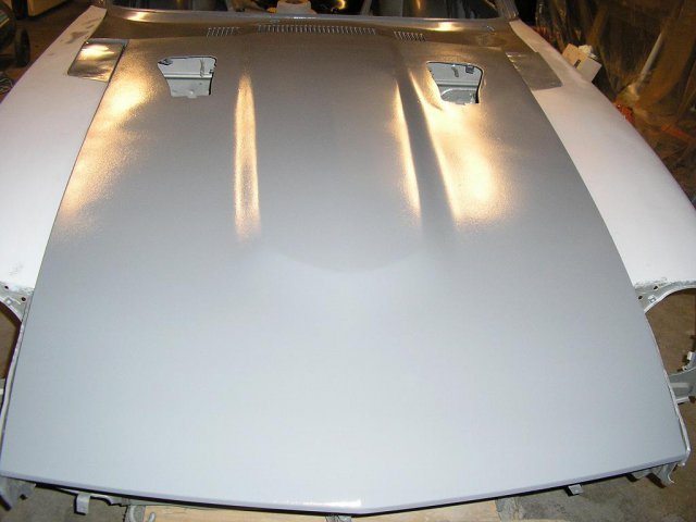

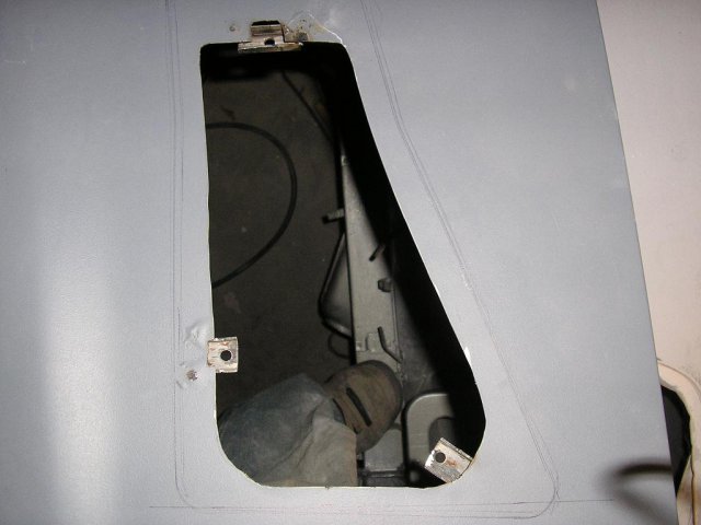

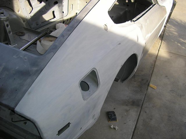

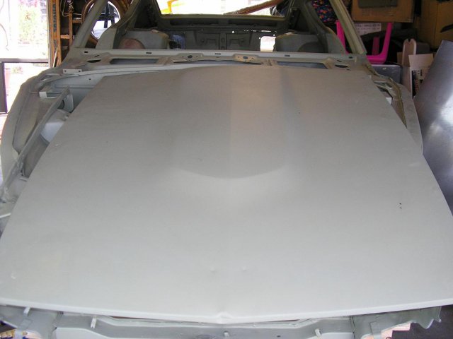

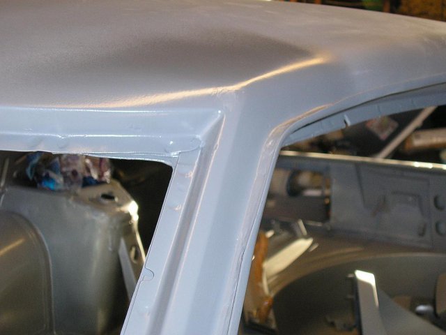

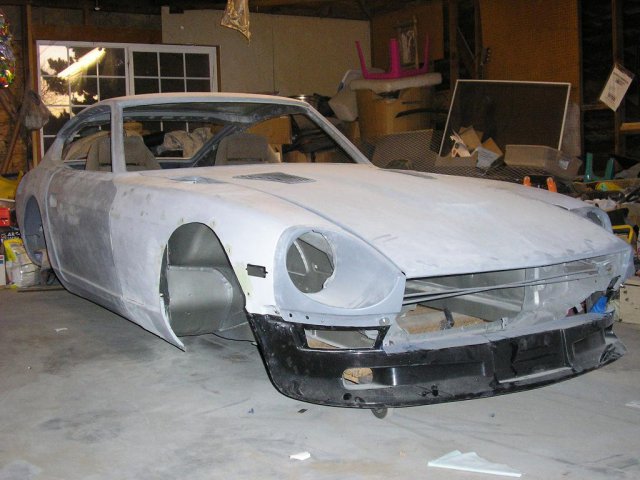

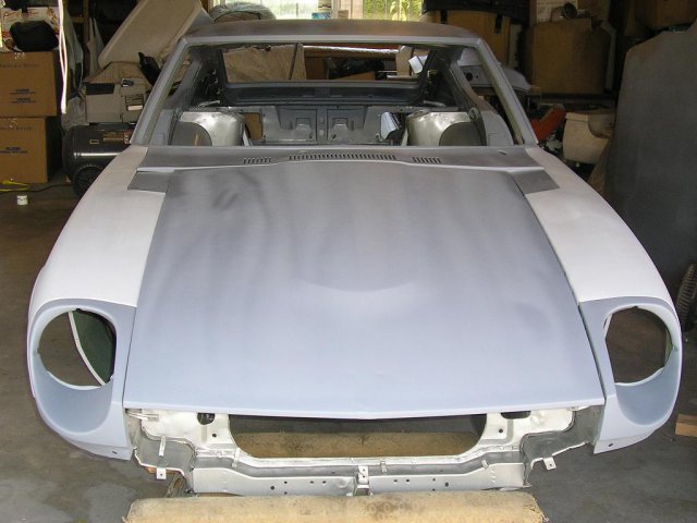

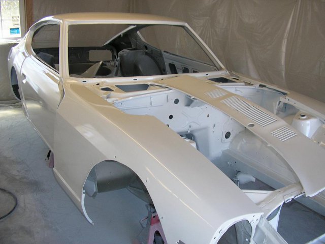

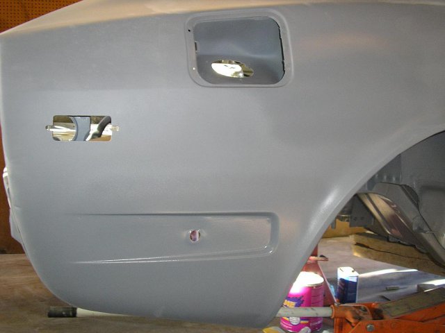

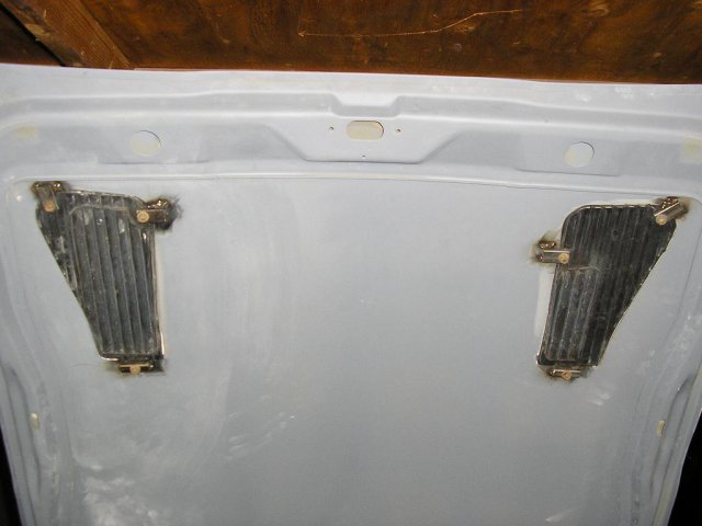

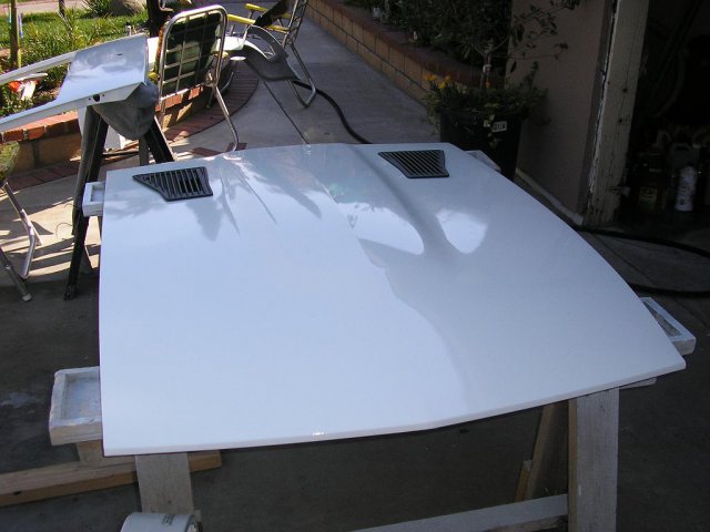

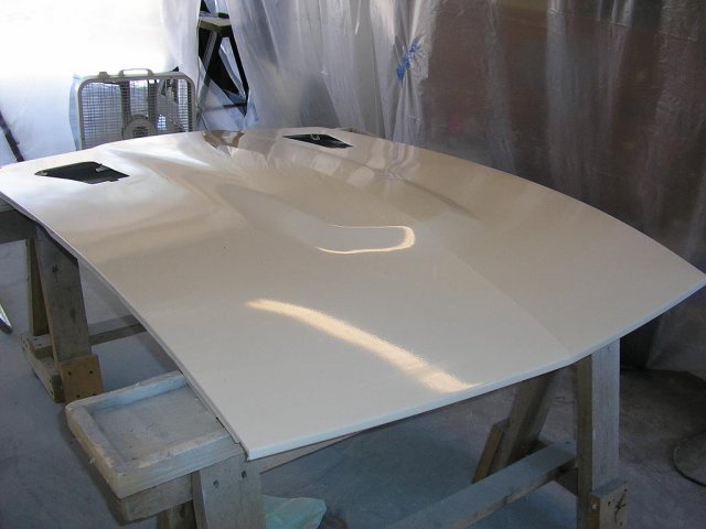

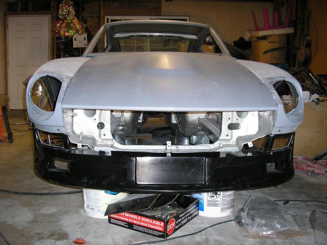

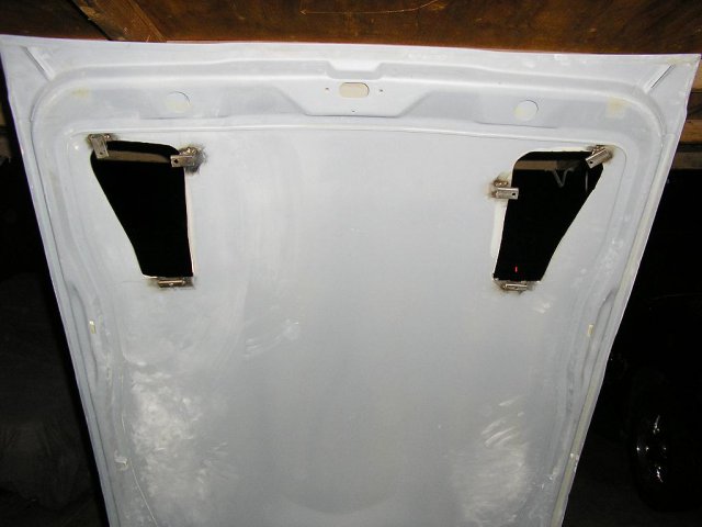

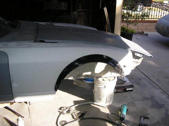

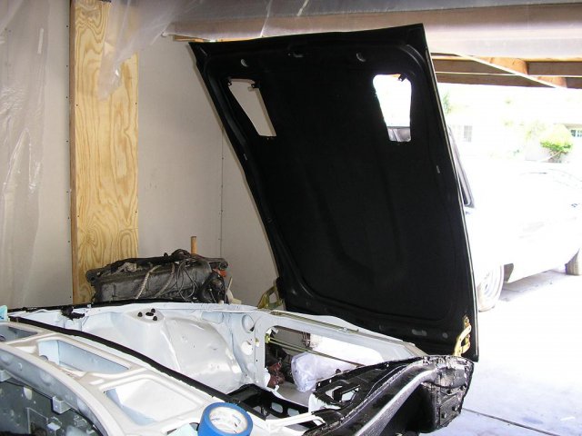

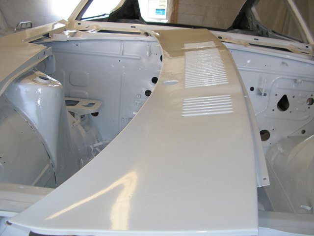

I did some modifications to the hood using 280z hood vents. I blocked the car and sprayed it with expoy primer again. -

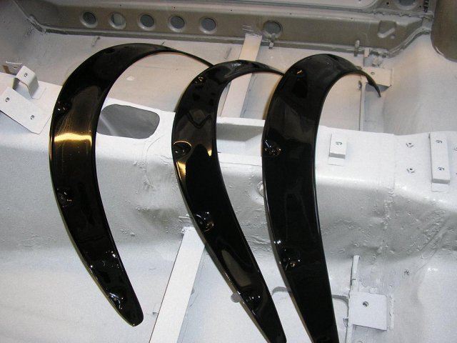

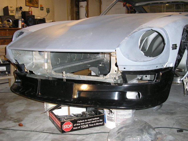

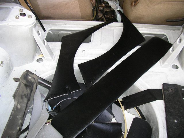

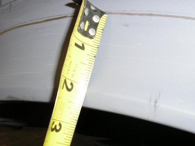

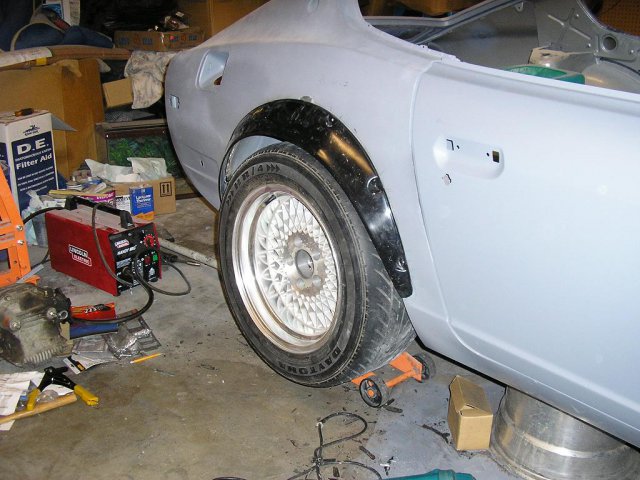

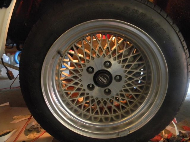

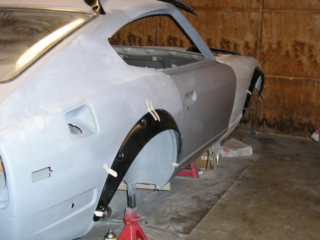

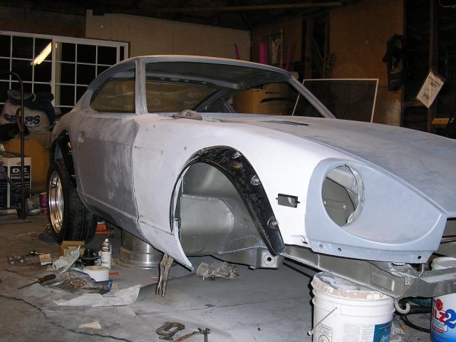

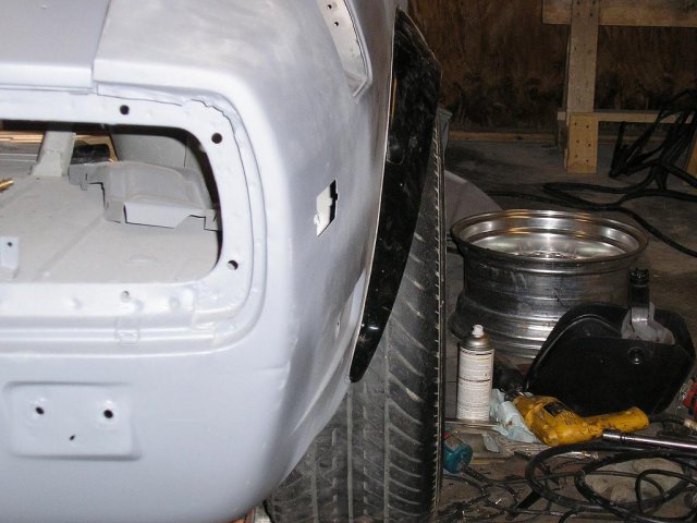

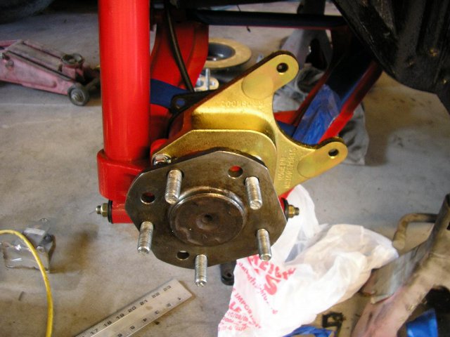

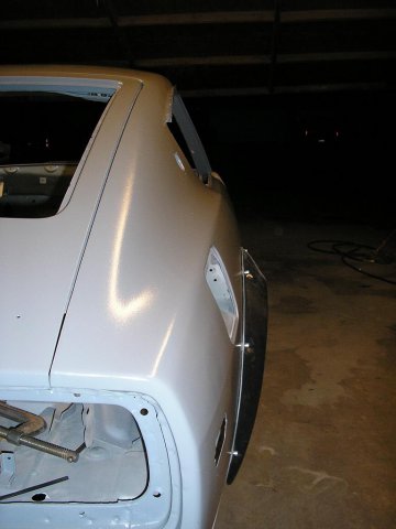

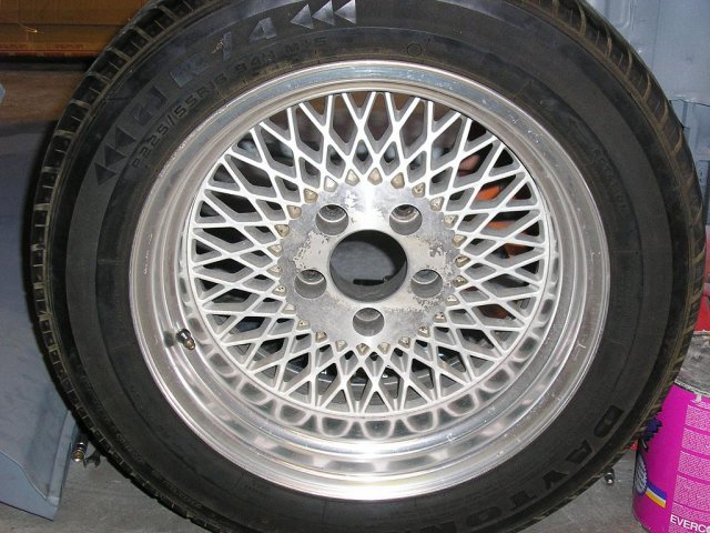

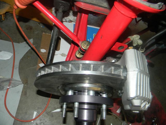

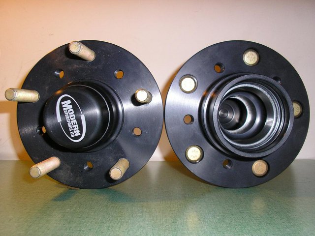

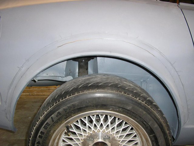

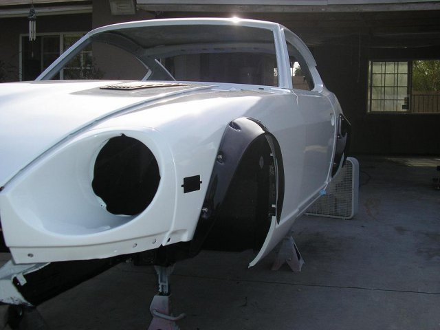

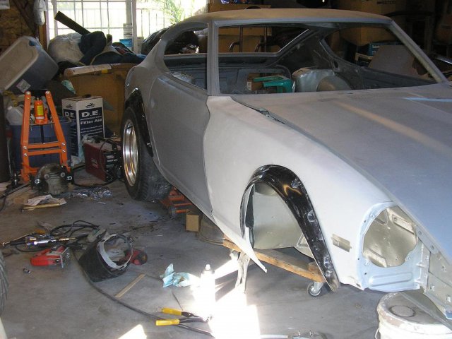

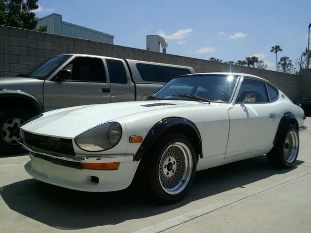

I installed fiberglas ZG flares, I also did the 5x114 to 5x4.75 upgrade by drilling new holes on the stub axles and using billet adapter to get the 5x4.75 bolt pattern. Using Enkei 92's 16x 8 with a 5x4.75 bold pattern i think they are -10 or -20 offset I forgot but they have a nice lip which is awesome. -

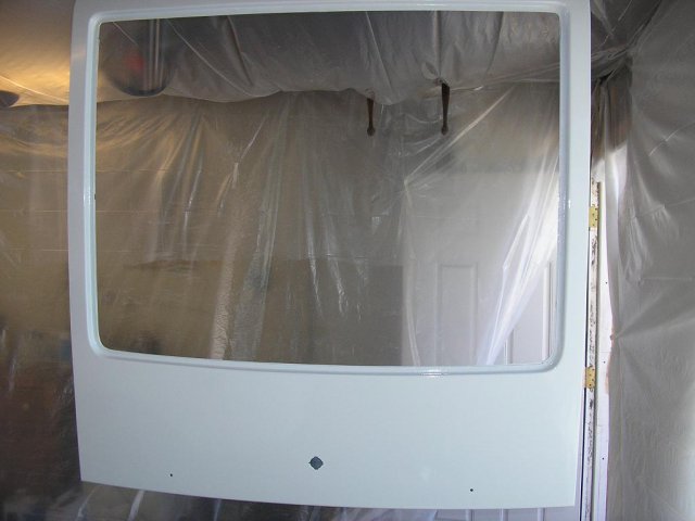

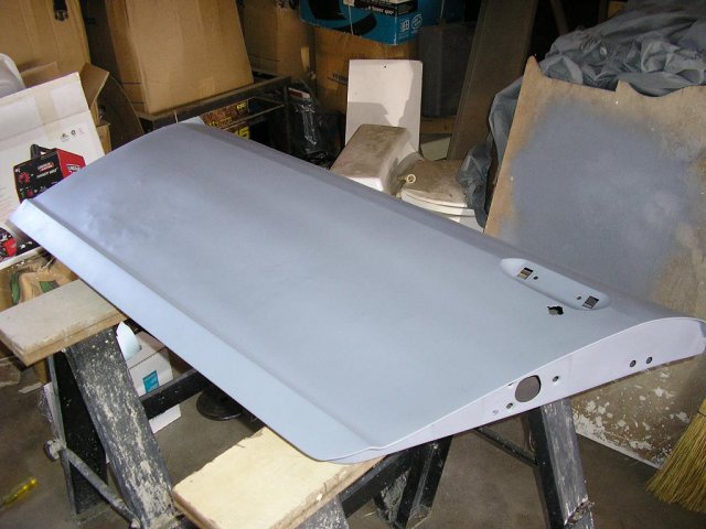

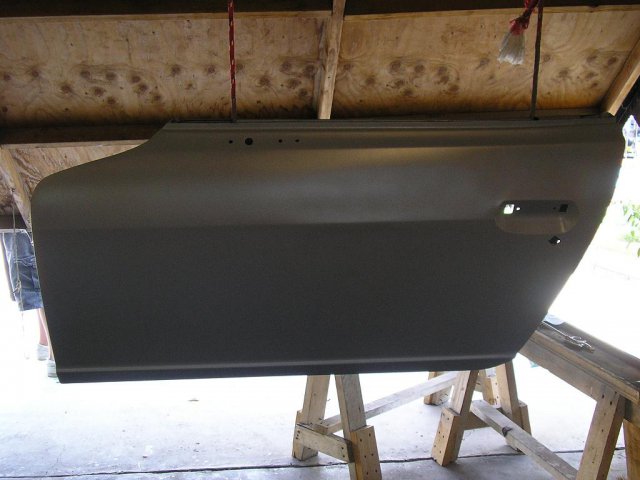

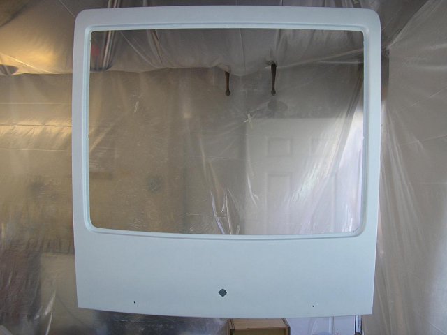

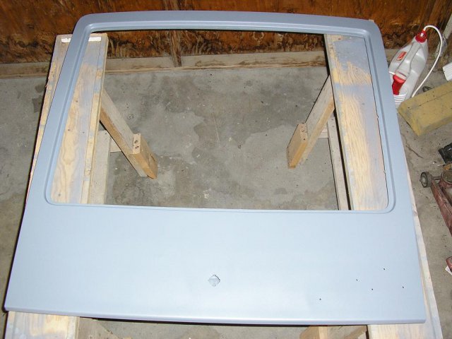

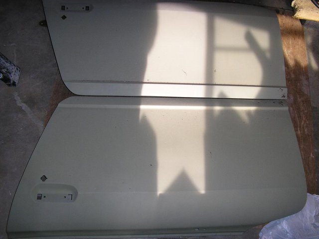

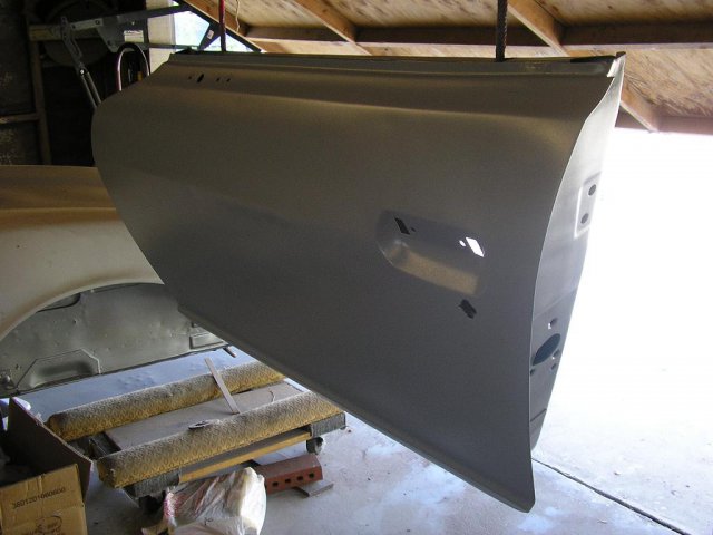

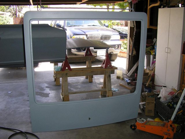

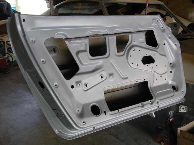

I had to get a new hatch and doors cause the originals were way to wavy and I didn't want to put to much body filler. -

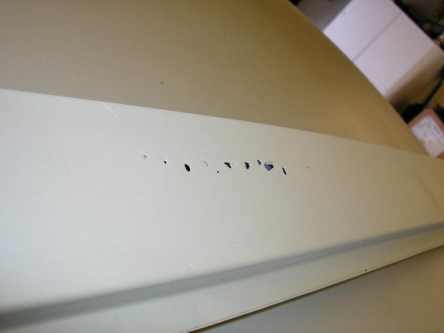

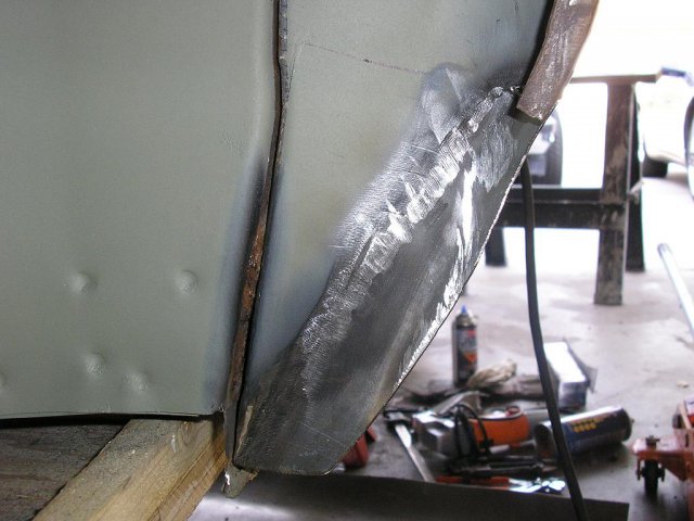

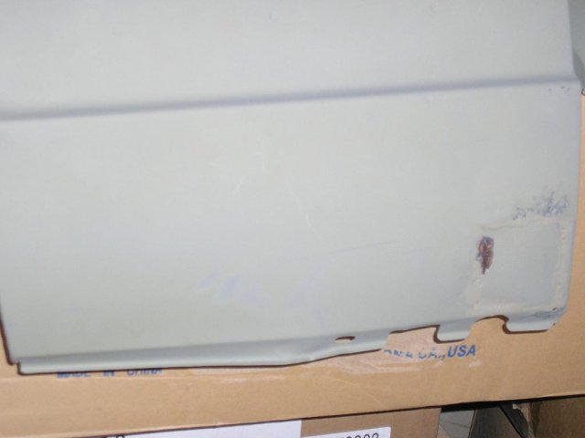

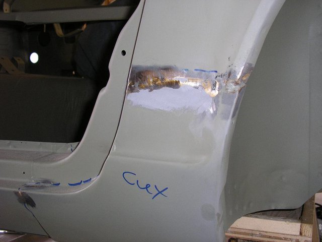

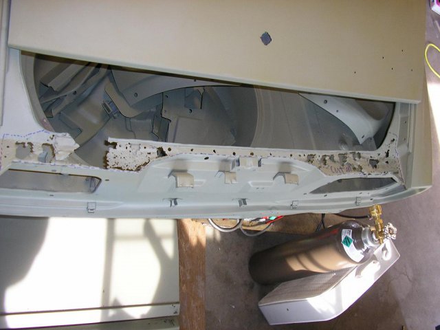

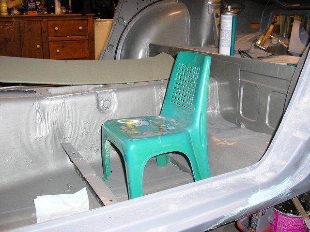

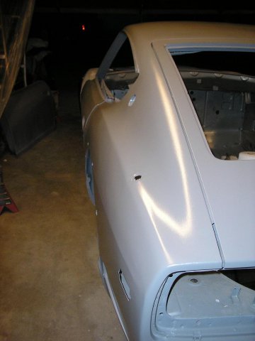

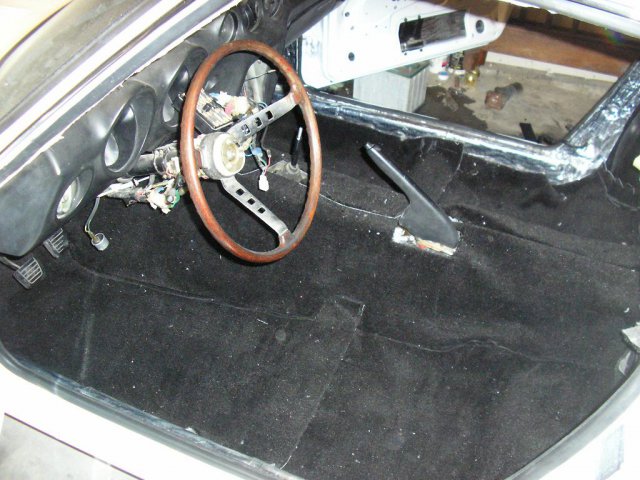

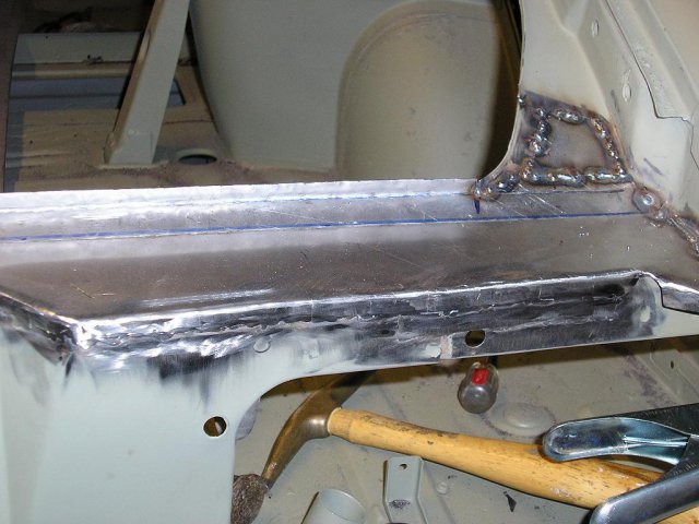

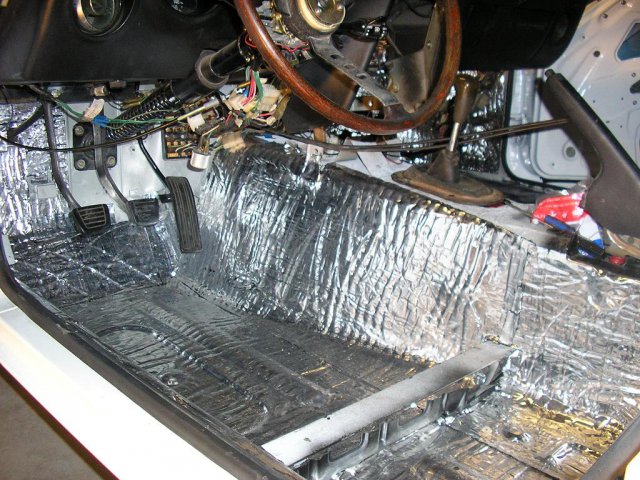

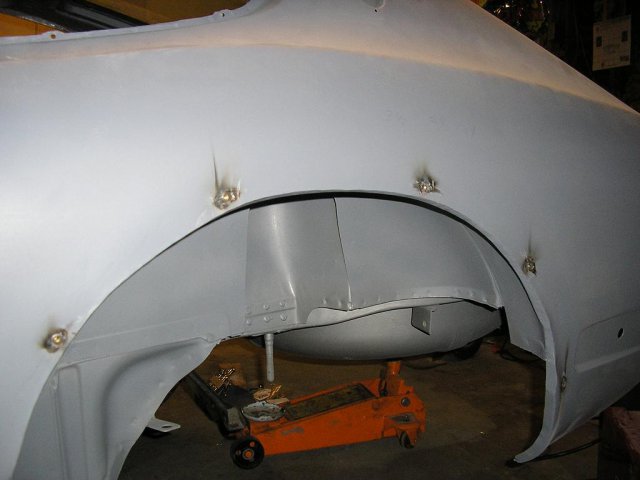

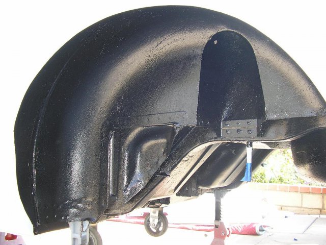

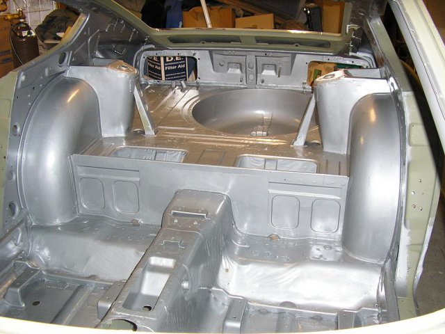

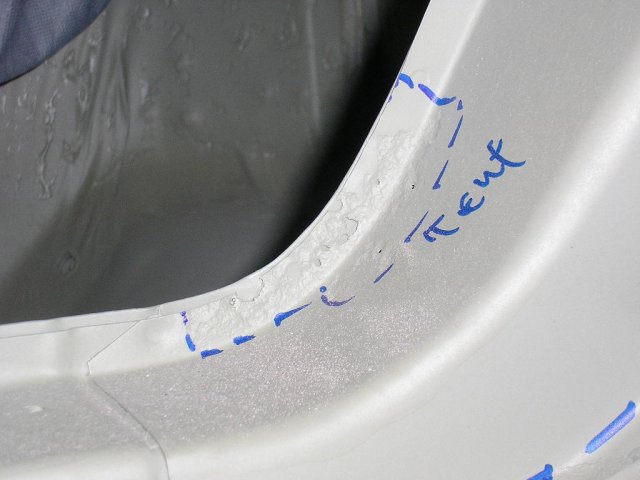

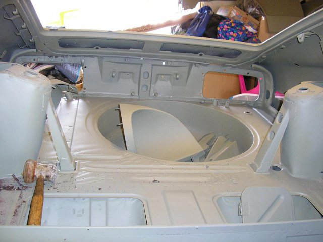

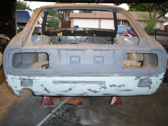

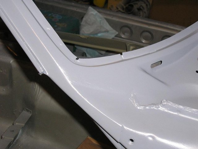

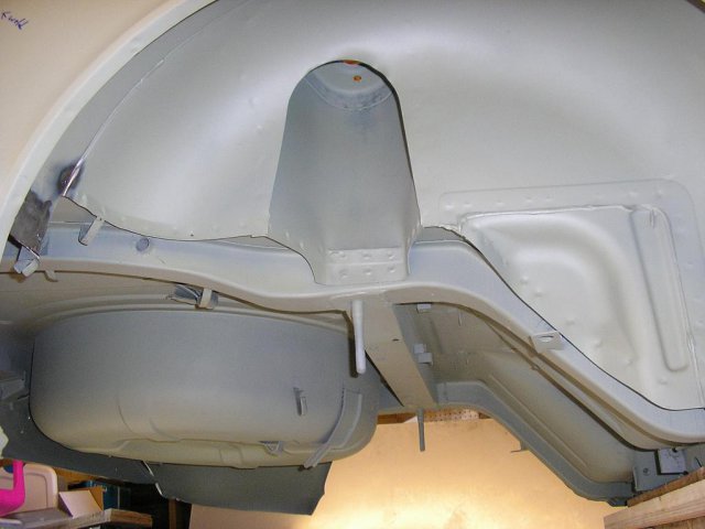

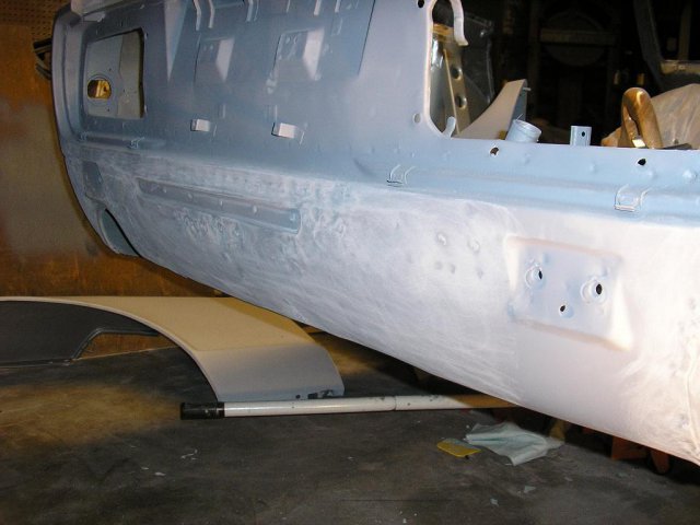

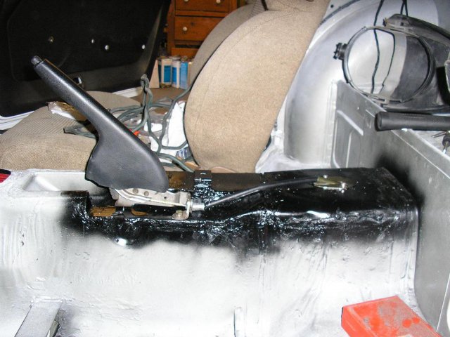

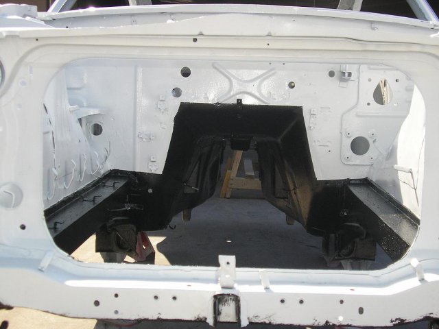

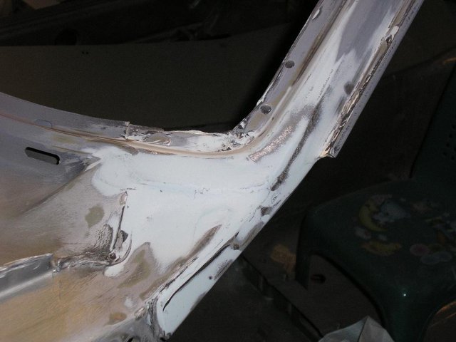

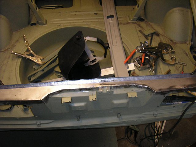

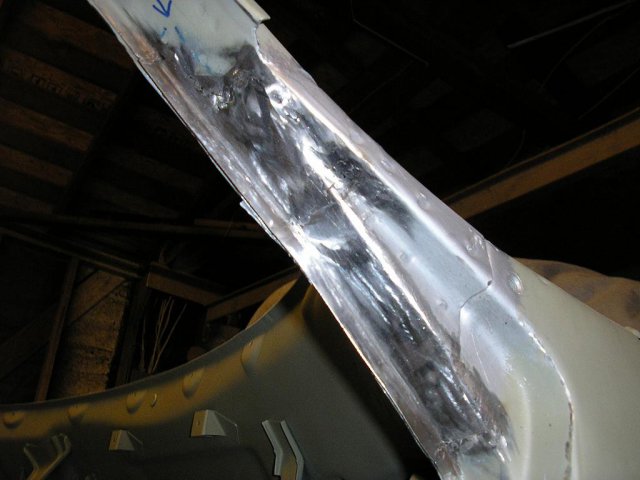

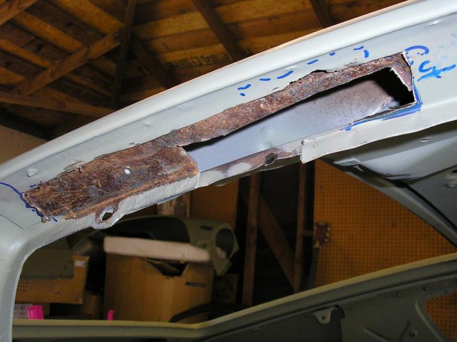

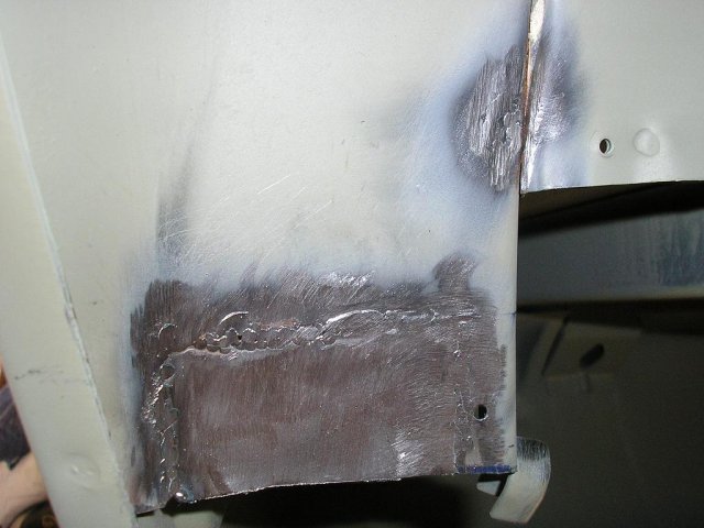

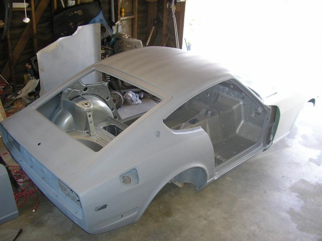

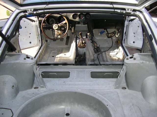

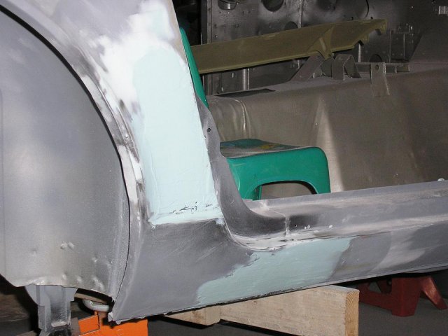

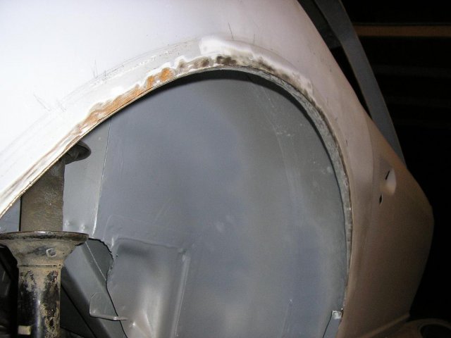

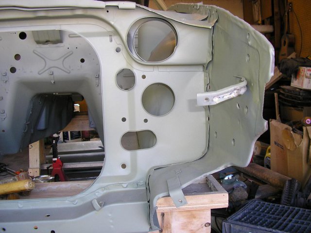

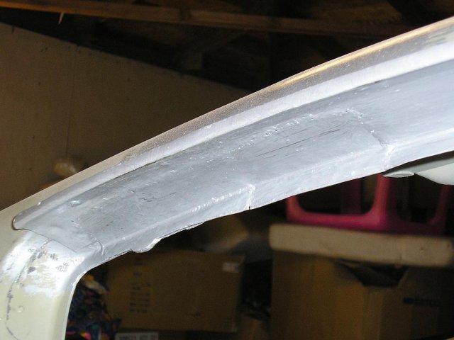

Patching up rust holes, and I used Rust Bullet on the interior n under the car to prevent rust from forming. -

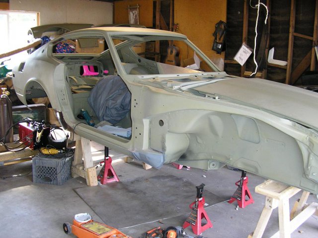

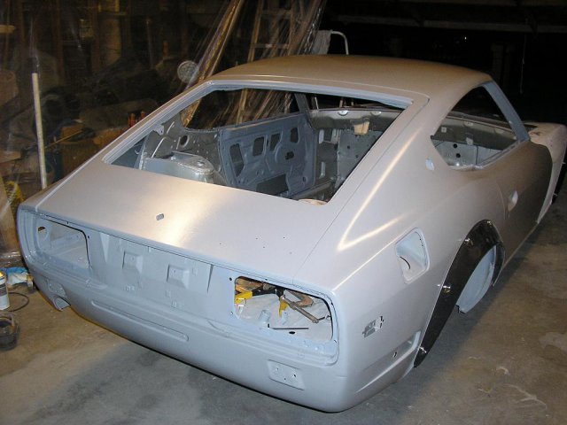

	I finally manage to get old pics from my old computer. This is the work I done for the past 6 yrs. I bought the car from an old lady in Costa Mesa,CA for $900 it was painted white. I believe she was the second owner if I remember correctly 1971 Datsun 240z
