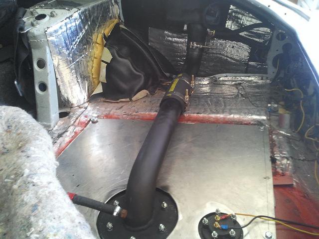

  1. I have a summit racing fuel cell I been filling it by opening the hatch but its getting annoying. So I decided to add a filler neck and use the stock filler neck of the 240z to add gas. I have attached some pictures to see if I have anything wrong that I should change. I plugged the original vent line on the fuel cell and instead I'm using the vent opening on the original 240z filler neck. That goes to a 3/8 hose with a filter at the end, and it sitting under the car behind the rear balance

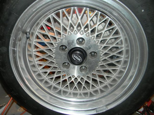

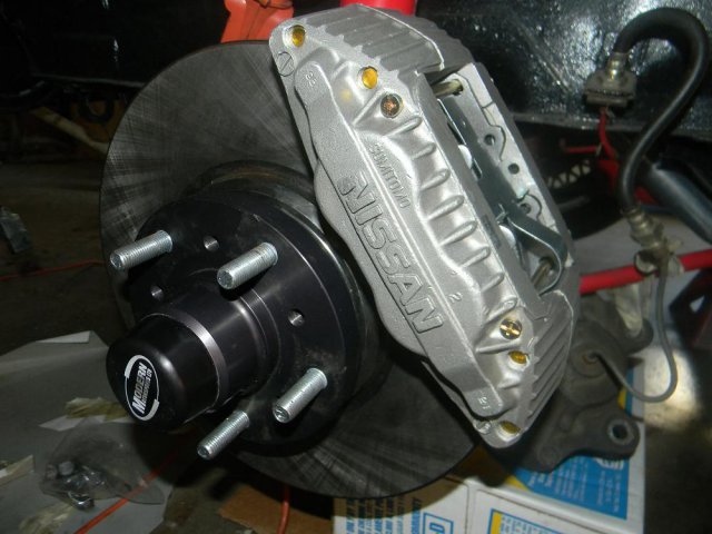

  5. I finally finished z32 brake swap on the 240z using metal brackets. I'll probably switch to aluminum later on cause it was a pain to cut it a jigsaw so I used metal.

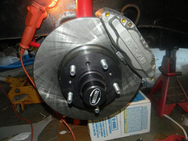

  6. Finally did the z32 caliper swap..Just need to finish the other side Used 91 z32 30mm calipers and Thunderbird 316mm X 30mm rotors
  7. Thanks... doing a 30mm z32 caliper with 316mmx30mmthunderbird rotors swap on my 240z.
  8. Does anyone know the bolt size for bolting the front brake rotor to the hub It takes 5 bolts. I know the brake caliper size are M12x1.25 Thanks.
  9. Researching rotors for a z32 caliper. Since stock rotors won't work. With a 240z setup, but I think I found the right rotor 316mm x 30mm
