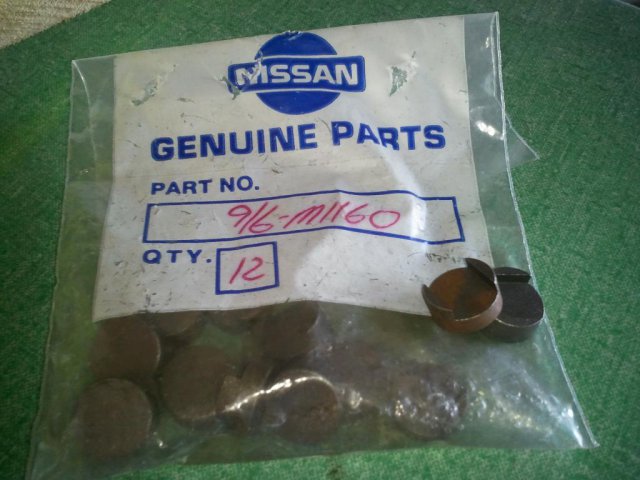

  9. Just installed a delta camshaft regrind using resurface rocker arms and .160 lash pads. Just want to make sure this wipe pattern looks good. Both rocker arms are from cylinder 1
