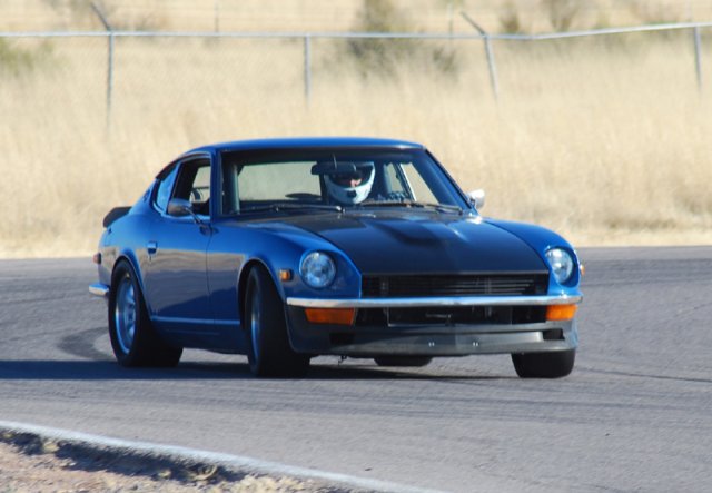

Nice numbers Jeff, I've seen your car in action many times, no doubt it's dialed in.
For comparison, my car dynoed 253 whp, 232 tq on a Mustang dyno.
Specs: 12:1 cr, 3.1 L, N42 with moderate work, Rebello "road race" cam (specs unknown), Mikuni 44s, 3" exhaust, crankfire.
So that puts me at 82 hp/liter and you at 96 hp/liter.
I've been told by several people that Mustang numbers are consistently lower than Dynojets. There is a Dynojet nearby, so I think the next step is to take a few pulls there and compare them.
