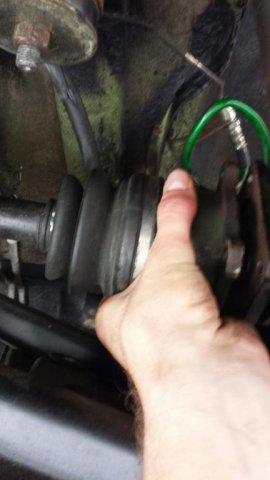

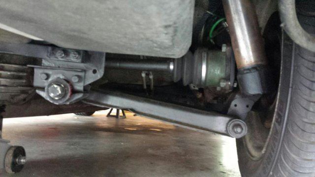

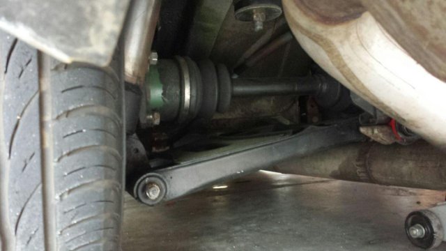

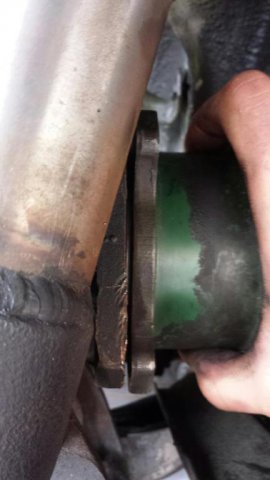

  1. Sorry for the long delay guys but I've been out of town. I was able to get under the car and get some pictures to see if I am having any fitment issues. The attached images show the space between my CV adapter and my axle cup. The image that has the greater gap is the passenger side and the image with the smaller gap is the driver side. Keep in mind I have the axle firmly pressed in towards the diff when these pics were taken, the axle was NOT extended. I also attached some images of the angle of the axle on both sides. After talking with Keith it seems that the clunk at shifting I am getting may be inevitable... however the rotational clicking swooshing is still a concern. Does the placement and spaces in the pictures look average or should I still flip the cage on the driver side? Do you see any fitment issues that could be causing any odd noises. Thanks for all your input.
  2. So i took it around the block a few times today with no luck getting any good video of the sound. I did confirm a few things: The sound is only when driving straight and gets little louder when coming to a complete stop. The clunking/noise is surely coming from the driver side. It took a few rounds for the noise to get to a louder state. At this point I am thinking it may just be the cv that i did bust up. After all the Car in which all this came out of did have 190k miles and I only had the diff inspected. Tomorrow I'm going to take the cv out do some investigating and see if it has any slop. I may try to take another video but it wasn't working in my favor today. When i have it out ill flip the cages and grind 1/8" off. I will update everyone when this is complete to see if it fixes the noise. I was also going to raise the coil-overs to help with a little more down and out action coming from the axle.
