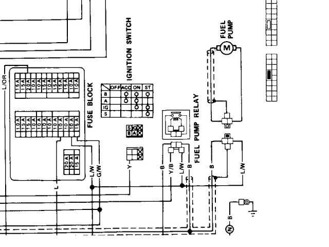

I'm still trying to figure out how the fuel pump(and all the other wiring) is connected in z31. Can someone explain me what that dashed line means? -
