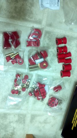

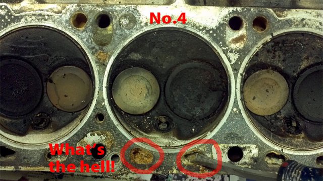

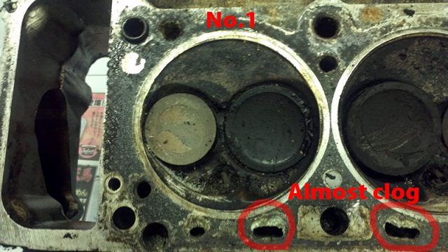

Thank for the advice. I got good advice from Blue @ ClassicZ forum too. Soak with vinegar and washed 3rd time with bottle cleaning brush. My clogged water line is now clear and flow really well. Also got energy bushing @ craigslist. Unfortunately, seller did not tell me there are several bushings are missing before I purchased Well, I can get missing bushes separately. I got nice free gift from my friend. GT25! I can't work on my car at late night after kids went to bed, but I can play with this at night with headphone

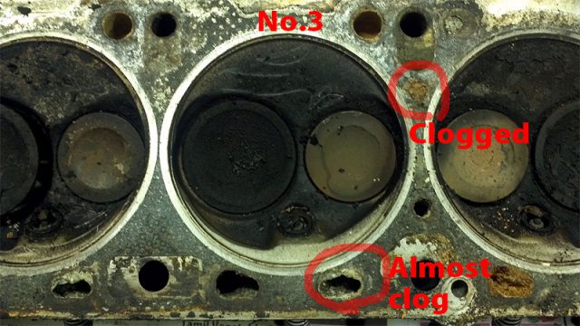

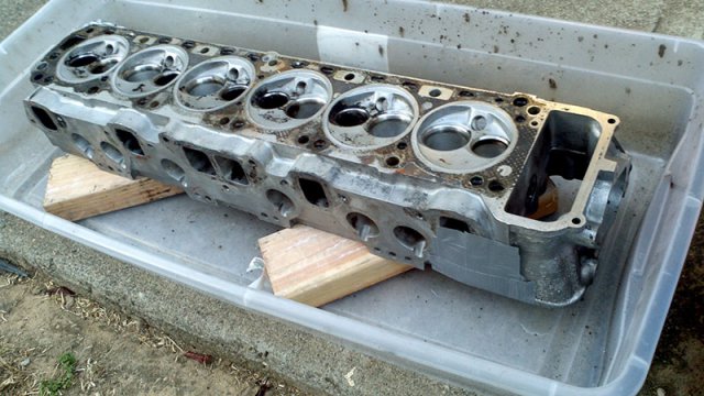

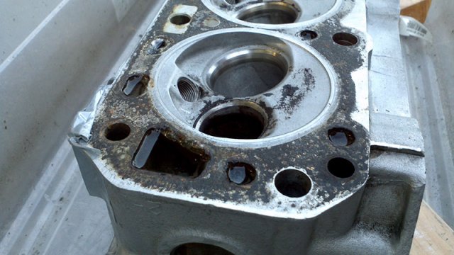

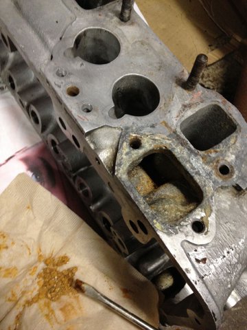

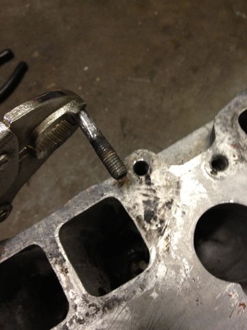

Over the weekend, I had time to wash N42 head with boiled hot water with parts washer fluid. Clogged carbon is hard to removed. I need to dip parts longer time with the liquid keep warm. I need this bucket heater to keep liquid warm. http://www.amazon.com/MARSHALLTOWN-Premier-742G-Bucket-Heater/dp/B000BDB4UG/ref=wl_it_dp_o_pC_nS_nC?ie=UTF8&colid=2QRZ54ZT313XU&coliid=IYUXNWSETECSP Anyway, stinky old oil smell is gone from my garage at least at this time. After head washed, I try to removed stud. Using heat gun to heat up stud 10 minutes, put ice cube to the stud to cooldown to creat gap between stud and head. Jaw lock plier to twist to remove the stud... some of them are easy to take it out, but others are so hard! It took more than 30 minutes to remove hard one. After flashing head and blow water by air compressor, I noticed clogged antifreeze. I don't know what is the best way to clean up this clogg. Any suggestion?

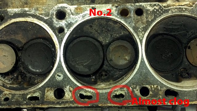

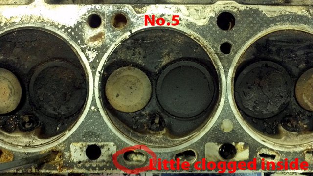

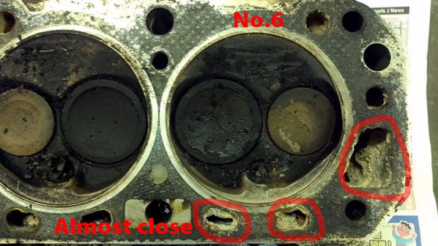

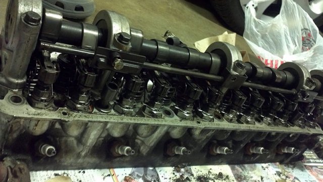

Got N42 head over the weekend @ Pink-N-Pull South San Jose. I meet really a nice guy helped me pull out this head. He has Silver '73 240z with Turbo engine in. I really appriciate great Z Community helping out each other. The N42 seems like rebuild before, it's fairly clean when looking at removing valve cover. When I flip to see combustion chamber side, I notice a lot of clogging around water line hole. Especially around no.4 water line is clogged. Last night, I had time to working on removing parts. rocker arms, retainers, valve springs. Put them individual zip-lock bag to store.
