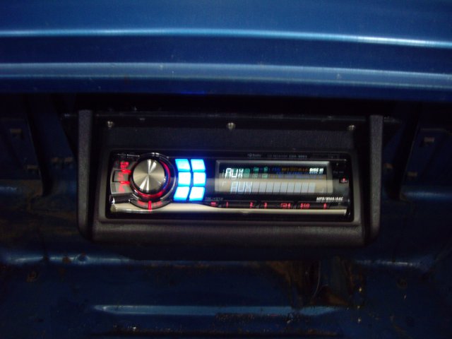

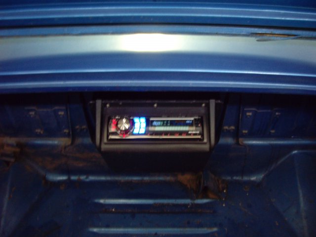

  18. Here is how I mounted mine... It is pretty basic. I bought a a stand alone enclosure for a boat and built an angled mounting bracket so the face would be past the trunk lip and I can load CDs. I only really use it as head unit for the iPod, but it will play CDs just fine.
