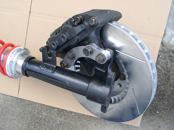

From what I have read the 240sx rear calipers have a smaller bore piston vs the 280zx version 2 calipers. Im not worried about the bias. Im trying to match the brake system up as best I can. Ideally I would be running the 300zx z32 or R33 rear calipers. See what Ive done hereNew MC replaced Pressure Regulator Valve and Pressure Differential Valve The only catch I saw with the 280zx rear calipers is that despite the larger piston diameter it runs the same small pad as the 200sx. I was going to try and make up for that with different compound pads. Currently Im running the solid toyotas up front with ceramic pads and stuck with stock drums in the rear. The bias is ridiculous. I can burn through a set of front pads in no time and the rear shoes have lasted for 25K miles...(3 sets of fronts later trying different compounds each time). The new MC seems to have helped a bit. I did not get to drive around long before my turbo went out with the new MC. I liked what I felt though. Besides, I have the ZX calipers, flat maxima bracket, and a set of rotors. Although IF someone can defiantly state that the 240sx brakes are better than the zx Id definitely consider them. Whats the piston bore size?
So Ive read through many posts here and elsewhere. Ive seen reference to Z32 30mm(rotor thickness) calipers for the front of early Z. I found pictures even. Z32 Caliper options: Non-Turbo calipers, rotors: Up to 7/90 – Aluminum, 26mm rotors 8/90 to 3/92 - Aluminum, 30mm rotors 4/92 to 1996 - Cast Iron, 30mm rotors Turbo calipers, rotors: Up to 6/92 - Aluminum, 30mm rotors 7/92 to 1996 - Cast Iron, 30mm rotors Personally Im after a Cast Iron 30mm set. Thicker Rotor for better cooling in theory. There is 1 documented Z32 swap on a Z. 260/280z front hubs milled. Rotor from Z33 also machined to fit. Just a big headache at every brake change I think. Not to mention extra time time down waiting for the modifications to be done if you dont have your own personal machine shop. I think at that point it would be easier and cheaper to go with the aftermarket kits out there. I dont have a grand to upgrade my brakes. Thats not gonna happen. Ill spend my money on rebuilt calipers, custom adapter brackets, and fresh rotors. What brackets are these and what are the rotor dimensions(diameter and offset)? z32 calipers, Z33 rotors This is my goal on the front From Rocky Auto's website but not a single specification. Seems to be based out of Japan. I want to be able to bolt everything up with the only custom part being the adapter bracket for the caliper. I have a feeling though that rotor may be from a S15 as Ive seen some reference to S15 4 lug rotors for these swaps over seas, but no pictures of S15's with 4 lug rims. I also need to dig around and see what the 4lug Ford Rotors measure out to be. Looks like Im looking for an 11" rotor. Where can I find adapter brackets for something like this? Im about to just take the whole assembly over to a friend with a CNC and say make this work. Anyone know of any other Z32 swaps and or details? For the rears Id like all the custom work to go into the bracket as well. I have a set of 200sx and 280zxt rear calipers. Im going to see how far off the offset is here in a few days with what I have. MM and MSA seem like the only places to get adapter plates. The thing that kills me though is that NO ONE is making an offset Maxima adapter plate like part # 44155-04S10 . Where can one buy an adapter bracket for the 280zx turbo rear calipers? I do not want to run any of the SX calipers with what I am doing. I do have the flat Maxima rear brake bracket. If I cannot find a custom one, Ill modify my flat bracket like in this post. Maxima Flat brackets But it will mean running the smaller piston calipers Where can I buy adapters, and what rotor options are available that DO NOT require machine work to fit. Ill take measurements for adapters if anyone has them. I would want to know what rotor matched the adapter as well.

Okay, Im trying to piece together a brake system for this car. Im not willing to spend thousands of dollars to upgrade these things. I know this is a place one should spend their money well on, but Im not full of money and I believe I can come up with a reasonable solution for less than some of the kits out there. Im ready for more braking power. I believe I need it. Master Cylinder: Im looking at a B50 or B57 MC to replace my B44 unit which works VERY well with stock rear drums and S12 non-vented Toyota calipers. Front Brakes: Nissan Z32 Cast Iron Calipers for 30mm thick rotor Rotors? nothing yet. Im looking for a 11" DIA, 30mm thickness, for 4 bolt wheel pattern, and will bolt up to the stock hub without interference. Adapters custom to match a rotor Rear Brakes: Later 280zx rear calipers later 280zx rotors Maxima flat FWD bracket with machining done as described here:REAR DISC CONVERSION Despite the MASSIVE amount of info on this forum and a few other places, I still have no solid answers. The fronts are pretty straight forward at this point. The only thing that has me stumped is in this picture that did not come with a good description where I found it. What brackets are these? z32 calipers, Z33 rotors This is my goal on the front From Rocky Auto For the rears Id like all the custom work to go into the bracket. There were a lot of swaps out there where people were turning the outer diameters or mounting surfaces on the rotors. Im sorry, but every time you have to buy a rotor you will be required to preform those mods again. Thats not acceptable in my book. I want to easily find my parts and be ready to go if I have to... I cant imagine anyone track racing would run modified rotors like that unless they had backups with them. In any case its not for me. The adapter bracket should do just that, adapt. I found that above link for the rear disc conversion to be helpful. I have a set of 200sx and 280zxt rear calipers. Im going to see how far off the offset is here in a few days with what I have. MM and MSA seem like the only places to get adapter plates. The thing that kills me though is that NO ONE is making an offset Maxima adapter plate like part # 44155-04S10 . -
