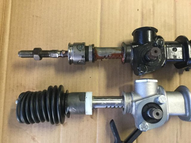

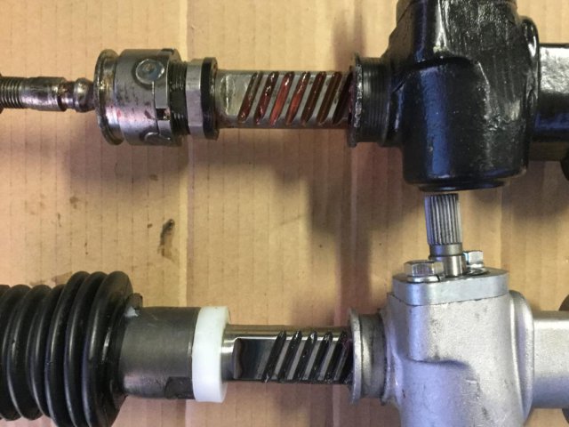

Rack installed. Feels good to me but my perspective is skewed because I have always had steering issues. So, I don't know what normal feels like, but this feels good to me. -No more feeling that the steering wheel is trying to jerk out of my hand everytime I hit any slight bump. -No more play - zero NOW, let me add this, I found an isssue while installing the new rack. Turns out where the steering shaft coupler slips onto the steering-gear box input-shaft, the bolt was not properly torqued. I put the new rack in and felt steering, it felt exactly the same as before. I thou -

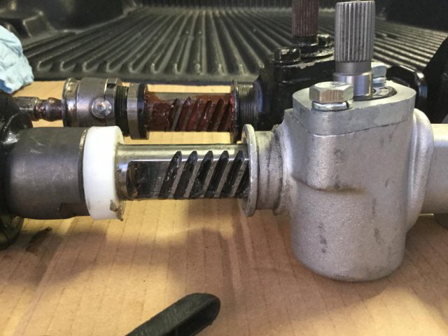

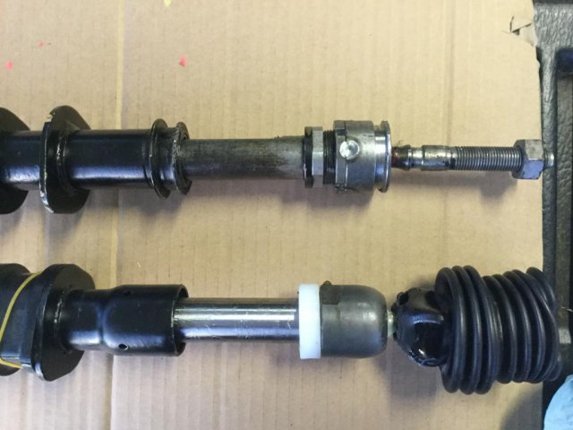

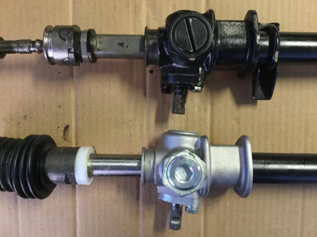

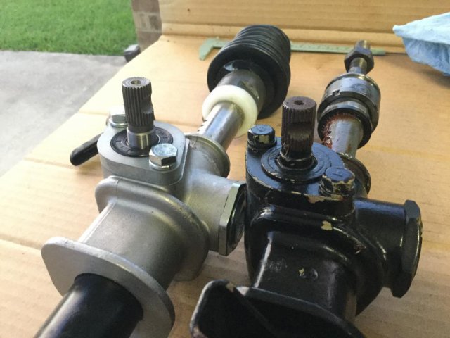

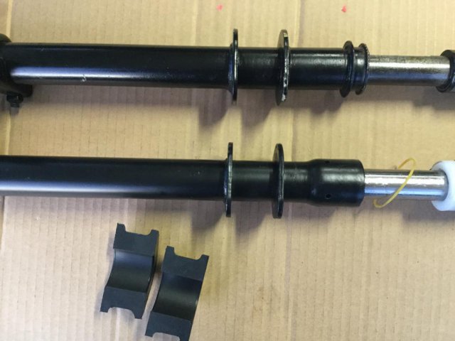

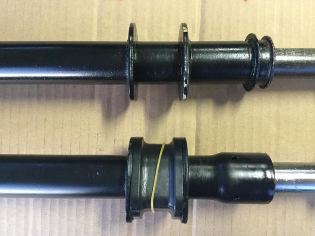

Forgive the delay, I'm finally feeling better after a bit of food poisoning. Here's what I have to report: -ratio is the same as my 77 280z rack -stroke is 1/16" more in both directions -stock rack was 3 turns lock to lock / new rack was about 3.15 turns (probably due to slightly longer stroke) -splines appear to be the same on input shaft. -gear housing is cast aluminum on new rack vs cast iron on stock rack (checked with magnet) -new rack weighs less (4.5kg vs 5.5) -the rack gear itself on the old unit is flat on the side opposite of the gear teeth. It's round on the new -
