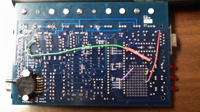

Yeah, that's what I'm doing. Basically, all it's doing is taking the 'on/off' signal from the CAS and sending a trigger to the coil to fire and an injection each time it triggers. Here's my board. Disreguard a couple of the jumpers to JS3. That's how I modded for a fan relay control. (Another reason I shoulda gone with MS2.) But you should be able to see the ignition output pretty well.

Well, it's been a long road to turbodom, but I finally everything together to get my engine started on MS1v3 this past weekend. After a couple leaks fixed and about 4 hrs of wiring, she turned over smooth, but did not fire. Connected to Tunerstudio, all guages were reading except the tach on Tunerstudio. I was by myself, so I could not hold the coil wire to ground to check spark, but I would safely assume there is none. I have just took a good look over the ecu board that I built and all connections/solders look good to me. I double checked over the high current coil driver instructions on the Megamanual assembly site and modifications to the board from the DIY site on installing for l28et site, and all looks well. I'm wondering what the bip373 should show on the three legs while powered up. Also, my other theory is that the way I wired the CAS is with 12v going to the dizzy and the signal wired to the 1k resistor and tied back to the 12v constant on the dizzy. This may be knocking my dizzy power back down thru the resisitor? This evening I'm gonna run my signal back to battery 12v thru the 1k resistor and see if that fixes it. Any thoughts? Also, here is some screenshots of my board, if anyone sees anything I'm missing.
