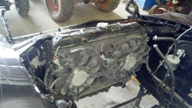

  10. They are each 13". One has 11 blades and the other 10. They will runn two speeds both can be controlled by the facrory relay. I haven't looked it up, but I'm guessing at a max 10 amps.
  11. Here's an idea for all you guys out west cruising at 120 °....I got these fans off of a 2013 Altima that I had in the shop that was totalled out by the insurance company. I also had a shroud laying around and grabbed the factory relay to control it. Even with some serious cutting, couod not fit the shroud, but the fans themselves wedged in perfectly. Im gonna cut these and just run one, because it was gonna be in the way of my same sided intercooler plumbing, but would work well for those of you with inlet/outlet on each side of intercooler or a n/a setup. I believe the same fans go on Altimas and Maximas back to 2008, so a used one shouldn't be terribly hard to find. New could be aquired from Nissan. Anyway, just thought I'd share.
