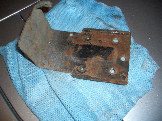

  5. Took a while, but I got the pump after finally tracking down one of those brackets. Thanks for the help Inline6, I test fired the car tonight (exhaust isn't on yet) and the pump is working. Thanks for all the help.
  6. I'm in (urgent) need of the fuel pump bracket found near the tank in the rear of the car, pictured below: Edit: Actually, I'm looking for one from a '73, though the 260/280 ones may work as well

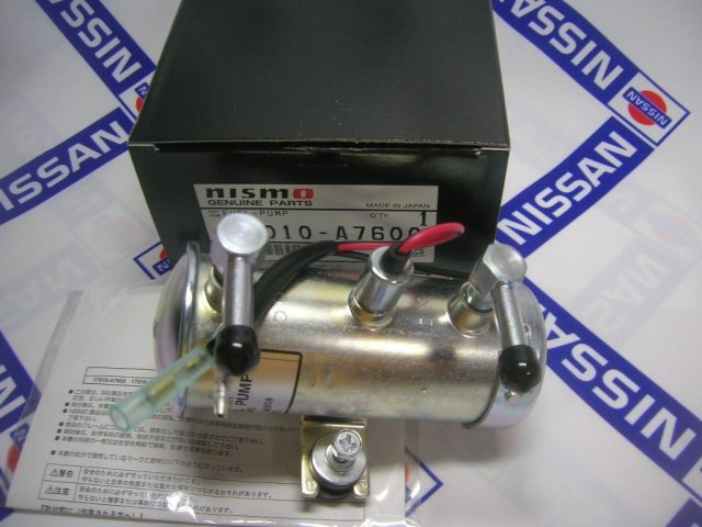

  7. I have looked around for info on this but haven't turned anything up yet. Apologies if it was right in front of my face. I'm trying to install a NISMO fuel pump (push style) near the fuel tank on my '73 240z. It is my understanding that the car is wired to run the fuel pump, but I'm wondering if there is any guide to exact mounting / wiring. This is the fuel pump I'm referring to: Thanks for any info you can provide.

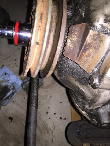

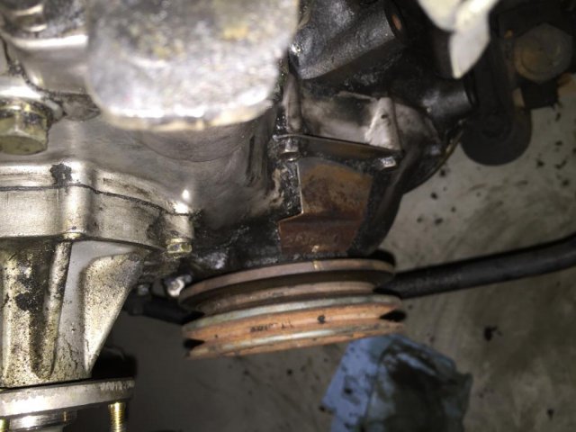

  8. True, although the chain links are off by one link when I can get it to mount. I'll give it another go and turn the cam, it must not be at TDC.
  9. I did try the lever trick, perhaps not as forceful as needed because I didn't have any luck. At this point the only thing I can think (based on what has been said earlier) is the chain doesn't have enough slack because I can't get the gear quite high enough to mount. All I can do is kee trying, but this seems tougher than it should be.

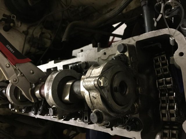

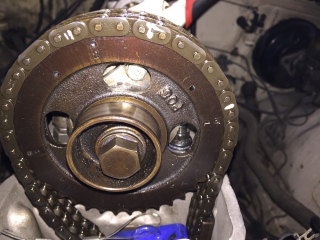

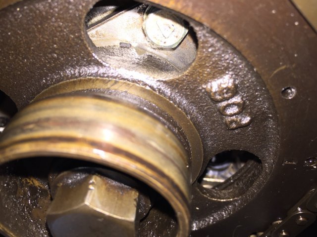

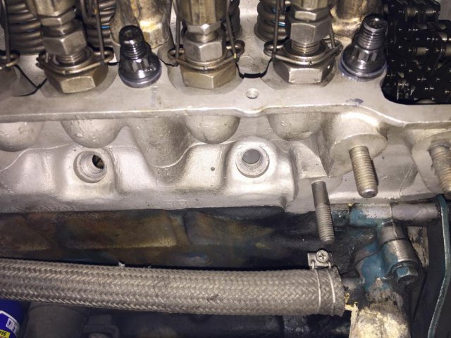

  12. I spent some time on the motor tonight, based on the tip about the correct placement of the timing mark and the oblong groove I shifted the cam slightly a few times to try and line things up better. I'm not sure if I made progress or not, here are some photos of where things sit. My only concern is that the marks on the timing chain I made originally no longer line up, they are one link off from where they were. The cam sprocket is on position 1, but when I try to install the gear with the chain links as they were, I cannot get the gear to mount. Move them over just one link, and it mounts up. I'm assuming I've done something wrong.
  13. I did mark the chain before I removed it, and it is also wedged. What I didn't realize is that the timing mark on the cam shouldn't line up exactly with the triangle on the cam gear, I thought those two needed to be right on top of each other. Good point NewZed about my wording, I should have elaborated. The cam gear would not stay in place but this was just because the sprocket hole wasn't lining up to the dowel, as you mentioned. Late last night I made another attempt, but now that I know about the timing marks I will be revisiting it today after work. I'll post some pictures again later for a sanity check, thanks a ton for the help so far guys!

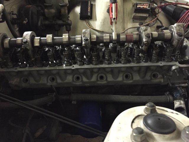

  14. I have read and read and read about this topic, and there's a lot of great information available. Despite that, I'm having trouble making sure that my particular situation makes sense and is correct. I am replacing my head gasket, yesterday I reinstalled the head but ran into trouble once I went to install the cam gear. The block was at TDC, with pistons 1 and 6 at their top position. The head was at TDC, based on the front two lobes being set to the "bunny ears" position. I am having a hard time installing the cam gear, the timing marks do line up, but every time I connect the chain it won't line up again or install firmly. The cam was shifted ever so slightly to try and make it easier, but I'm not sure that was a good thing. I know not to turn the crank and cam independently so I'm avoiding anymore of that. What I'd really appreciate is some help confirming I have things set properly, I really don't want to pull the head again to ensure things are right but I will if I have to. Any advice you guys can give, or threads that perhaps I missed, would be deeply appreciated.

  18. Turned the cam to TDC, worked great. Thanks again to everyone for their advice.
  19. I cannot spin the cam to save my life. I appreciate the suggestions about using a piece of metal or wood as leverage, I will try and give that a shot. I have the tensioner wedged, while I am hopelessly under qualified to be doing this job, I did try and do some homework before I started.

  21. I have searched for help on this topic, but I've only turned up articles that address some of my problems. I'm wondering if someone here can help me make sense of this all. I am replacing the head gasket on my 240z. The head has been removed and taken to a shop, where it was determined that the valve seats are damaged. Fortunately, I had a replacement E88 head. The issue that I am running into is setting the proper timing on the head before I put it back on the car. The motor is at TDC, but the head is way off. I know that the front two lobes should be pointing up, that tells you the head is at TDC, but I am unsure how to get it there. Do I need to install the cam gear? Sorry if this is a real rookie question, but I am completely lost and would really like to get my car back together. Any advice would be greatly appreciated, thank you.
