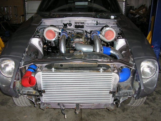

	I did a rearmount Buick Roadmaster with an LT1 used a stock cam (191/196 .421/.431) with stock iron heads and it does well. It has a T70 with .84 hot and on street tires it did 13.1 @112 with a 2.1 60. I had to feather a long way, given the car is 4400lbs that is ~400 RWHP so small cams and stock heads are quite capable. I will be running it again with ceramic coated manifolds and expect to do alot better with slicks. Stick will hurt the spool but when it hits it will be one hell of a kick in the seat. Look forward to seeing more. My Z will have twin 60-1 (knock offs for now) and I expect to run ~6 in the 1/8th but likely will need juice to get it to spool.
	Are you sure you have a big enough turbo? What size is that monster? I am using two 60-1 on an LT1 build. They will peek out the hood the headers just got ceramic coated today so hoping to get progres in a couple weeks. What hp are you shooting for?
	I am running a solid cam 232/233 @.565" with 1.5 I am using 1.52 eockers. IThe engine is a 377 LT1 (3.75 stroke). I will be running twin 60-1 with ~14 psi and hope to run 6 in the 1/8
