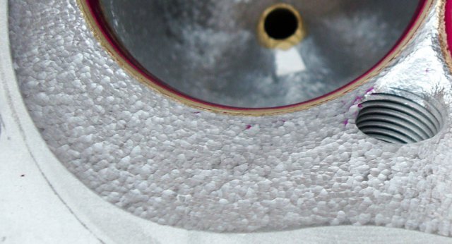

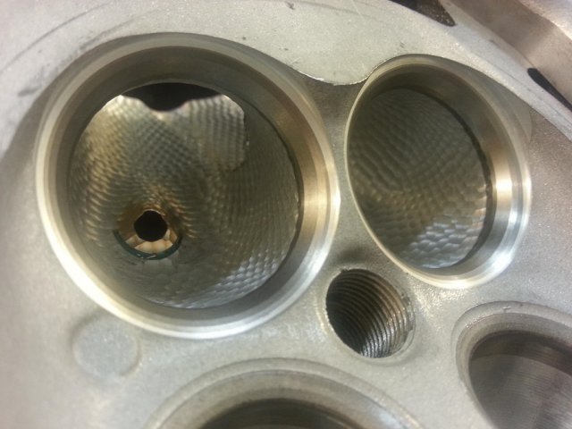

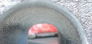

  5. Well it might be an interesting test to take my Kameari intake manifold and rough it up with 80 grit, and re-dyno the setup and see if anything changes. I already have a baseline and everything properly jetted from when it was done back in December. According to my tracking info, Slovers will be receiving the head on Tuesday, so I dont really have a lot of time to have a proper decision made only from what my V8 friends tell me and what I have read online. From everything I read, having the walls a bit turbulent when its fuel/air is a good thing and it helps break up that laminar flow along the edge. The idea is that at the surface walls, the wet air moves more slowly than when its not at the surface. Venturies and carbs are always smooth, because its BEFORE the air gets mixed with fuel. That goes back to the fact that when its dry you want it polished/smoothed out.

  7. So talked with Slovers a bit, and he is going to leave the intake side rough for now. Once he evaluates the cylinder head more when he gets it will go from there. But for now the intake side will be roughed up with 80 grit and the exhaust side will be polished. Not going to do the combustion chamber, as roger mentioned, I think it would load up on carbon deposits rather quickly and negate any positive effects. Slovers said they saw early detonation when it was done that way, which contradicts what the article above said. But im not going down that road anyways. This is going to be a monster head, 12:1 CR, seeing 9k rpm. Big ports, big lift.
  8. Yeah it doesnt seem like anything new, it was that I just have always heard of a polish job whenever someone quotes me. I have never heard it "rough' so to speak. Anyone see it done on an L6 cylinder head? Im shipping an N42 head out to Slovers today, and may have him do some changes in lieu of a polish job...
  9. I've always seen cylinder heads with a "polish". However, I was just turned onto an alternative from some v8 friends of mine who are drag racers, which the port is dimpled like a golf ball or roughed up with a carbide bit, on american V8 engines. Doing the intake manifold rough up the same way with carbs installed, I am told allows the air/fuel mixture to better atomize since the fuel droplets are bigger rather than if your ports are smoothed out. Their is debate on the exhaust side since its "dry" not wet like the intake side is with Fuel. the intake port has to deal with wet flow which can cause fuel to stick to the port walls. dimpling or roughing up the walls coaxes these fuel deposits to continue to flow through the port or evaporate because of the turbulence it creates. From some research online there seems to be varying degrees of what should be dimpled and what should not. Has anyone experimented with doing dimples on the cylinder head or intake manifold on an L6? Article I found on v8 engines: http://hotrodenginetech.com/pipemax-creator-larry-meaux-on-race-engine-head-porting/ "I took one of my old chipped up and slightly bent Alumina Burrs and rough ground just the entire intake ports on a big block Chevy Dart head all the way to the bottom valve job angle cut. Back on the dyno the engine gained almost 15 HP on a 950 HP engine. We kept going with the rough carbide finish everywhere in the intake, exhaust ports, chambers and intake manifold from that point on. So far every engine has responded with 15-25-plus horsepower increases, a wider power curve, sometimes 100 to 300 higher RPM point of peak horsepower, less fuel consumed on the Dyno ( lower BSFCs ) and dryer exhaust ports. On the flow bench, basically no flow gains I can measure from roughing up the entire heads/manifold surfaces. On the dyno and down the dragstrip, we consistently see more HP and quicker ET/MPH times"
