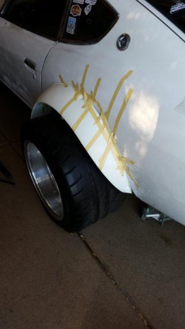

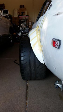

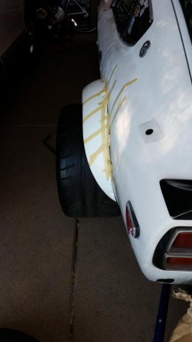

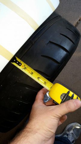

Mocked things up today. Im in love with these flares... they will fit perfectly when they get bolted into position and compliment the existing lines just right. The backspace on these wheels is 2.25", so very close to the wheel hub. With the adapter, it pushes the wheels out pretty far. The front wheels barely fit under the flares and wont need any modifications, the rears, is a whole other game. Despite my friends saying roll with it, im going to get them changed. From the edge of the center of the flare to the outside of the tire, its 5" over. So I think at this point I have two options. Rebarrell the rears (maybe a 17x12? and/or change backspace / will need to figure out how much I can go before rubbing suspension parts). Second option redo the rear hubs on car to a 5x114 eliminating adapters (silvermine motors 180$) gaining me 2" which still wont fit under the flare, but the center of the tire will be under the car at that point. Currently the center of the tire isnt even under the car, which I dont think is very safe. The adapters are super high quality and despite what they look like, are very light. -

Yes... I went looking for negative offset wheels first. I wasnt planning on going this big, but there was an opportunity for some great vintage wheels and I decided to go ahead with it. Once the wheels, then I needed to find the flares, and from what I could find the Works flares out of Japan were the biggest flares you could get other than IMSA or YZ complete fender replacement. I measured them out, the flares are really wide at the bottom and taper back. The front flares measure 11" from bottom corner straight across. The rear flares from bottom corner across measure out 10". The material is FRP. Front Flare: http://i.imgur.com/vAy20XM.jpg Rear flare: http://i.imgur.com/bfJGe53.jpg I think because they are so wide in the front it might help conceal it a bit. From the side you wont notice so much, but looking from the rear of the car, may look odd. With the front flares being the widest in the front, Im more concerned about them not fitting right than the rear since the fronts wheels are only 10.5" wide (that spacer may help here a lot). I am a little bit concerned about the rears and that 2" adapter, but I could always adapt the hub later which would then get rid of that. Another thing is about a 3 piece wheel is that they can be re-barrelled to almost any size you want.... there isnt many choices in tires for 17x14... only 2 road tires, Michelin Pilot Sport 2's, and Pirelli PZero's. The few others are race car tires (Hoosiers and Kuhmos) Kuhmo Ecsta XS is whats on the rear's now. -

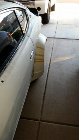

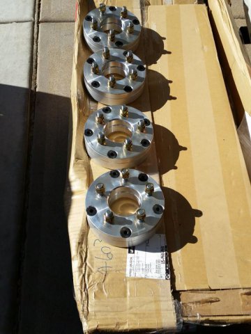

Finally got the flares in today. They measured at the top 5.5" wide in rear, and oddly 5.75" wide in front. The front flares have a cutout for the marker light, so I know I was looking at the front flares. The rear flares has a grove to follow the body line at the kickpanel. http://i.imgur.com/nWsMbBT.jpg Custom wheel adapters being made here in town to go from 4x114.3 to 5x114.3. They said 1 to 2 days. Had to measure the wheel bore on the new wheels before they could start. -

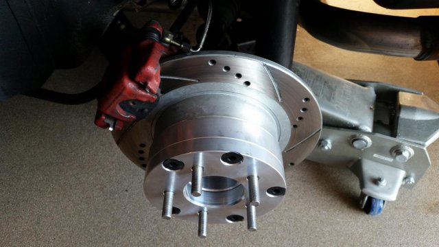

I need 4x114.3 to 5x114.3... man those guys are cheap... makes me wonder... Getting some made here locally from www.airbagit.com at 99$ a piece, completely hubcentric -

Calling around, drilling the wheels aren't going to work. I found a local business here in town that will make the wheel adapters for me. They need both the wheelbore and centerbore measurements to keep things hubcentric. Based on this setup the adapter is going to have to be 2" which is going to push these things out even more... http://www.wheelfitment.eu/car/Datsun/280Z%20%281975%20-%201978%29/ says the centerbore is 73.1mm for a 280z. Can anyone confirm? -
