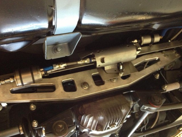

  6. Fuel system is finished except for a short piece of return hose and 4 clamps.
