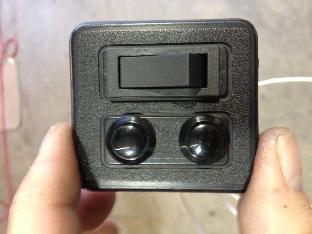

  16. http://m.ls1tech.com/forums/showthread.php?t=1649755 There was a thread on there that had like 3 different wiring scenarios depending on the alternator used. I'll see if I can find it in my history. This is what I used to wire my alternator in the LS1 Datsun but I only have 1 wire in the small if.
