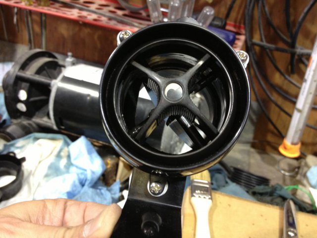

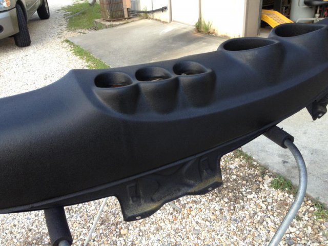

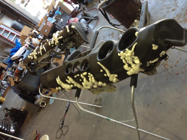

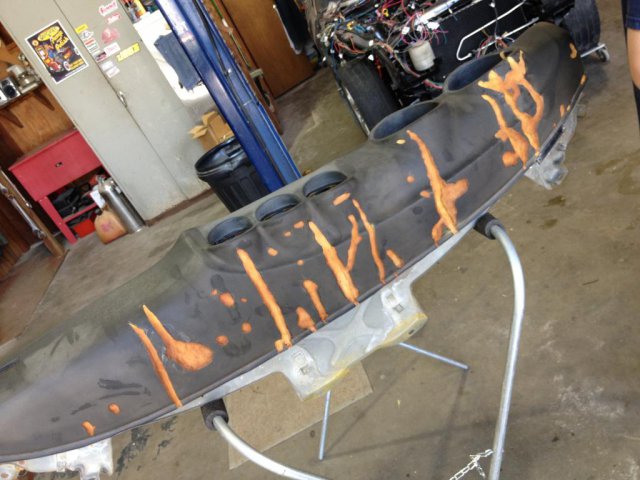

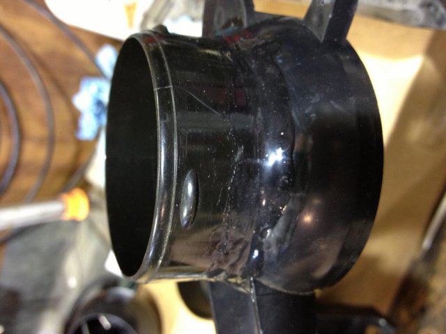

  1. I don't remember because I got them for my last car. All I know was it took 2 different ones. They were all from a late 70s very early 80s Mercedes. I used the rear part of the ones with the 2.5" inlet and the ball vent from the one with the larger inlets. The vents appeared to be the same except the ones from the large ones were blacker, that's why I used them. Here's the dash after a coat then a sand and a second coat of the padded dash filler. This stuff is hard to sand. I ended up using a DA very lightly on the flat areas.

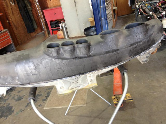

  2. http://forums.hybridz.org/topic/114638-1978-280z-gto-ls1-t56-ttt/page-6?do=findComment&comment=1110058 I started using the urethane supply padded dash filler yesterday. It is really flexible. I have some pics starting on post 110. I will try to take more today.

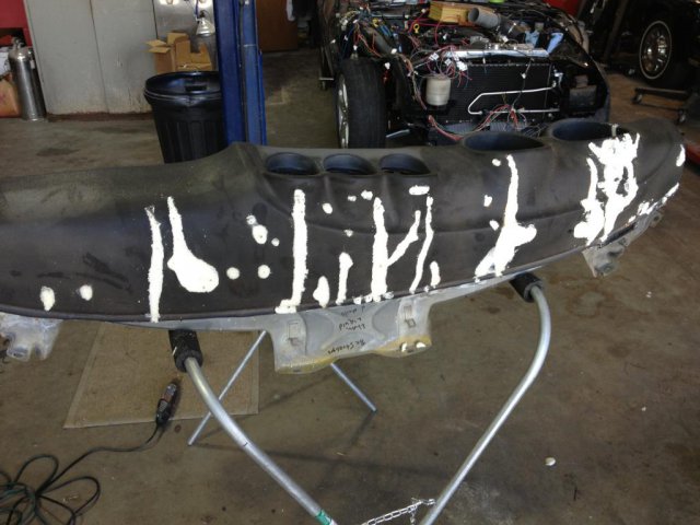

  3. Started on restoring the cracked datsun Z dash yesterday. Got it dremeled out, filled with great stuff foam, shaped it with a hacksaw blade and put the 1st coat of the padded dash filler from urethane supply company on. I got too small of a can of it, so I may have to order another can and not be able to finish it until next weekend. Hate when that happens.

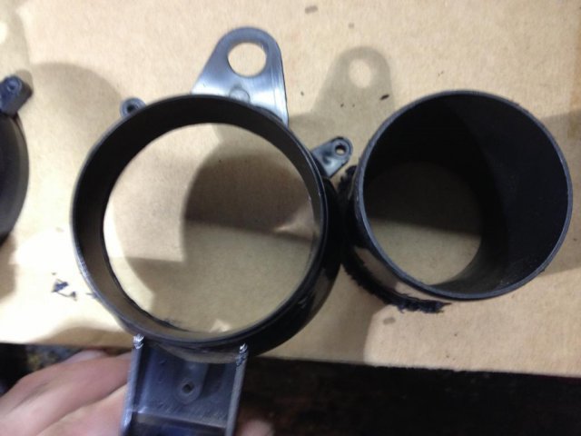

  4. My friend and I are both restoring our dashes at the same time. Since vintage air is being used we wanted to make sure we get as much airflow as possible. We combined Mercedes vents with the Datsun vents. They happen to use the same size hose as the vintage air output, so no having to make the hose smaller by the vents. In the middle picture you can see how much larger they are than the Datsun.

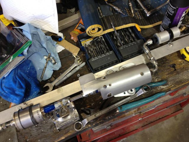

  7. I mounted all my stuff on a piece of aluminum angle I had laying around. I drilled up into the frame in the middle and both ends and used nutserts. On the outer ends I had to put small spacers between the angle and the frame. I use the 88 ford can bracket a lot of people use to hold the pump.
