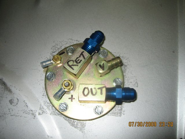

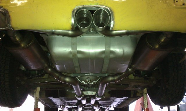

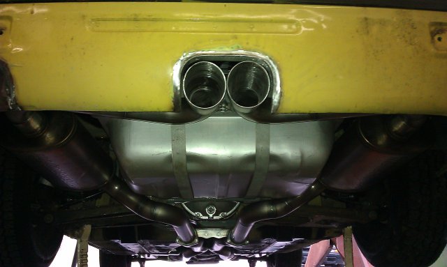

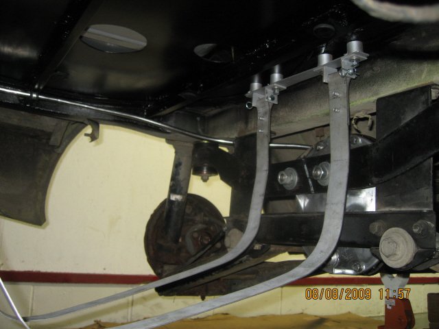

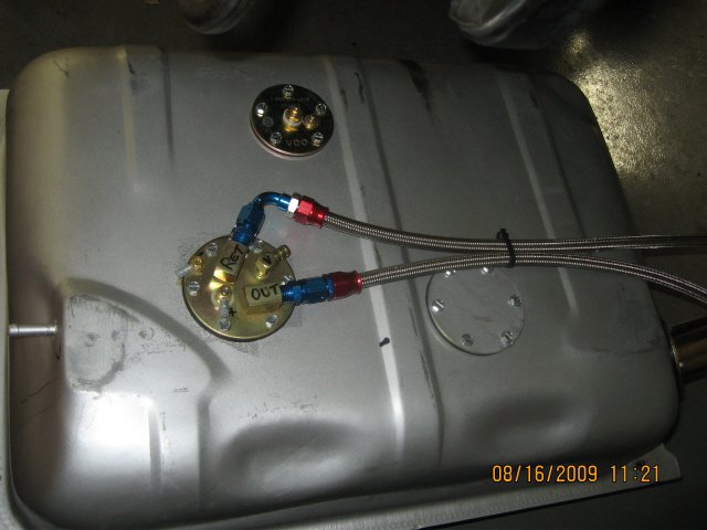

It is possible to do a center exhaust, and use full size mufflers, with the right tank. I bought a more traditional tank, vs. a fuel cell, from Tanks Inc. Far enough forward for the center exhaust, but still room to get at the nuts for the rear diff mount. 15 gallon capacity and in-tank oem style pump. Fuel fill works fine with just a simple welded up adapter pipe. Long tubes in my future, at some point, just have the John's Cars shorties on for now. -

It was the one Tanks Inc. calls the Universal Tank. I believe it is 15 gallons, comes with the option for in-tank pump like the factory would do, and allows hookup to the factory 240 fuel fill, with a little work. I think pump, tank and straps ran me a little over $500. -

You can just barely see it on the right side in the top view tank pic.
Thanks for the comments on the exhaust. I can't be proud, all I did was write a check. Regarding the tank: I went to a ton of trouble trying to make the factory Trans Am tank work because of $$ and also because I wanted a factory style in-tank pump. But that turned out to be a heavy, ugly, non-symmetric deal with not much exhaust or fuel filler pipe room. Google pointed me in the direction of Tanks Inc. here in MN, (320) 558-6882 who make a universal tank, P/N USPT-G-H along with the P/N UMS universal mounting straps and P/N PA-4 250 GPH in-tank pump. Tank was $215, pump was $210. Pretty straightforward, using the usual Vette filter/regulator and a Painless pump relay kit. The tank holds approx. 15 gallons. Here are some pics of the mounting, pump and fuel level sender. It's all in the car now, worked exactly as planned, started on the first twist,though since I haven't driven it yet, I guess it's possible I could run into a fuel starvation thing maybe. They do provide sort of a well internally around the pump pickup so I hope that's good enough. The factory filler neck lines up pretty well, with some adaptation courtesy of some welded exhaust pipe adapter pieces. In the pics you can see the forward hanger mounts that I spent way too much time on, along with the stainless hard line I ran from the filter/regulator all the way up front to the fuel rail inlet. I had previously removed the spare tire well and welded in some flat steel sheet, and I cut holes in the top in case I need to access the pump or sender. I still need to figure out what to do with the tank and pump vent lines. I've heard of people doing a charcoal filter right on the end of the line, not sure yet how to handle it. Glad to offer up an option to the Z community that has been so helpful to me during this build.

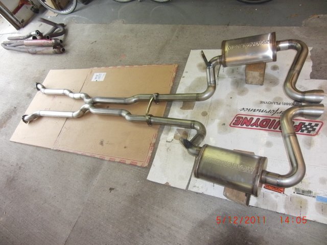

Well, I went pretty budget on most of this LS1 build, but decided I wasn't talented enough to make my own exhaust and know a guy locally here in MN that does some kicka$$ metal fabrication work. We did a mild steel mandrel bent system which he TIG welded together with some nice sturdy flanges. I also wanted a different look to the rear, and had him close off the factory opening and had made room with the tank pretty far forward to do a center exhaust. Now that I have this spendy and purty exhaust I have it in to be ceramic coated satin black, should look good and hopefully not rust. I should be taking my first drive in June, and having worked three years to get to this point, it's about time. I went with the X-pipe and Magnaflows based on listening at a number of sites of recorded LS sounds. Though I haven't heard it yet as my dash is out along with part of the wiring harness.
Hey, before you go nuts with a custom aluminum tank you should know that there's a readily available universal tank from Tanks Inc. that allows for the placement of dual exhaust. I had this system custom made with mandrel bends and Magnaflows and it fits fine around the tank. No doubt a much smaller investment than a custom aluminum job.
