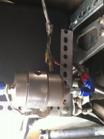

No fire yet.... Spent most of the weekend helping my daughter with a science project. harness is very nive but instructions for intsall are limited at best. On a positive note, Yury from Wiring Specilaties called me personally over the weekend to address my questions I left on their answering macnine.... Nice customer service IMO. Corvette filter/regulator has a return line that plumbs back into the cell.... no surge tank planned as of yet. -

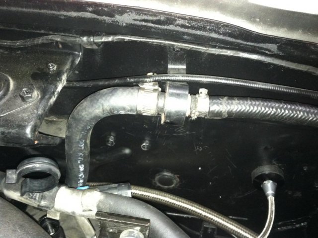

trackzpeed replied to trackzpeed's topic in Gen III & IV Chevy V8Z Tech Board

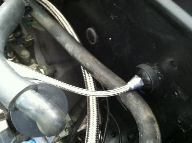

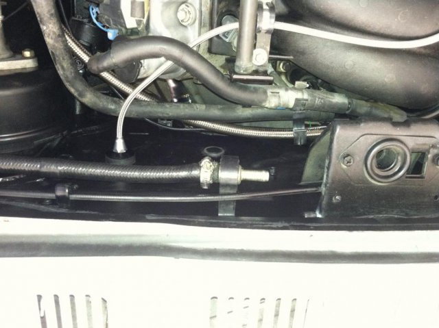

well That was easy... Just some hose to create and "adapter/spacer" and cut down the orginal to fit.... -

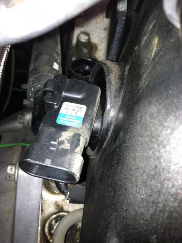

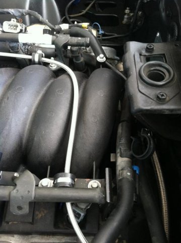

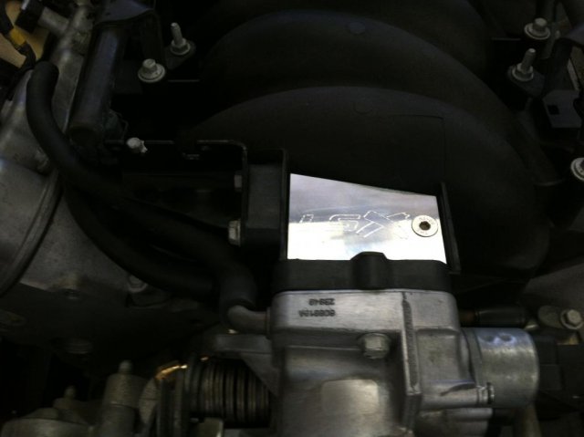

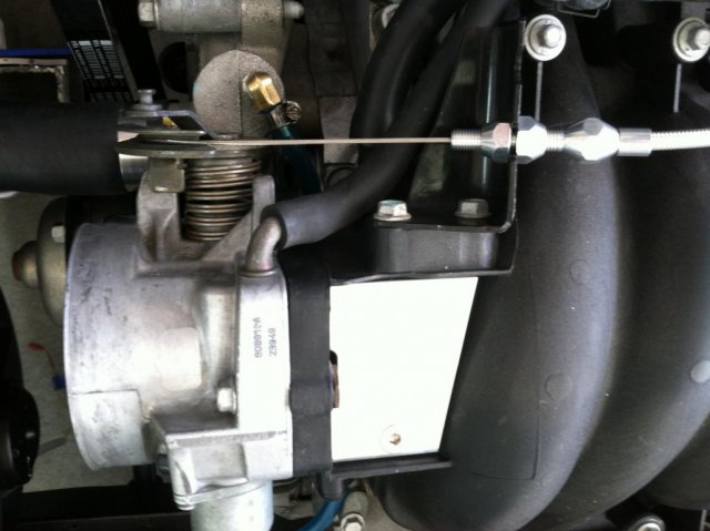

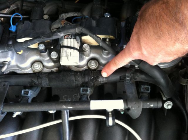

Now for the "odds and ends" questions..... what is the plug/harness connection on the back of the intake for? and what does the giant diameter hose that comes off it go to, can I cap that? where is the best location to pull vacuum for the brake booster? (Driver side intake port?) Do I need all the hose (and believe there is a PCV wrapped in there) tucked in down the side of the passenger side intake? -

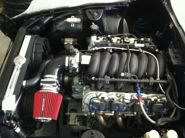

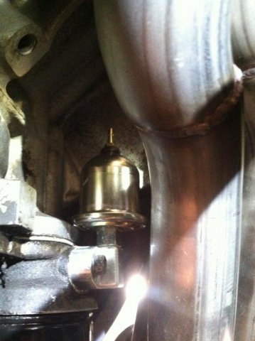

Well it's all done minus the harness...... +/- a few odds and ends. oil pressure sender had plenty of room with headers in place. -

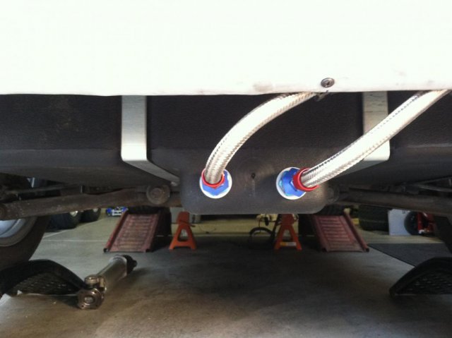

TrackZpeeds CXRacing LS1 T56 240z

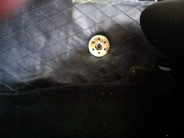

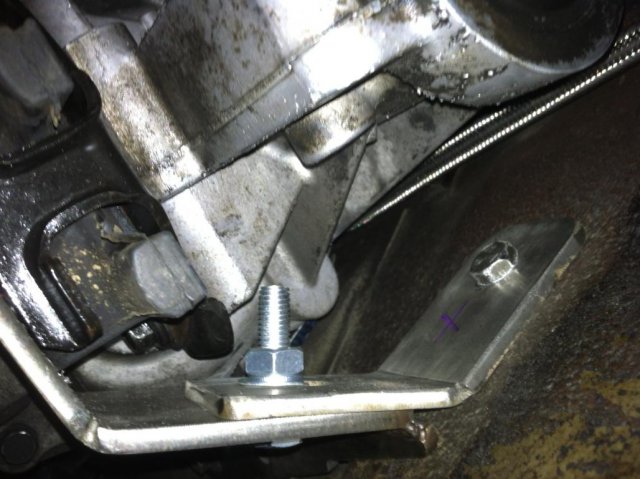

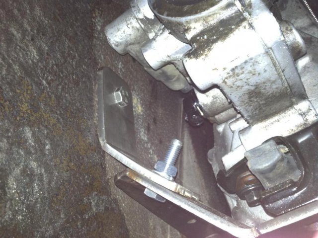

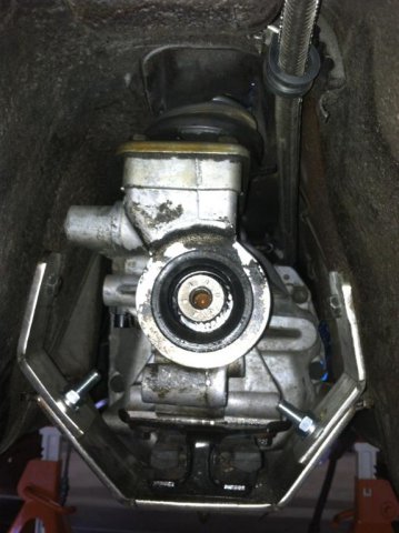

Hey thanks Richard.... The tranny mount is kinda tough, I wanted it in with drivline to check angulation before dirlling but that leaves very little space to mark and drill in the tunnel. I used a dremmel for two small holes for markers then drilled them from the cab side. It's very stout and not going anywhere.... I've been pretty happy with the this CXR product to date. -

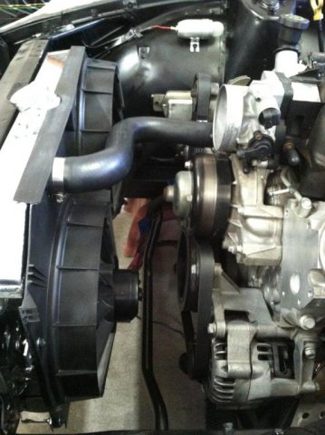

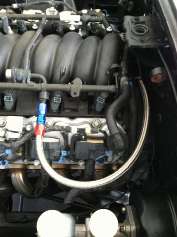

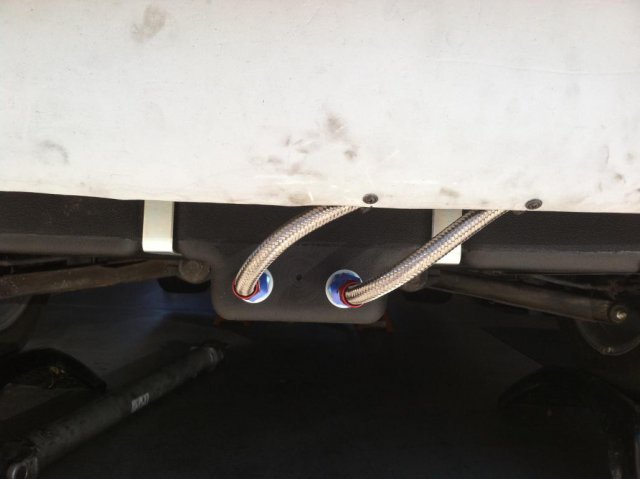

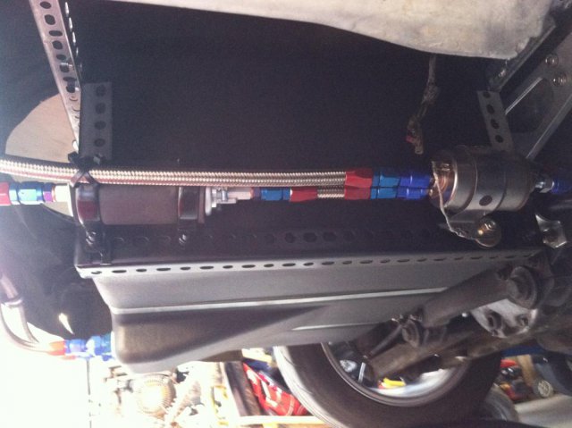

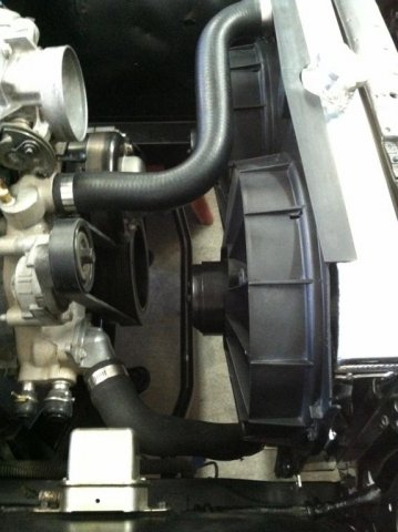

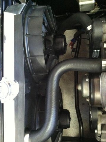

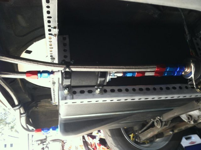

Random pics from the weekend. Fans from Camaro in place after fabrication, tranny mount done, coolant sensor, EGR block off, Fuel complete............. All thats left is intake, finishing exhaust, and wiring to get her on the road. -

The sending unit threading is brilliant! that will be up next. I have not drilled out the tunnel mounts yet since I was waiting to get my driveline in to check for angulation. It all looks pretty good so the mounts will be done this weekend as well. Thanks for the water temp sender suggestion. Jim -

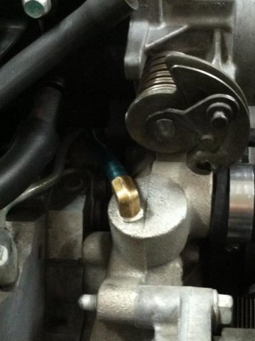

I started with it dry as a bone and drilled a tiny pilot hole.... use compressed air with lg bit to keep chips out until just before I started to break through then pulled the axle grease method on the drill and tap to keep it clean. going super hand slow with the drill helps alot as the housing peels off versus chips and is easy to manage. I'm confident I kept her clean.... -

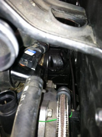

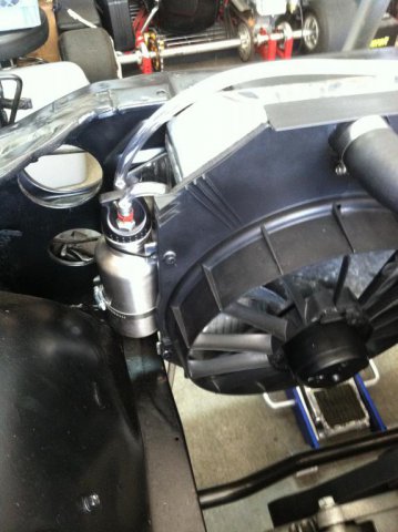

Here is the shot of where I tapped for my steam vent..... I'm going to try and use the port on the passenger side head for water temp sending unit... JTR has a 1/2 and 3/8 NPT adapter for the Datsun sending unit, will either of these fit in that port? Thanks guys. -

I need a little help/advise.... How do I hook up water temp to the stock Datsun Gauge???? I drilled and tapped the top of the water pump for the steam vent, and there is enough room to put the Datsun sending unit there as well, but im looking for a better/proven option. Thanks, Jim -
