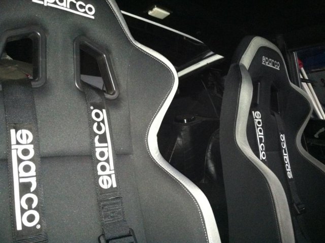

trackzpeed replied to trackzpeed's topic in Gen III & IV Chevy V8Z Tech Board
Sparco R100, they fit nice and work well. -

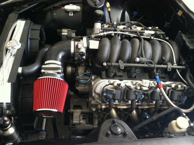

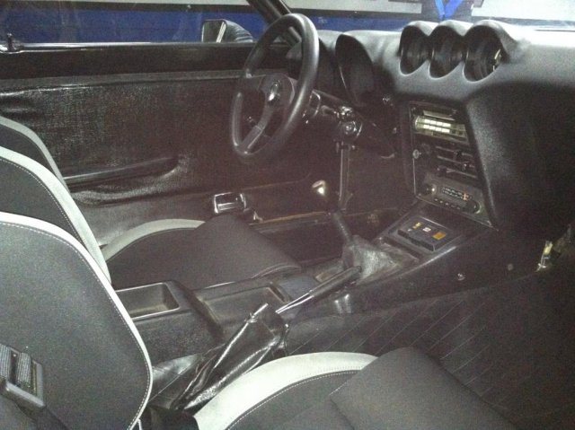

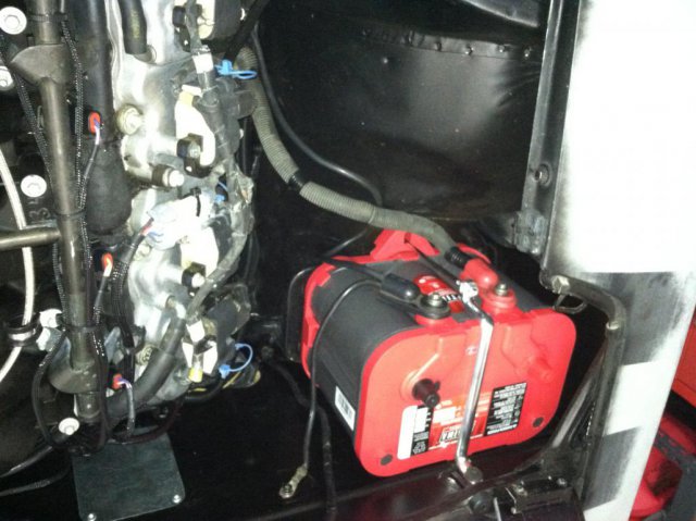

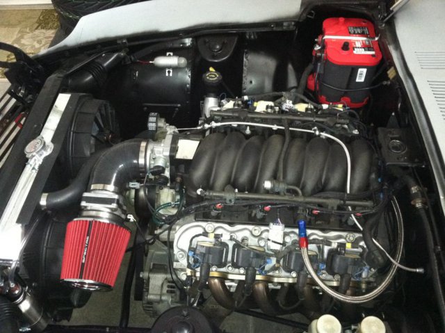

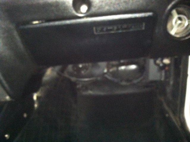

Finally got my PCM hidden away up inside the glove box region. My battery holddown is the shiniest part on my car. A picture of my engine bay now complete. And the interior put back together… Having a blast driving around as weather permits. One annoying thing has creeped up, my fuel pump makes a sound like letting air out of the balloon..... It doesn't seem to affect acceleration but is crazy loud and needs to be addressed. Any thoughts? I have as ZG flares and 9 inch wide wheels on the way so I can finally mount my 255 R888's. -

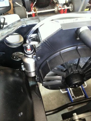

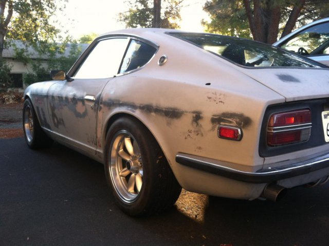

A few shots..... My Z outside my office (daily commute is so much fun now). finished exhaust, engine bay, camaro fans mated to Champion radiator, and my home made overflow out of a stainless steal sports bottle. New front diff mount, Speedhuts (4.5"), on there way. Looking into flares to fit my 255-50-16 R888's, new FG door cards, and TEP triangulated strut supports F & R. Holes are are welded from previous trim, but I need to get going on the mud. Hope to have some fun video soon. Jim -

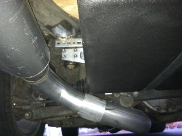

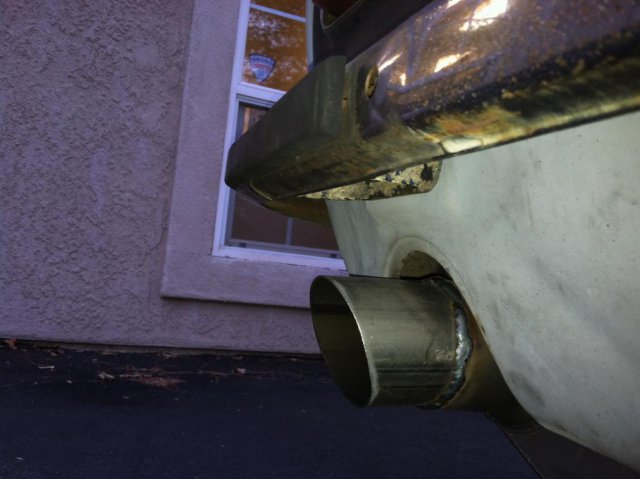

Saved about hundred bucks going custom with nice flowmaster muffler, sounds amazing but the phone speakers can't handle it for a decent video lol. shop made some heat sheilds off exhaust to protect fuel cell and rubber bushings. The finished exhaust woke the motor up too...... this thing just rips. traction is problem made worse with colder weather/asphalt now..... Best decsion I've made in a long time was this swap. I'm very happy with intial results. time to finish up details as time and cash allows, but for now I'm having a blast. Gauge update: It will cost way more to make the datsun stuff work than to buy new. I think I'm going to go with speedhuts..... -
