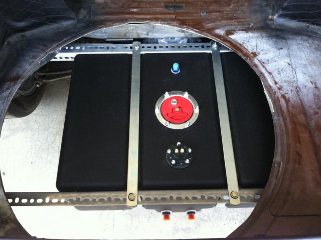

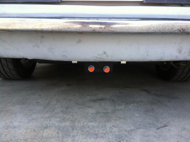

TrackZpeeds CXRacing LS1 T56 240z
trackzpeed replied to trackzpeed's topic in Gen III & IV Chevy V8Z Tech Board
mock up..... -
