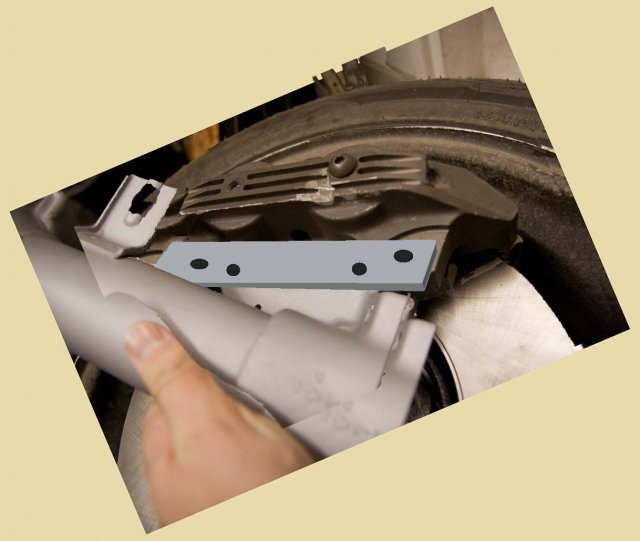

Discs and calipers certainly look good. How are you thinking to mount them to the stock strut tower? I was thinking pehaps mounting a plate to the back that then had two other holes drilled to accept the caliper bolts. I dunno maybe something like this, I know my photoshop skills suck.

In anycase, the new LSD diff he's got should be nice! Toni, Looks like those rotors will fit. Any luck on the bearing issue? What model Mercedes are those rotors for? Z31 rotors are too thin I guess? Some people use truck calipers in their swaps. Tho Brembo would be sweet. I wonder if the Z33 Brembo calipers are any good. (just trying to stick with the theme here you know?) Phar
