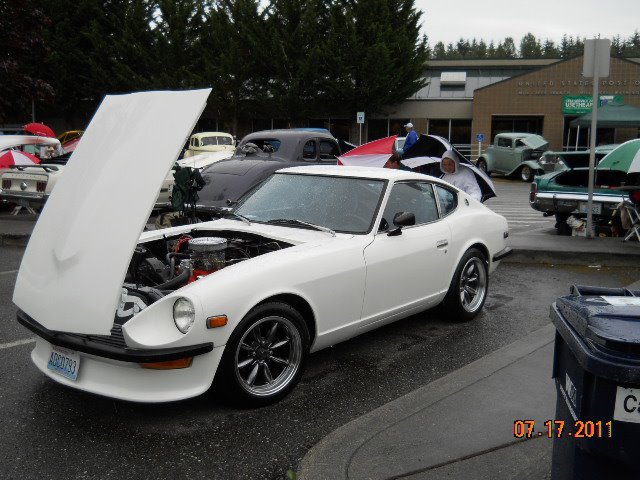

	Never completely done but here is my z. Actually my first car and started working on right before I turned 16. Almost 19 now haha.
	Haven't updated this in a long time haha. Rod knock was much more severe then thought and resulted in getting the cylinders bored and a new crank. Along with it I got it decked and the motor hot tanked. Threw in a big cam that is made by CNC or something like that. Read up on it and its kind of a mystery cam but I like it. Thought it was going to be to big but it still turned over and has a beautiful sound. So now it's a 355 with hyperteuctic pistons. In addition, overheating was what caused my engine failure so I got an aluminum radiator with a big summit racing fan and built myself a custom shroud out of alluminum. Is doing a nice job. To be really safe I am also wrapping my headers when I attempt to get the exhaust a little higher in a couple weeks. Anyways I got to fixing fifth gear as a clip backed off fifth gear. Have better interior pieces on the way to. She is leaking a little oil and tranny fluid so a family friend is going to fix that while I am finishing up my summer school session at college. Good news is, the motor is a monster and I love it. This is a photo someone took from the show I attended before leaving for school.

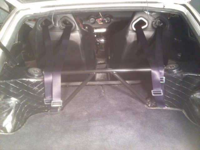

	Yup I love it and it gets the job done safely. Not the best way to mount harnesses but it is much better than the lap belt I had before and certainly better than going to the floor.
	Safest way to do it is to roll bar but I couldn't afford one so I made my own version of the PDK strut bar for like 25 or 30 bucks. You can see more on how I built it in my signature link. Speaking of which I really need to update haha. It is removable to.
