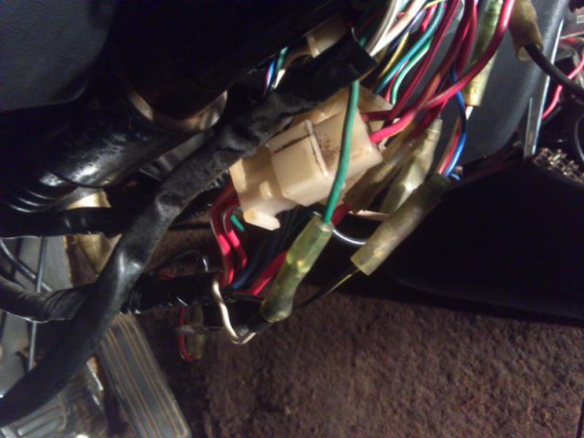

Yup it was that green wire going into the white wire outside of the 6 pin. It went into a flasher unit but no power was going to the flasher unit so I just tapped into a different 12v source.Original source went into the hazard switch but I was not going to rip out the dash again. I can finally move on with my project. Going into superspeed right now. Got to get this thing done by the middle of June. -

Yes the green wire in the 6 pin connector is the hot one I was talking about. I just tried hooking my green and white wires up to that flasher or whatever it is and nothing happened. Anybody no what I am messing up on or what that solenoid does. I have green and white wires hooked up to a different flasher that was down here right now. Edit: Fixed It. That green spade going into white needed power -

Squeezed my head up under that dash and might have found something but could not feel any wires to go to this. It appears to be another flasher unit. I think when I kind of took my dash out to get the speedo cable on I might have tucked them back in there. That would explain why the turn signals do not blink when I apply power Anyone think this is my problem? And yes the hazards do work -
Start it off, this is for a 1972 240z. So I have gone through the FSM on Xexons about 4 times now and it helped a ton on my wiring. I literally have everything besides my heater/fan working now thanks to that FSM.But these turn signals just don't like me. I have tried to see if someone could send me a picture of their column wiring but that failed. So, I am going to explain what I have come up with which could show the source of the problem. First of all, the signals do work, as when I send power directly through the wire they turn on. - The black ground that connects the headlight switch and turn signal switch is grounded good as headlights shut off when disconnected. - I am getting power through the turn signal loom with what I remember to be a solid green wire. - Just replaced all my fuses with brand new fuses - I have another turn signal switch and it does not work either, the original one worked before so that should not be a problem. Possible Problem area: - There could be another source of power not going or sending power to the turn signal switch - There is a green spade connecter coming from the turn signal switch, in the picture, going into a white spade connecter. This wire has no power going through it with key on or off or signals on or off. If someone sees an issue within here any input would be greatly appreciated. Or if someone could send me a picture of their column that would also be greatly appreciated. Main reason I am stressing is I am doing the interior of my build for my Senior Project so yea... I am sure most of you understand haha

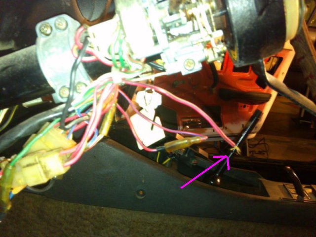

Alright got the brake switch working. But I have an issue with my turn signal part of the harness at the steering column not working. I believe it has to do with the green spade connector because that is hooked up to nothing right now. It would be a life saver if someone could just send me a picture of what there steering column wiring looks like. I have been searching everywhere from google pics to here and can not find a good picture of someone's steering column. BTW it is a 72 240z.

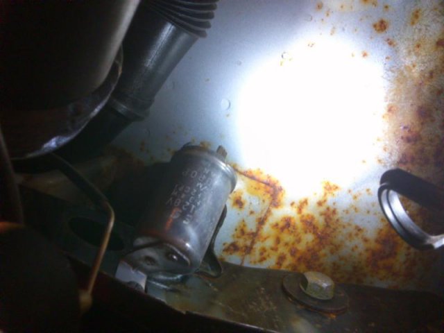

Thanks alot turbo. Now I get to go treasure hunting in the garage and a lot of luck to find it. Atleast it is not the end of the world or at the top of my list right now since it seems to just be a buzzer.

There are 2 spade connectors with no where to go right there and for some reason I remember a solenoid,relay or something similiar there. The car is a manual. For some reason I have a suspsision it might be a door buzzer but if someone can confirm that it would be great.
Anybody? Something has a place above the hood pull lever and I would like to get on it as soon as possible
So I stripped my interior ahwile back and now have wiring with nowhere to go. Right above the hood latch from the inside of the car was some sort of solenoid with I believe 2 black wires going to it. I can't find it in the manuals and if someone could let me know what it is so I can google a picture of it that would be great.

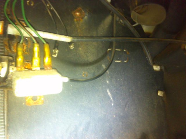

If someone could take a picture just like this link shows it would help me out more than anything. I did figure out where pic #2 went though. http://lh4.ggpht.com/_GKlDb1xNbNg/TMZhZBotSKI/AAAAAAAAAsw/qzCOAEU-KlY/s512/P1010003.JPG

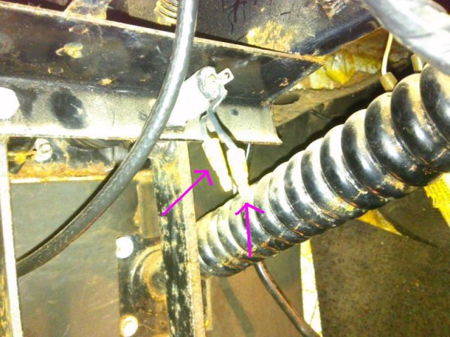

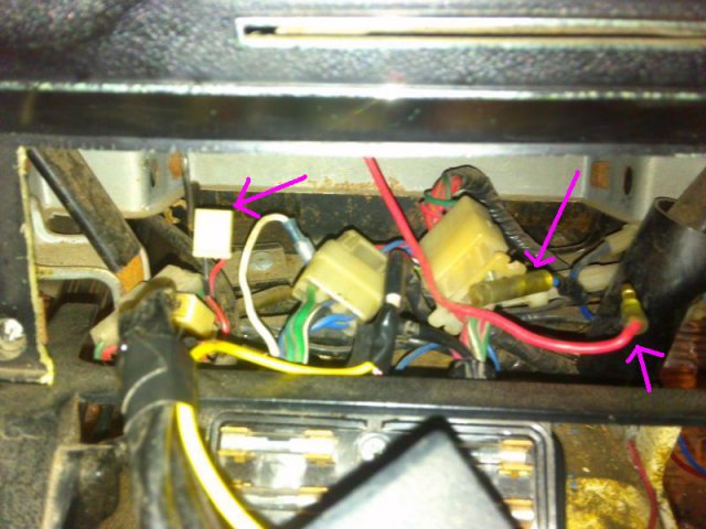

Alright I have had a little help with the fsm but there are still quite a few loose ends. The loose wires with pink arrows to them are my problem and if anyone could help that would be great.
