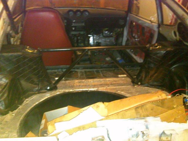

I believe all the tubing is one inch and the sheet metal I used was a little shy of 1/4in. The cap for the strut tower at the top does not work for me but whatever. All I did was drill hole through my mounting point behind the vinyl. Put the vinyl on and then strut tower. Poked a hole through then slid the bolt through.
Alright I have fixed quite a lot of loose ends, and valves are tuned. Had to get a new Brake Booster cause mine was leakin air. Thats all good, but now I have to fix the issue with my clutch master. ughh. Anyways that wont be to hard and from there its just that and my carb getting tuned and mechanically shes done. Here are some pictures of the wheels. Keep in mind there is still a lot of weight missing from the car so might get a bit lower than it is now and I am fine at its height now. Lower is always better though haha. So I got some stuff done.... - Valves tuned - I installed an e-fan from Summit - New Booster - New Plugs - Finished and installed strut bar - Wired up bunch of stuff, made a power block for 12v, switched 12v, and a ground to clean up my wiring - New SS Brake lines all around

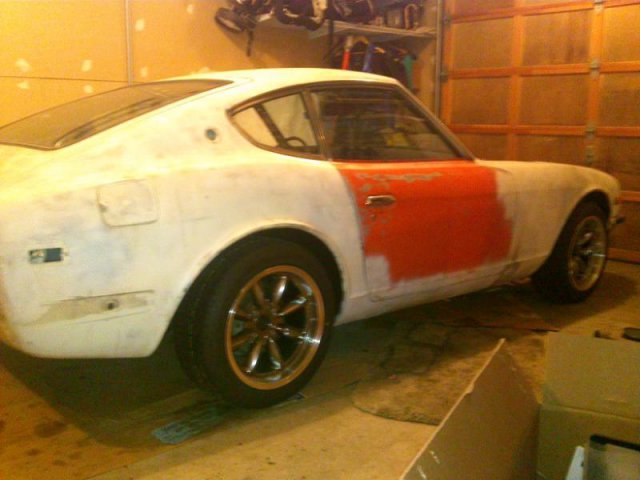

Wheels are on the car and got them wrapped in toyo proxes 4. Brakes are all done. Just waiting to get some help tuning my valves on mon or tuesday and to figure out a couple loose ends still mechanically. After that I will tackle my electrical while the dash is still loose from the speedo cable hook up. Really suprised on how nice the wheels look. They cleared fenders and front brakes with a 7mm spacer up front, but I won't know if they rub anywhere else until she runs.
