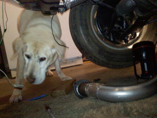

  3. Well I was suppose to be done for this school year being my senior year but due to my engine ordeal I missed that date by a bit. Between school and my part time job it is hard to find time but any bit is for my Z. Definately lost a bit of social life haha. Anyways, Today was first day in a week I have had to put a good amount of time in, started and got half way done with exhaust. (Got it back to the diff with dual 2.5in and met at a Y pipe, eventually going to go to a single outlet). My 13yr old lab helping me out

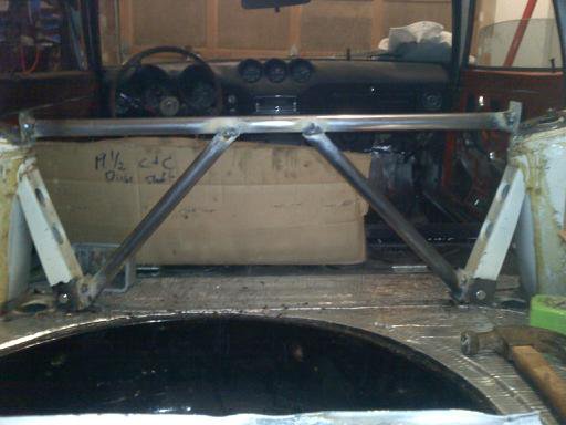

  5. Thanks guys. If I did not trust my welds I would not have welded in my floors but I am willing to say I know this can hold up to a bunch of pressure and I am not worried one bit of it failing. I know a roll bar would be better but I do not want a roll bar and its a million times better than having belts go to the floor or strut towers. I weld in a well ventiliated area and material even being new was sanded down before welding. Thus I had very good penetration. It was actually a fun little project to do while I waited for another q-jet. Here is the finished product not installed.

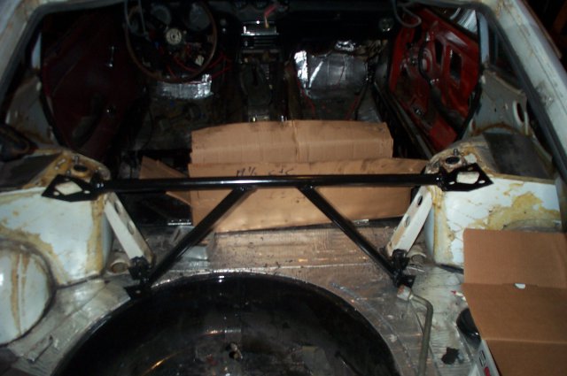

  6. -Bought and installed new starter -Recieved material to build my exhaust -Finished rear strut bar and painted it black -Sent bumpers off to powder coaters Oh yeah btw I got the motor to start!!! Definately woke the neighborhood up at night and to add on to that I got my braces off. Today was definately a good day! -got to get a diode in the alternator to shut it off -Build exhaust -Clean up some wiring

  8. Well thanks to PDK not selling me a rear brace I'm almost done with my own (all tacked in but stil gotta finish welds, clean up, and paint it. Got my wheel spacers and extended lugs for some wheels in the future but workin on puttin those in. Broke a darn banjo bolt for my brakes that no one sells so waitin for that. Recieved a better quadrajet carb and waiting for a fuel inlet piece. And to add on to all that I am ordering my stuff to make my own exhaust!!! I need to go into Superspeed right now to get this thing done!!!!!!!!!!

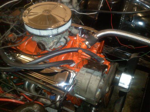

  13. Still got to bleed the clutch and cap off some vacuum hoses on the q-jet but I am going to try and start tomorrow when I do not have any work. Wires are still messy but I will clean them up once I know for sure the wiring is correct. Dressed her up a little and what not.
