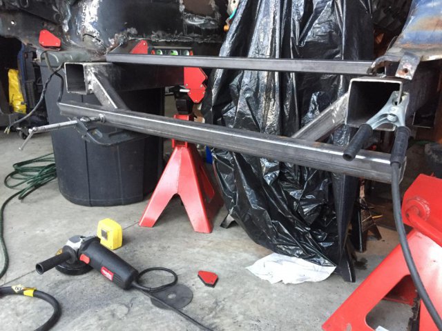

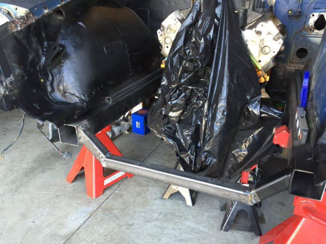

4 weeks. .jeez! Not much done.. This Army thing takes a lot of time. I mainly worked 3-11 which makes it hard with anything else in life. Front framerails are capped, lower core support finished. Bought wheels, mounted front tires and man.. i should've gone with about 1.5" more BS lol They will work for the time being, but shortly will be buying a second set of wheels with stickies. Front crossmember is halfway done for mounting my double wishbone. I'm sorta stumped on making my LCA's with such a wide triangle that I may be re-engineering some things. with my PS rack clearing the oil pan, and still getting a u-joint angle I can manage with turbo downpipes backtracking the manifold. Lots of thinking to do as I build the back half of my lower crossmember this weekend. My spindle upper ball joint holes will be reamed tomorrow and I can officially order the UCA's. I'm using the slotted mounts for total adjustability with circle track arms. Once the LCA's are on, I'll measure for coilovers! IF I get the wheels on the ground next week and trim removed, I will be taking it to the body shop on Saturday. As of 8 days out, I'm uncertain i will make it lol Photos to come! -

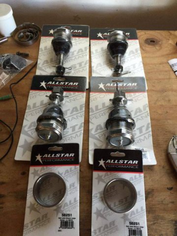

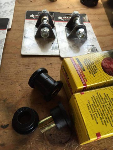

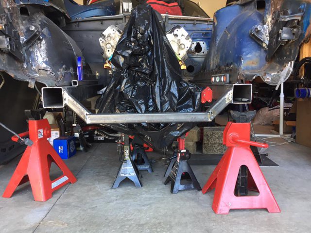

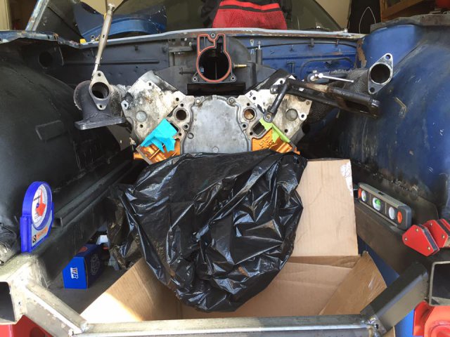

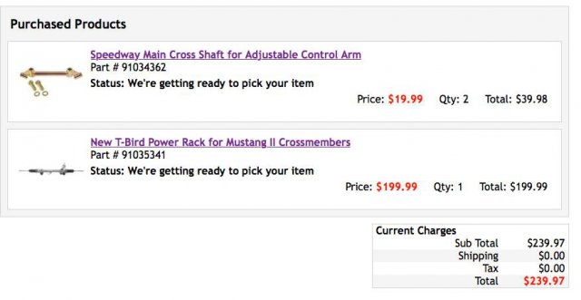

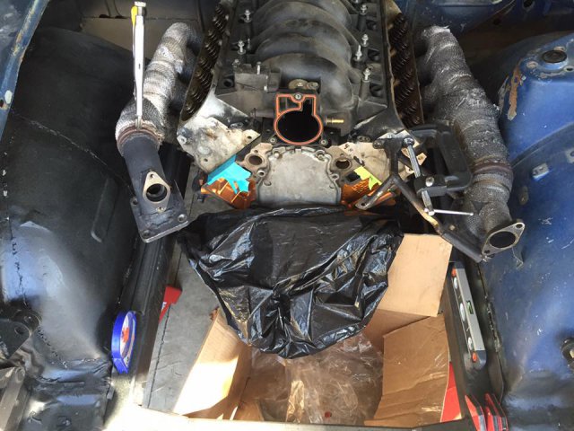

Well, in the last few days, I've been in and out and the pollen has taken over! I've had to chase the leak on the 6.4 tow pig in the meantime. Anywho. Tacked the crossmember. I gotta grab another spool of wire to finish out, and with no backflow Argon flow, hard to TIG that up. I just TIG tacked it in. Got some new parts in, Ball Joints, Sleeves, Coilover Mounts for the LCA and inner bushings for the LCA's. Today the Engine mount plates came along with the slider boxes for UCA mount, pics to come tomorrow. Ordered Mustang II Power Rack, and cross-shafts to keep the sliders square. I hate to order the shafts without the arms.. but i'm unsure of the length I need at this moment. 4130 tubing inbound next week along with another 2 sticks of 1" tubing to build the crossmember. going very basic with bolt in plates i'll weld to the frame similar to the Hawk's motor mounts so the X-member will come out. Also mocked up the hot side! Taking the lady to the airport in the AM, may not get a chance for much before working at 3. Going to still give making the mounts a go. Monday should be productive! -

I like that part as well.. Eager to get it in! The side parts to the front crossmember are done, then ran out of wire ): -
