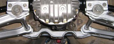

Ok, so I got the rear setup installed with a new transverse link arrangement that allows the use of the rear mounted 240Z rear sway bar in a 280Z with R200 with finned aluminum cover. I am making up a second link like this and will post a dimensional diagram for anyone wanting to make their own. Here you go. -

No clearance issues between the sway bar and the diff cover. There is about 3/4" clearance from the flat part of the mounting section of the transverse link we still have, but the diff brace is 1" wide, so "No Go" there. If the brace was 1/2 the width, it would work. I'm currently getting the new brace solution made up. Will keep you posted. -

OK, so I put the ST rear sway bar (for 240Z #51075) on my 280Z with R200 CSLD w/ finned cover. It fit without any fitment issues, but I do have to fab up a new diff brace since the sway bar runs across part of the same area. I've got 2 different ideas on how I'm going to do it and neither are that difficult. Here are some shots. -

There are technically 5 pieces there: 2 x drop downs (attach to bottom of car) 2 x control arm mounting caps 1 x cross brace that ties both sides together I just need the cross brace,
Need the rear suspension brace that connects at the bottom of the drop down brackets and connects at the rearward control arm mounts across the back of the diff cover. Thx!
