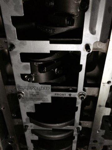

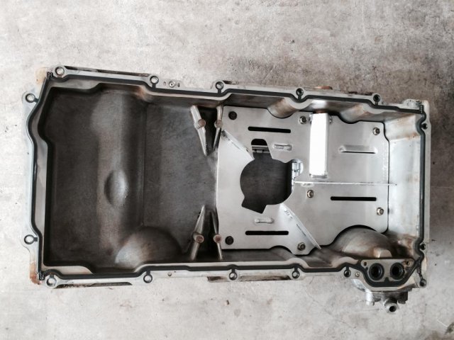

  12. I have the F-body pan and added the Improved Racing (hinged) baffles and the crank scraper. Should be good to go and clearance isn't bad since I didn't slam my car.

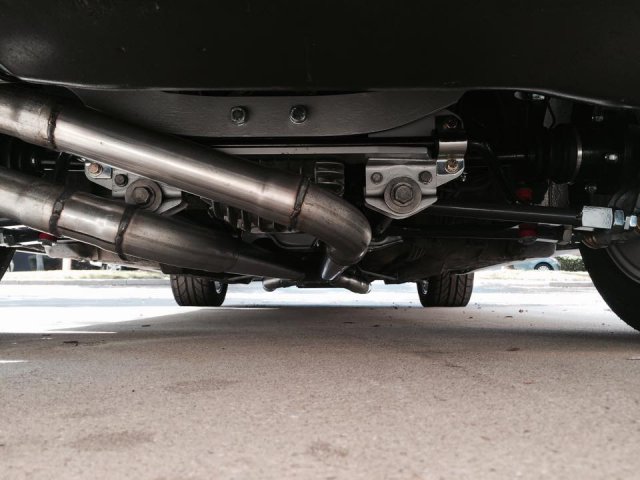

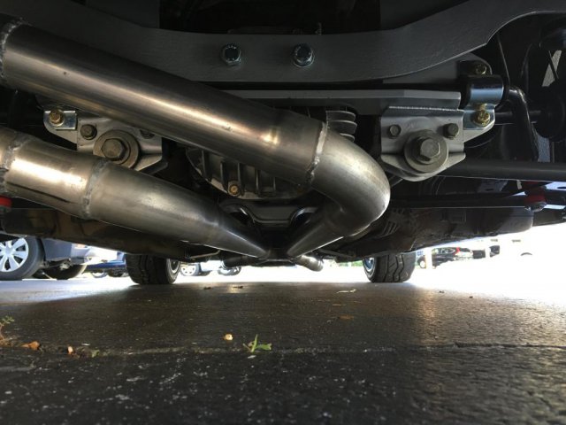

  13. I don't have a shot while on the rack, but this may help. I copied a friend's car that has an old school SBC with the same piping & muffler and it sounded good, as well. Not the prettiest, but functional and didn't cost me a fortune.
  14. I have a dual 2.5" mandrel bent tubing with x-pipe going all the way back to a Magnaflow dual in / 3" outlet in the stock location. I went with thicker 14 gauge tubing to keep noise down. This is a video from the outside: This is inside my car with my iPhone 7 and a blast at 70% throttle in 2nd gear. Quieter than I expected:

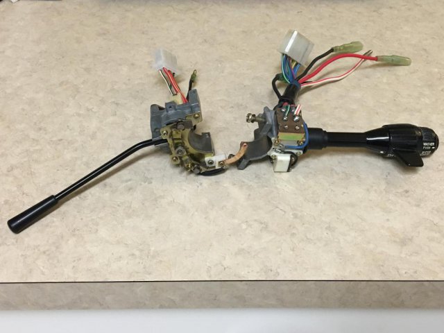

  18. I sent both my turn signal switch and headlight combo switch to Dave Irwin at http://datsun-240z-upgrades.net. Turn around time was less than 48 hours and they look and work like new. The combo switch was broken/jammed and he replaced the arm inside, polished the plastic and replaced connections. On his advice, I upgraded the flasher relays to modern electronic flashers and it all works better than new. For $130 shipped to get both switches done is well worth it. Just my 2 cents.
