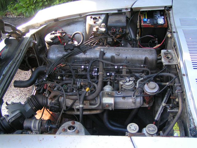

Well it seems that I was off by a tooth ... or 2 or 3. It took a minute to figure out how to get the cover back on with the spindle in position, basically I needed to turn the spindle back (to the left) about half way since the spindle turns when the cover goes back into position. Now I have a small leak in the oil pan area so that gasket will probably be my next project......
Got the car running last night, thanks to all for the assistance - the picture was a huge help
Big help, thanks! I am getting spark, forgot to mention that earlier - I'll have to go and check everything tomorrow aftenoon, it's getting late... back to work in the morning!
I removed my timing cover this weekend to replace a blown gasket and now it won't start. I have seen many posts about checking cam and timing chain position, but none on where the dizzy gear should be - Currently, when the #1 cylinder is at TDC, the rotor is pointed at the #1 also. I did not remove the oil pump or touch the timing chain when the cover came off, but the dizzy gear did move a bit. Does this make a difference? BTW , it's a 77 280z EFI.
