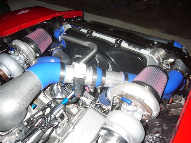

Didn't have much time to work today, however, did get some mock-up completed. I hate to pick up air inside the engine compartment, but ran out of room for the 4 inch ducting to the turbo inlets. Compesated a little by cutting out the outside of the radiator braces on each side to flow more cool air into the compartment...best I could figure. Wayne

Some pics of progress on the hot rod. Still got some clearance challenges t work out, but no worries...it will work. You can see where I had to clearance the strut towers and driver-side valve cover. Wouldn't have had to do the valve cover if they weren't tall to clear the stud girdle. You will also note the passenger turbo is higher than the driver side. No had to use a spacer as there was no other way to get enough clearance on that side to clear with the motor offset 1" toward the passenger side. Banks designed the system to work without an intercooler, but I'm running more compession than he, so I wanted the safety net. Besides, who knows where this will lead? ) More to follow as I get more done. Not a huge amount of room for the down-pipes, but will have to have patience and work them down through. Wayne
