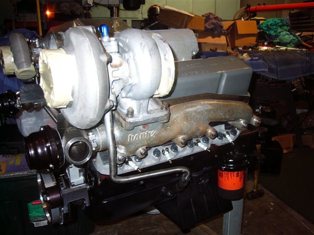

Well..about finished up with the install...got some cats and dogs to round up. Should be done early this week and then on the trailer to Tom Heldenberg in Leesburg GA for the TEC3 install and onto his dyno for tuning. Thought you would like to see how it went back in. Will give some numbers when we get through tuning. Wayne

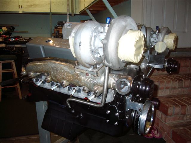

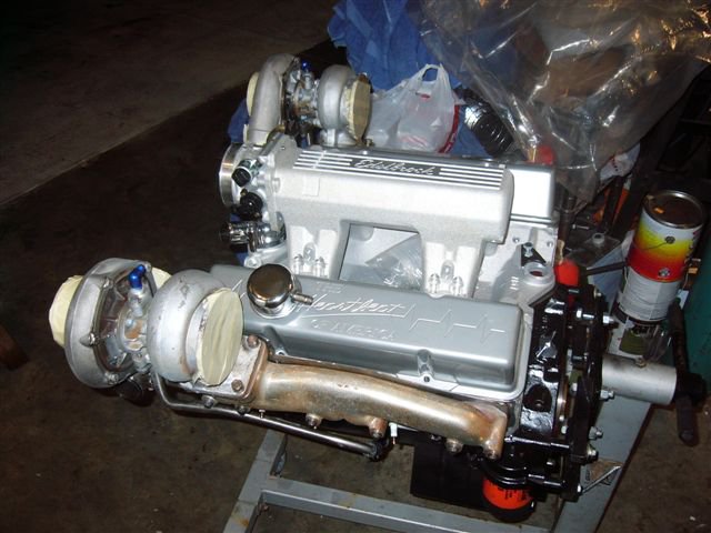

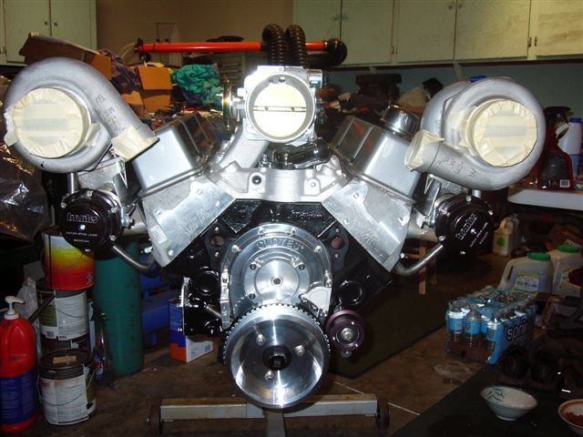

These are the latest pics from the project as of tonight. Coming together...got the bottom end pretty much buttoned up. Working on the top end putting everything back together and checking fitment. Davy..you've planted the seed now...not making any changes right yet, however will keep an eye out for E85.
rsicard....it is a 90mm edelbrock throttle body. I only port matched the intake to a 1206 Davy...didn't think of E-85 to be honest with you. Probably wouldn't take much to change...I would need bigger injectors as I believe using E-085 requires about 30 to 35% more volume. The rest of the fuel system would work. Need a re-tune from straight gas also...not sure if I have any outlets here or not. Might be worth checking into...this is a street/strip car so it would be very useful if I can get the E-85. ZZZeee is correct...no need for the alcohol if using E-85. Can't believe you guys start stuff like this...now you have me re-thinking the project....) By the way, the engine is in the car...hooking everything up at this point. Wayne

Hey folks, Happy New Year!! Been a while...for those who don't know, I hurt my 454 small block at Reynolds last March. Rebuilt it and put it in the barn for a future project. You're looking at my new motor for the z-car...same turbo system, however, motor is specifically built for turbos. 415 cu in sbc, 8.7:1 compression, AFR 220 cc intake runner heads, Jesel 1.65:1 shaft rockers, 3/8, .120 wall pushrods, JE custom pistons, 6" forged rods, forged 3.875 crank, small, short-duration roller cam and lifters,ported Edelbrock Pro XT intake, 96 lb/hr low impedence injectors, Electromotive distributorless ignition and ECM, Alcohol injection, etc. Switching from the Powerglide to a Turbo 400, running 355 gears. Hope to have it together and tuned by the end of Jan and sorted out by the time we get to another SEZ...) Wayne
