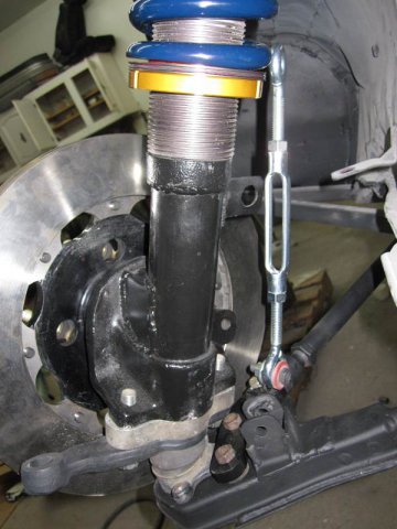

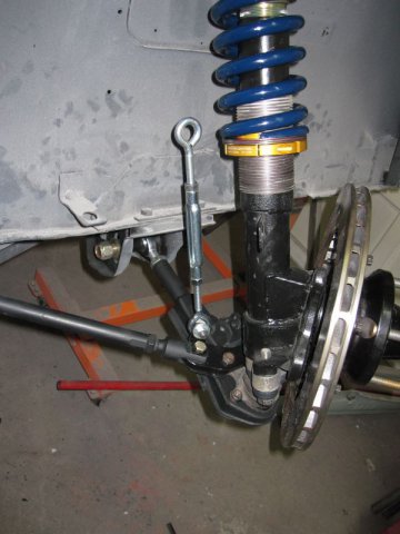

Weight of a .060" thick gusset and the welding wire to glue it in place isn't more than a couple ounces at most. I'm sure the weight of the sectioned part of the strut housing that I removed was greater than the weight of the gusset. Trying to think of an easy way to test flex now, because it would be good to have numbers to work with instead of intuition. -

The spindle itself is a lever arm that is about 3.5" from the middle of the bearings to the back side of the casting, and there is the "ear" that the spindle is machined out of which is another little lever arm for the strut to work off of as well about 1" long from the center of the spindle to the main thicker part of the casting. If the spindle came straight out of a solid casting, I don't think I would have done this mod. I think the effect here that we should be most concerned about would be camber loss in cornering. There may be some issues in supporting the weight of the vehicle vertically as well, with some corresponding neg camber loss under braking, but I think it's very analogous to the strut tower bar, where what you're trying to do is keep the neg camber and not lose it to either that ear flexing over under load in the case of the gusset or the strut tower flexing out under load in the case of the strut tower bar. Weight transfer = lateral g x weight x cg height / track width. Say that is 1.2g x 1200 (weight of one axle) x 21" / 53", or 573 lbs. So that outside tire is now having 1173 lbs of vertical pressure, but that's just the vertical load, and that doesn't account for the effect of the horizontal loading of the suspension through the twisting effect of the spindle as the tire tries to fold under the car. Here my math gets fuzzy, but I think if you just added the length of the levers to the 1' from the hub to the ground, you're going to get 1.375 x the weight, so really we're talking about 1612 lbs, but I think that is an oversimplification and too generous, because it is the convoluted shape that the forces are acting through that makes the structure weaker than the force would otherwise suggest. I think a large offset wheel would also skew the numbers further. Testing would tell the effects for sure, but for those who don't have the facilities to test, this is an easy modification to do and whatever distortion would be caused by welding is easily adjusted out by me, and certainly by most who would bother with this modification. -

Someone could do some FEA on it and tell you for sure, but for my $.02, the middle of the strut tube is an unsupported span, and the strength is close to the base. -

Yep. Can't remember where I heard about this, but it seemed like a good idea and literally took about an hour to do both struts. Really easy. Too bad there isn't a way to do something similar in the rear... -
