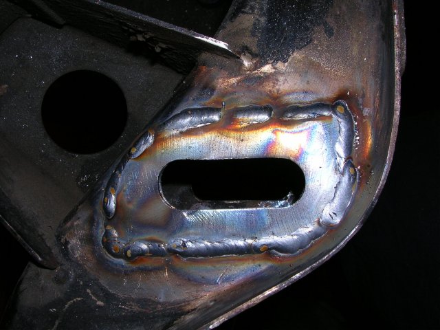

I'm using rod ends on the control arms so I had to make new spacers anyway, and this meant that I wasn't concerned with the inner dimension of the crossmember. Since it is easier to weld on the outside of the crossmember, that's where I did my modifications. I haven't talked to anyone else about the bumpsteer figures. I think I might be the only person who has a slotted crossmember though. Maybe Pete Paraska has one too. Not sure, I know we were both talking about it in 1998 or 1999. I know there was a lot of concern when I initially did it that the adjustment would move around. Never happened to me in about 40K miles and 8 seasons of autox and a handful of track days on the previous crossmember. It would also be pretty easy to weld the washers to the crossmember once the happy spot was found if that was a serious concern.
Not a big fan of the 3/4" up and 1/4" out because on my car 7/16" up got rid of the bumpsteer. 1/4" out has a minimal effect on camber, but is not really doing much of anything else. As to how I got the hole straight up, I just laid a square on the table and marked it and then eyeballed it a couple times to be sure it was as close as I could get it. When I did this I found that the rack was 1/8 or 1/4 lower on one side, so the tolerances are not super tight from the factory and it isn't necessary to be down to the .0001 on these.
