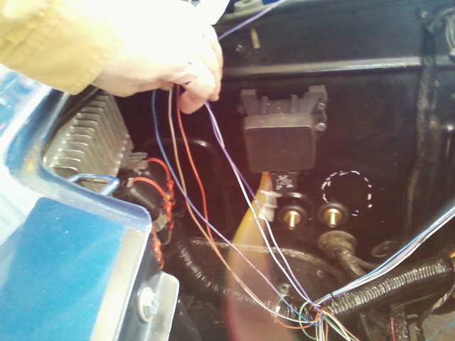

I'll take some pictures tomorrow. I kind of crashed after I burned the wire and went to the movies with my family. The wire I burned is the black one with red stripe that grounds the black center plug on the LS2 PCM to the passenger side head. I'm hoping I didn't ruin the big PCM plug. It was my fault, I just got sloppy. I found an hour of energy after the movies and pulled the engine back out and stripped all the casing off the harness (have a little more to go) to assess damage. I will be sending the harness and PCM back to waitformeperfomance for diagnostics, repair and replacement of that wire. It is only money (and time), right? Between now and Monday, I am going to adjust the length of some of the wires, since I have the casings off anyway. I'll try to take really good pics so that my questions make sense. Thanks for volunteering to help me-I can repair a ruptured eyeball, but I don't do wires. By the way, since you are from NJ: tommorrow, I'm supposed to approve the final draft of my daughter's Princeton application essay. It is due prior to Jan 1. If she gets in that will put a damper on my z-car budget! -

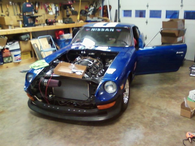

Just fried engine wiring harness. So much for getting car running before holidays are over. Pulling engine again to strip wiring harness and sending everything back to waitformeperformance. Looks like I at least fried the main power wire and connector that runs throughout the harness. Hopefully didn't burn up ECU. This harness has every wire labled, but it assumes that you have a basic understanding of wiring (no instructions came with harness when it came back) and has a ton of wires without any fuses, relays or connectors. This kit is not user friendly for the unskilled and is definitely not "plug and play." Did I mention that I am very discouraged? As usual, any advice is appreciated. Sending it back to try again in a few weeks. I was at least able to get motor to turn on the starter and got lights working, etc, before I burned it up. -
	I am in the garage today trying to finish the wiring. I've only had one fire today-we'll see how much of the harness/ECU I've fried-glad I installed that quick disconnect on the ground wire. I let my positive lead to the starter ground out to the engine block while I was searching for an accessory "on" wire under the hood. Didn't find the "acc on" wire cause I almost crapped my pants when smoke started coming out of my main connector to the ECu. The connector is lightly burned and may still function-we'll see. I have the battery cables wired from the trunk to the firewall with bulkhead connectors. I have my fuel and fan relays mounted and I understand how to wire them. Problem is the few wires that are marked from waitformeperformance (who is at a car show until next week), but I don't know what needs to be run thru the fuse block and what can be wired directly. I can turn over the motor with the ignition key. Also, what wires can be neglected (backup lights, etc). If you can help me, especially mnoel and cable, but anyone else please chime in-I want to finish this wiring this week and my wife is all over me to do stuff for her as soon as I can. Call to my cell 256-366-4685 if you can help me while I call out a few wires and ask advice on each one (probably less than 10 wires). Thanks, Keith

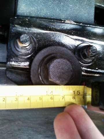

Thank you all so very much for your advice. I'm going to follow this thread hoping someone can put a tape measure to their LCAs. Johnc, 14.5" is what I got on my stock LCAs, too. JMortensen, I hope you are right about the arm NOT being threaded, because if it is, the spindle will have to come out to adjust. Brandon, I already have camber plates-I'm working around a bunch of conflicting issues to get my tires to clear my unrolled fenders. I would roll my fenders, but they have been cut and spliced together and I don't think they would roll correctly. I wish I had a ratsun so I wouldn't worry so much about my paint job, but I have really nice paint and I truly regret not fixing my fenders before having it painted. If I didn't have stock fenders, I wouldn't have this issue at all. Over the years, my goals for this car have changed. First it was to look good, then it was to handle as an L24 autocross car; now it is to drag and autocross with an LS2. Compromise is the enemy of excellence, but I have to make a lot of compromises. I'm going to order a set of the MM LCAs and I'll give a report back in a couple of months. If anybody has a used set, I'm in the market; I'll put a parts wanted thread in and see if anybody bites before ordering new. The LCAs and an R200 LSD are competing for the same pot of money. -
