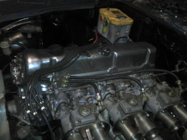

I just gave my L24 long block to my buddy and he put it in his 1970 240z. He installed the triple Webers and a 280zx electronic distributor from his old engine onto my long block. We cranked it and set the timing. Car ran really rough with an irregular exhaust burbble and some snapping and popping, so we moved to synching the webers. I set the idle mixture screws for leanest mixture without slowing the engine speed (essentially 1-1/2 turns off bottom) and balanced the carbs as best I could and the engine smoothed somewhat and ran much better under power. However, the unisys bead bounced erratically in the air column on cylinder #6 (closest to firewall). We sprayed starting fluid all over that carb trying to find a vacuum leak, but had no luck. I balanced my triple Dellortos regularly on this same long block, and I don't recall the unisys bead bouncing like this before and the car ran smoothly and produced good power and was competitive at autocross. He will check compression tomorrow looking for a bad valve and we will swap in my fixted plate distributor. Anybody have a suggestion for what type of an issue produces a bouncing unisys bead?

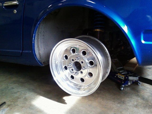

WTB - Used 4-bolt Weld draglite 15X7 w/ 4.5 to 5.0 back spacing
RebekahsZ replied to RebekahsZ's topic in Parts Wanted
I found some Weld 15X7s on ebay and bought them. -
