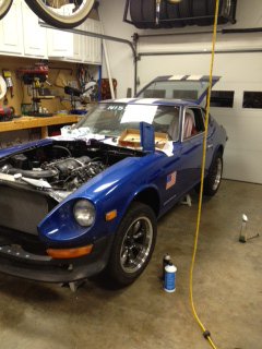

Brake dragging fixed. Clutch adjusted-well, sort of. I still don't like it, but it neither slips nor fails to release like it did yesterday. Drove it to parts store tonight to return excess trans fluid. Gonna try to limp it 3 miles to work in the morning. No hood, no mufflers, no horn, no wipers, no heater-should be fun. Do you still get one call from jail? IMG_0129.MOV -

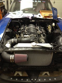

Celebratory burn out will have to wait until I have the line lock wired and will not be done in my neighborhood-my neighbors have been VERY UNDERSTANDING. I'm a little scared of this thing. Plus, my rear brakes are dragging BAD-will start trouble shooting Tuesday night. The elbow on the cold air intake is the stock one from the 2006 GTO LS2-it fit perfectly; I have an extra one that I cut off a bit that you could have for postage, but I pretty much ruined it. I am really pleased with how nice the cold air intake turned out. The shifter "boot" is the 1972 240z boot that I trimmed carefully with wire cutters-it is not perfect and I may try to come up with something better. I wish my car were a 1970 model because it would be easier to do side exhaust in front of back tires: the 1972 has a seatbelt recess that gets in the way. Thanks for all the support from HybridZ. -

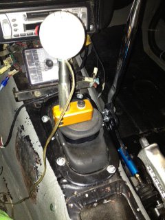

Sorry, I used that term to differentiate between the rubber boot UNDER the console (dust boot) and the cloth/vinyl/leather one that is ON the console. Some guys don't know the rubber one is down there under the console. If the rubber boot is good, the cloth one is just for looks. -

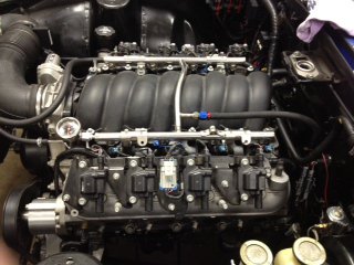

It runs and drives. Two buddies came over this afternoon: John from Sunday school and Jake (Jacob1971 from this forum. Well, we had a productive afternoon. Installed JTR headers and dump tubes. Cranked up car-it started on the second turn of the key-it was awesome. The car immediately ran perfectly. Oil pressure gauge worked, Temp gauge worked, radiator fan worked, fuel pump was not especially loud. Looked for a long time looking for oil, water and fuel leaks but found none. It took me forever to get car in reverse because I'm used to a 5-speed. Car sounds amazing with straight pipes. I've tried to make some videos, but they are turned sideways and the files are probably pretty big. Took car for test drive-these swaps are scary fast. The Drive By Wire gas pedal works perfectly, but it is very light, so it will be easy to get carried away with the go pedal. I've got to adjust my brake linkage rod between the booster and the master cylinder-I haven't got much pedal left over. The clutch pedal rod is adjusted all the way out, but I can't tell if tires are spinning or if clutch is slipping. Went around the block taking friends and family on joy rides. By the end of the fourth trip around the block, the rear brake calipers were smoking and stinking-seems I've got some dragging brakes to figure out. Looked under car and I thought I saw brake fluid, but it may have been just water from a puddle just before my driveway. I'm pooped and calling it a successful day. I'll find any leaks from the puddles I expect to find tomorrow. Thanks to everybody on the forum who has helped me get to this point. IMG_0125 (1).MOV IMG_0126 (1).MOV -
	Anybody found a really good boot to use, or some other smart mod to help seal the shifter to the trans tunnel? I found out the hard way not to use a dremel tool to cut the rubber-the rubber turns soft and sticky when it heats and stays that way, even after the rubber cools (gets on eveything kind of like chewing gum). The rubber is too thick to cut with scissors or a knife, but trims in a controlled way with diagonal cutting wire snips. My solution is neat, but doesn't seal well because of all the different contours in the stock 240z dust boot. The shifter I used is an F-body shifter from MGW. Please send pics of your shifter dust boot.

Finished trimming shifter boot (kind of a sloppy job-would love ideas on this); shifter installed. Bled brakes. Can't get air out of clutch hydraulics-please send tips-bench bled clutch master cyl and using remote bleeder, but still fighting air (I think that is the problem). Antifreeze and trans oil in (messy job). Re-made flex fuel line-old version seemed too short and had a lot of tension on it-now it wiggles freely. Finally finished fuel pump wiring. All 4 wheels and tires mounted. Gonna put 5-10 gallons of fuel in it tomorrow-I haven't bought high-test in decades. Goal for tomorrow also includes wiring tach and cable-x speedo and fixing stereo wiring I accidentally yanked out. May also re-install rear swaybar. -
