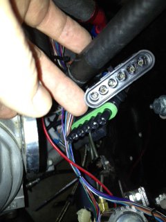

Thanks everybody. I am pretty sure that I had the red wires plugged in and just had the green wires wrapped up and not connected. Is the neutral switch an auto trans thing or a manual trans thing? If I remember correctly, I could start my z with the car in neutral or in any gear if the clutch was in. It was great! I hate my modern pickup that requires that I have the clutch in to start the car. I cut the red wires to length (to add a weatherpack connector once engine is out again) and cut the bullet connectors off the green wires and put heat shrink over the cut ends. I'll just tuck the unused green wires inside the loom that will run down the side of the frame rail. Thanks to everybody who came to my aid (like knights of the round table or minute men). I'm gonna let this thread pass on into history for the next guy who finds himself in this position. Keith -

Uh-oh! I've got one vote for long green wires and one vote for short red/black wires...what to do? Anybody feel like climbing under and checking? -

	I'm trying to finish up the wiring on this LS swap and I didn't mark wires well enough before removing my L24 last year. Car is a 1972 240z, manual trans. There are 2 sets of 2 wires on the passenger side of my engine compartment that go back toward the transmission. There are two short red wires with a black stripe and two long green wires. QUESTIONS: 1) Which of these two sets of wires goes to my reverse lights? 2) What is the other pair of wires for?

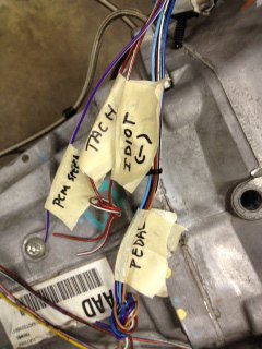

39 spline? Holy cow, that ought to be indestructible. Who makes them? I'm gonna keep the 280z stubs i just changed to-if I don't get this car on the road, I'm gonna shoot myself!! Maybe a future mod.... Yesterday's progress: Wired DBW pedal using weather pack GM-style connectors. Ran all wires intended to go to driver side of cockpit too: tach, speedo, line lock, idiot light and something else I can't remember...have only done the firewall side of these, just measuring engine side and I'll cut and add weather packs next time I pull engine (hopefully for the last time). Don't really like GTO gas pedal with the hinge-it may be more comfortable for the general public, but it seems funny to be heel-toeing toward a moving target-it just feels funny; will likely try to make that pedal solid in the future. All of this psycho OCD wiring perfectionism is intended to make it easier to service and remove engine. Located OBD/Data port on passenger side since I always see people putting their laptops in the passenger seat. Ran fuel pump relay activation wire with remoted battery cables along passenger side rocker panel. Spend several days running back and forth to exhaust shop to make some side-exit dump tubes. Don't freak out-these are just to allow me to start car with O2 sensors installed and to allow me to keep some fumes out from under car when working out the initial bugs and fixing the fluid leaks that I anticipate upon initial start-up. Also will allow me to either nurse the car to the muffler shop or to the alignment shop, whichever comes first. With my 145/80/15 front tires and 26" rear tires, there is about 2-1/2" of clearance to garage floor-not near enough to keep on a street car. Heck, the return road at my local track is too rutted up for me to keep these side exhausts, but they sure look cool for now. I bet they are going to be loud. Learned about a big problem with the JTR short headers: it is a real PITA to get a wrench on the collector flange bolts. I'm in the group buy for long tube headers, and if the long tubes allow enough ground clearance, I'll just swap to them when they arrive. If they don't allow enough ground clearance, I plan to re-sell them and switch to some sort of ball/socket collector connector on my JTRs-I just can't see that I'll be able to tighten the collectors enough to prevent recurring leaks. Will post more as I get work done; changing clothes to get out in the garage now. -

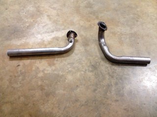

Making up some "start-up head pipes" just to get car started with O2 sensors installed so that I can take car to exhaust shop. The group buy for longtube headers is going well, so I may just wait for that to be completed. -

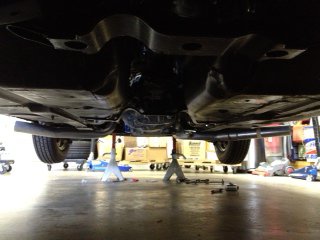

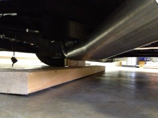

All my fittings are from Speedwaymotors.com. Alainburon-I sent you a PM. There is a big drawback to mounting the fuel pump in this location: If you want to run dual exhaust that turns toward the stock location for the muffler, all this fuel pump stuff is in the way. That is forcing me to use single exhaust prior to going under the rear suspension/diff. -

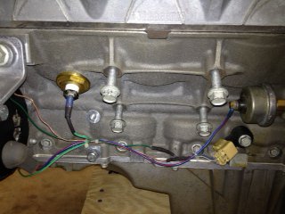

	I'm starting into the exhaust portion of my LS/240z swap. Currently have JTR headers. I found several scorched wires on the donor car wiring harness to include the knock sensor wires and O2 sensor wires, and I want to keep that from happening again. There's not a lot of room under the car, so I'm torn about where to put the O2 sensors, and I want to figure it out before I finish the wiring harness, in case I need to move the O2 sensor wiring. Please post the location of your O2 sensors and post a picture if you have it, and it will be a big help to me.

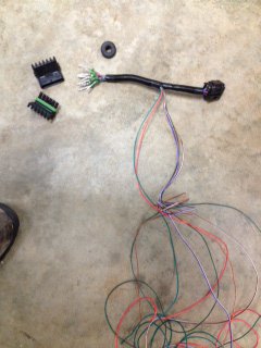

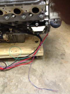

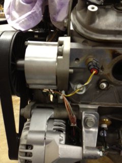

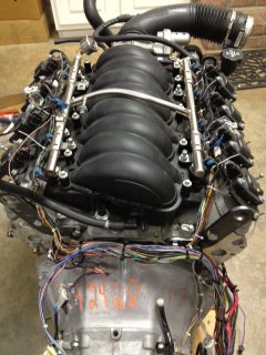

Wiring. The first pic shows the engine harness with all the split casings removed and organized with zip ties. Next is the passenger side of engine: since I moved the cold air intake to the passenger side, the MAF wiring needed to be moved from the driver side to the passenger side-perfect length, no cutting. Found out that my engine supplier gave me an LS1 MAF instead of an LS2 MAF because the plug doesn't fit; LS2 MAF ordered (whats ANOTHER $100?). On the left side of the engine I made a little harness that re-routes the knock sensor wiring via the front of the engine to avoid the direct heat of the exhaust. The water temp wire was added as was the oil pressure. That is routed along the alternator wire from the drive side to the passenger side of engine to mate with the 240z engine bay wiring. I re-routed the alternator and LS2 water temp sensor to be more neat as well. Finally, all the wires that will enter the cockpit were relocated to the drive side in order to pass them into the cockpit via the existing choke cable hole in the firewall. Not depicted is a jumper wire off of the transmission VSS high speed wire (blue and white) to send a signal to the Cable-X. I plan another test install of engine into car (I'm getting pretty good at it) before putting split casing back on the harness and adding weatherpack connectors. -
