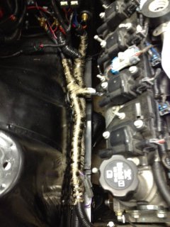

	I'm finishing up wiring this weekend and will probably be connecting and disconnecting my battery a lot as I work thru my mistakes (I can't do anything right the first time). Anything I should do now (and in the future) to protect and show respect for my LSx ECU/PCM? I guess this thing has some sort of internal battery to maintain codes? This is my first excusion into a computerized car! I'm going to disconnect the three plugs into it until it is time to test the fuel pump, but once I hook it all up, should I do anything special before doing stereo work, etc other than disconnecting the battery? Please recall my earlier post titled: "Just burned up engine harness" in order to understand the idiot you are advising.

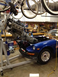

This weekends progress. Put engine in for final time (I think). I swear I installed and pulled that motor 10 times trying to get everything right. As everybody warned me, poly motor mounts were a PITA. I pray I dont have to pull the motor, or even lift it, to install the longtube headers. If I have to, I may just sell my longtubes off. They are at the ceramic coating place right now (or on the way). Don't know how long it will take to get them back, so I'm toying with installing the JTR headers that I have, just so I can get car running and start finding leaks, etc. Spent most of weekend finalizing passenger side wiring harness for the engine. This is the harness that includes the hot wire to the alternator and starter, and also includes the primary ground wire for the battery-engine and battery-chassis. I used the GTO cables and cut them down a little, re-routed wires for maximum exhaust clearance and to avoid the tight spot between the lower steering u-joint and the alternator. Soldered new lugs on the cut cables. After cables were all sized and trial fit, I wrapped them in split loom, then wrapped the areas close to the exhaust in header wrap and secured it with metal ties. When i can drive car over to buddy with a sheetmetal brake, i will make a heat shield between header and wiring. Wrapped starter in a heat-reflective blanket. Tomorrow, I plan to finish fuel pump wiring (I can't seem to get under car for this while sun is still shining! Then, I think the only wiring I will have left is to hook up speedometer and tach. Then, when I have time, I'll start making wiring harnesses for racing aids like 2-step and line lock. Then heater, wipers and radio, R200 LSD conversion with CV axles, shortened rear LCAs (when will this end!!!!). Clutch line is installed and tightened, motor is totally in with torqued bolts and a fully installed driveshaft. Tires are off for brake bleeding, then I'll bleed clutch line. Hope to buy fluids on Thursday and start filling on Friday. The coming weekend should be noisy-will post video if I can figure out how. -

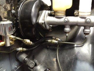

Flex lines to master cylinder done. Used front 240z stock flex lines. See before shots two posts back and after shots here. Hoping this mod will make adjusting the push rod between the vacuum booster and master cylinder easier. Also should make any vacuum booster maintenance easier. -

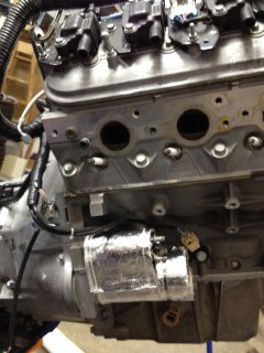

Just got an email from Blake asking me to pay the $245 to pay for ceramic coating upgrade. He's ready to send them off to coating place. I gladly sent him the money via PayPal! Getting fired up! Will send pics when they arrive. Just bought a little heat blanket for my starter. -

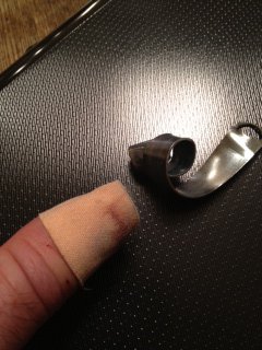

So far, I think the welding slag in the ear would get my vote for worst, although the welding rod in the leg is a fierce comptetitor. Thread is not meant to discourage stories of car crashes. Flesh is flesh, no matter how you slice it. I did repeated novocaine nerve blocks to my thumb thru the weekend, but I was starting to turn my thumb into hamburger and had to come up with a better plan. Surprisingly, hydrocodone mixed with Darvocet is a pretty good (effective) mixture. I slept like a babe last night. Pain was tolerable on Loracet 10s today. -

	I always see threads started asking how much it costs to do an engine swap into a z-car. I'd like to post the question another way: How much of YOURSELF have you donated to your z-car? I've seen lots of threads showing mechanical carnage, but none showing physical carnage. For example, I offer my latest car-work related injury. See pic. I was trying to increase the mounting hole size in a strap hanger in order to support my LS2 wiring harness at the back of the intake manifold by re-drilling the bolt hole with my drill press. Drill bit found a bur in the sheet metal, yanked stainless steel strap from my grasp and wound around the drill bit, pinching the pee out of my thumb. My thumb actually fit inside that wound up metal strap! Luckily the strap tore off the drill bit with my finger wrapped up in the sheetmetal rather than continuing to rotate on the bit, or it might have been more ugly. No cuts, just major crush injury. May take another photo later without bandaid, but right now if I remove bandaid it just starts bleeding everywhere. So much for getting car running by Sunday! Maybe next weekend. I tried to just wrap it up in masking tape and soldier on, but I can't seem to do anything without a left thumb. Finally went to my office and gave myself a nerve block, so it is tolerable for the moment, but I may wake up screaming in the night when the block wears off. The up-side is that my wife has to unbutton my britches so I can pee. It hurts like hades. Post your best z-car work related injuries.
