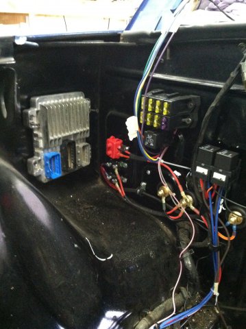

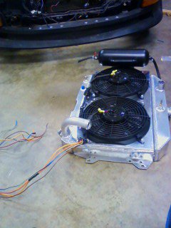

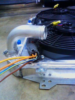

Dual fans wired. Set up is for one fan to blow when the low-speed ECU wire is grounded, then when the temp gets high enough, the high-speed wire will ground and turn the second fan on too. Going out to garage now to finish fuel pump wiring. Hope to pick engine wiring harness and PCM from repair shop this Thursday. Have bought LSD R200, R200 mustache bar, have Z31 CV axles: on M2 buying group for shortened shafts and companion flanges. Modern motorsports adjustable rear LCAs have arrived. Will delay further rear suspension and differential work until motor swap is finished. -

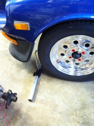

	I've seen a few threads discussing the difficulty of removing the snap-in type R200 axles. After working for about an hour with screw drivers and a pry bar trying (and failing) to pry out the axles, I then tried the tug-of-war method with both feet on the diff trying to use the outer CV as a slide hammer. That didn't work either and I probably won't be able to walk tomorrow. Finally, I took the cover off the diff and drove a large, tapered flat-tip screwdriver between the internal end of the axle an the spider gear cross shaft. The axle popped right out!! The smart guys can chime in to state whether I hurt anything, but this method worked great. Wish I'd tried it from the beginning.

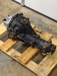

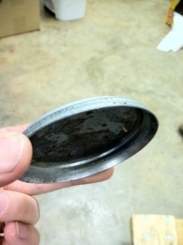

	Found ratio stamped on ring gear. It is 39:11, so it is a 3.54. As you suggested, I spent a little time with a body hammer on the CV axle end cap: got it straight enough to stay in, although it is not as tight as the other side. Boy, was it a chore getting the CV axles out of the diff (I'll be sore tomorrow). After failing with pry bars and a tug-of-war, wound up taking the cover off the diff and using a screwdrive to pry between the end of the axle and the cross shaft-that worked great. The great news is that I bought a LSD R200 from screen name CobraMatt in Atlanta. A friend picked it up over the weekend and it is beautiful. I now have a R200 mustache bar from screen name JSM. I bought a set of 27-spline axle flanges from screen name redleg so that I have the option of running my Wolf Creek CV axles while waiting for the M2 shortened axles shafts and companion flanges to get finished up. Making progress. Thanks to everybody for the help/advice. Keith

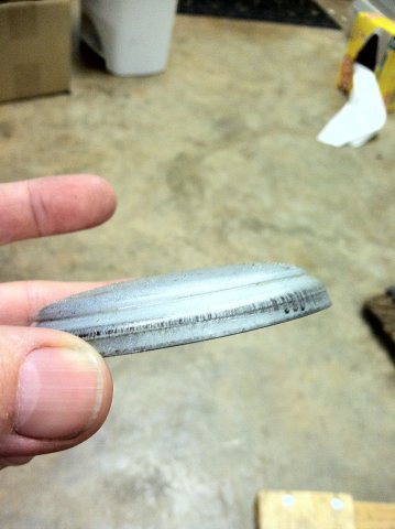

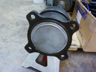

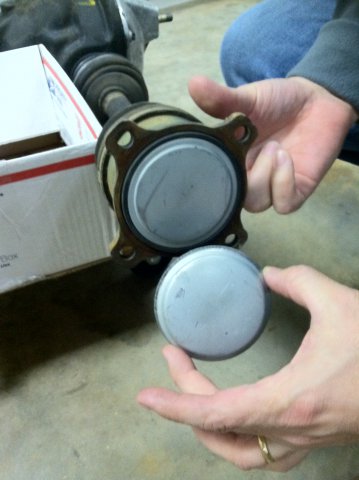

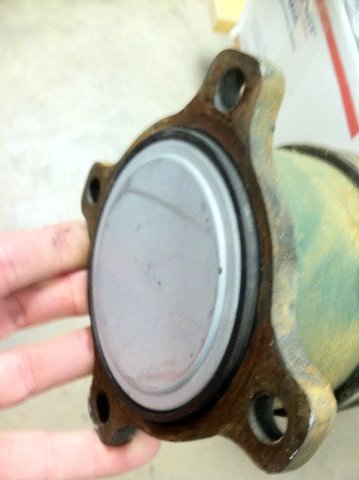

	Problem resolved. Unable to find a replacement, so I carefully took a body hammer to the bent end-cap. Restored cap to original shape - the metal was just stretched really bad. It fits a little loose, but I think it is going to work. Now waiting on some M2 shortened axle shafts. Thanks to everybody who helped me.

	The axles I got had one end cap removed, but at least it was present. However, it is not flat like the other one. It looks sprung, kind of like a sock turned inside out? I tried to get another one from sources on the forum, but the only one I found is for some other axle. I am about to take a rubber mallet to this end cap to see if it can be straightened out. Any suggestions? Pictures show both installed cap and the one that was removed. The next two pics show how it is turned "inside-out." The final pic shows a normal cap.

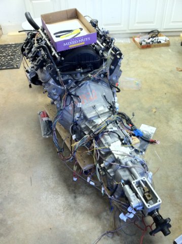

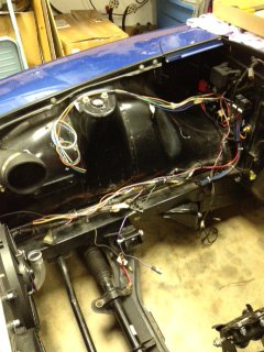

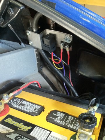

Wiring harness and PCM are in the hands of a new (local-2 hours each way) LS tuner-didn't know he was here until I had breakfast with the local Cobra club. When this is done, I don't want to every hold a set of wire strippers in my hands again! Cable called me from California and he gave me a lot of advice. Wiring for fans is all done and they work great. Reused GTO wiring harness from the fans to the relay. Looks great, should quick disconnect well. Gotta get some more heat-shrink to finish fuel pump wiring, but I know exactly what needs to be done. We will see what the local tuner comes up with. Got a Longacre toe gauge from Summit-car pushes a lot easier without an inch of toe in. Rebekah gave me a hand. It is a race to see which happens first: car running, or the arrival of long-tube headers. Still PLENTY to do. After fuel pump is oil pressure gauge wire and to put a connector on the back-up lights switch on the tranny. Have a friend picking up an R200 LSD for me in Atlanta on Saturday. Mustache bar and flanges on the way from Florida. New rear LCAs should be here this week. Thanks to everybody for the help and encouragement. -
