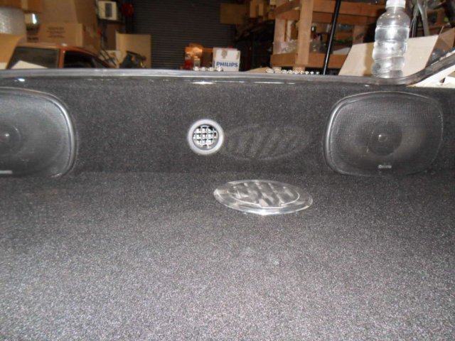

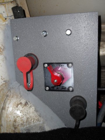

  14. Redid my remote starter solonoid and switch panel attached to the rear strut tower. Panel has the starter solonoid, master power switch, and posts for charging the battery. Had to add the charging posts because it was too hard to get at the battery once the rear speaker box was in. Built the rear speaker box to hold my speakers. ritrebor

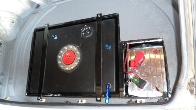

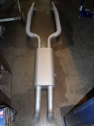

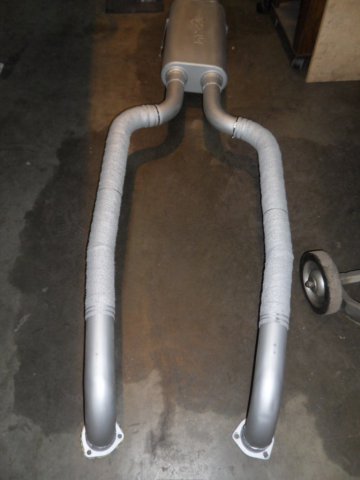

  15. Finished my exhaust. Had a problem because I put the fuelcell and battery in the back I didn't have any room for a muffler in the stock location. Originally bought 2 Flowmasters and couldn't put them anywhere under the car. Ended up going 2-1/2" pipes to a Dynomax Ultra Flo X-Muffler which has the cross over tubes inside the muffler. Dual 2-1/2" in and Dual 2-1/2" out. Just hope I have enough ground clearance. Approx 3". ritrebor

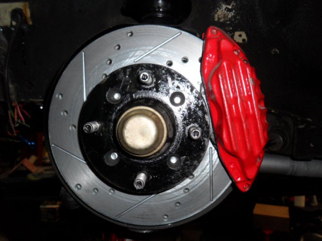

  16. Did the Toyota 4Runner vented front brake kit. Found out the spacer is different on a 240z vs a 280z. Had a 240z spacer and couldn't get the rotor on. Had to cutdown the spacer to fit. ritrebor

  18. Mine is 23"x17"x11" Around 16 gal. ritrebor
