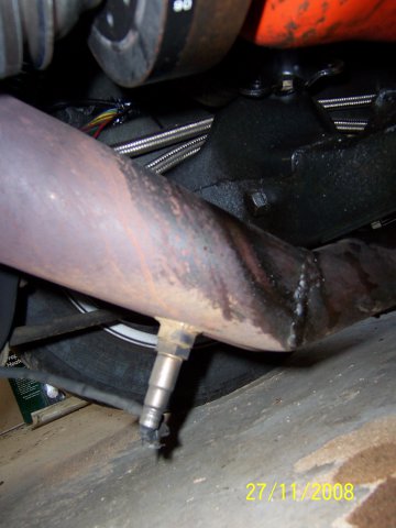

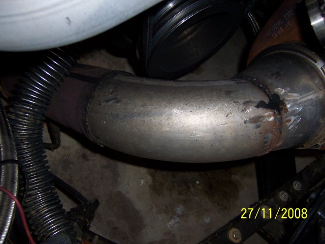

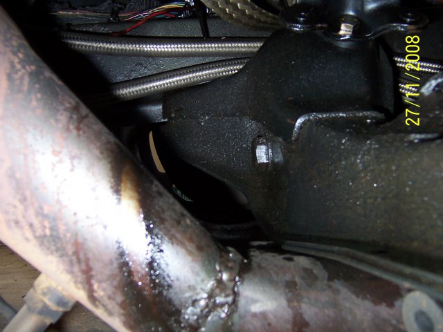

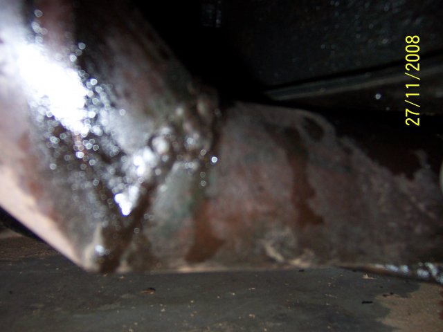

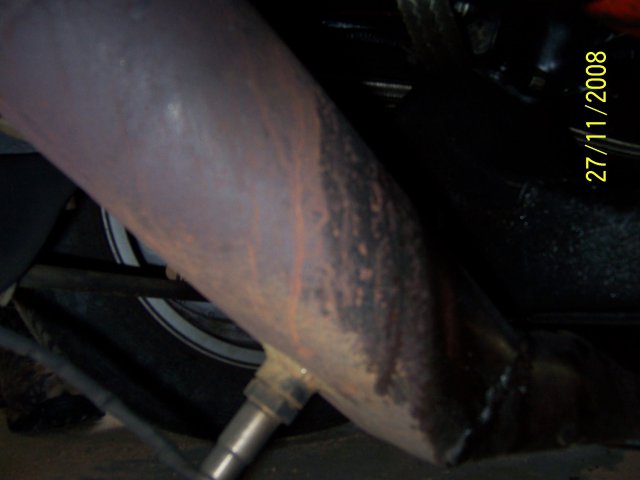

Yea I know it's dirty and there's oil on it. I haven't cleaned it since I last ran it. I'm doing the cosmetic work over winter break if I have time. The bend isn't as bad as it looks. It's smoothed out inside and I know the welds don't look the greatest, but they work. You can do it another way I thought of. Split(make a Y) the 5" into two 2.5 or 3" and run them on both sides of the motor. It MIGHT work but the Y will have to be almost right off the turbo. Have a Happy Thanksgiving.

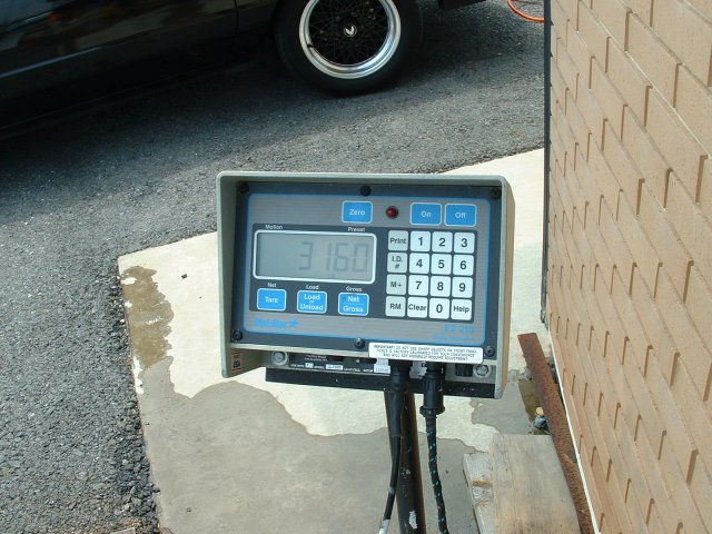

I found some more pics that I didn't know was taken. The 3160 was without the hood and me in it. I weigh 210

I bought 4" oval tubing and two transition pieces. 5" to 4" right off turbo followed by a 90 4" with a 4" to 4" oval UNDER the crossmember the whole way to differential then back to 4" tubing with a 45* and a 4" straight trough magnaflow diesel truck muffler. Keep it tight to the car and it won't scrape.
