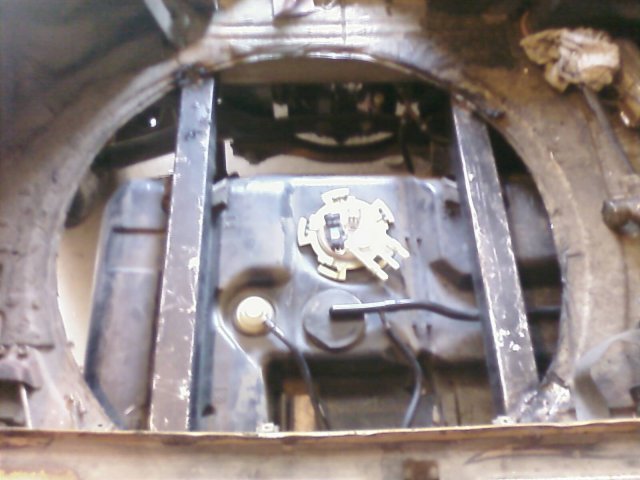

  1. Alrightly, the '02 Camaro Z28 gas tank is installed. I already have a round piece of steel to cover the spare tire hole and I am going to cut out a square above the pickup and put it on a hinge so if the fuel pump ever dies I won't need to drop the whole tank to change it out.
  2. That's cool, I have silver Sportmax 002's 16x8's with 245/50/16 (stock 4th Gen F-Body V8 tires). I asked about the stock 280z suspension because mine sits at least 3" higher in the rear compared to yours. Plus my LSx has an iron block vs aluminum. The only thing I've done in the way of weight reduction in the rear is cut out the stock spare tire well and replaced it with a piece of 10 gauge mild steel (running a '02 Camaro gas tank), but I can't imagine it shaved more than 10 lbs total.

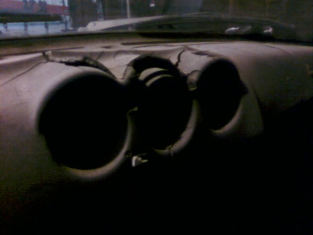

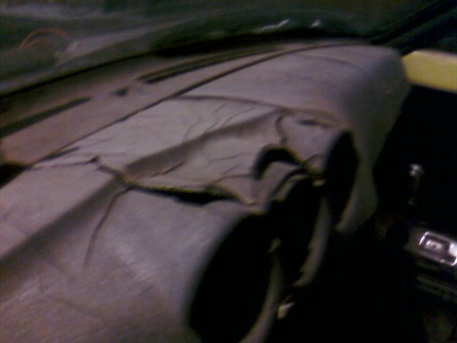

  7. As you can see in the pics (excuse the lighting), the center gauge area is missing the top area. I can move the center gauge a little right now. Will a partial (glued down) or full cap work even with this amount of material missing? The car will never be a show car, so no worries there. Thanks guys!!
  8. Cracks are okay, as long it can accept a dash cap and doesn't have a dash cap already. Pics and a price to Bakersfield, Ca. 93308 would be great. If you need to email the pics, cbright@bak.rr.com

  11. Thanks, tried that, didn't work. I ended up just cutting the area out from the inside and making a 'bubble' out of 10 gauge steel plate to put back in with the clearance I need.

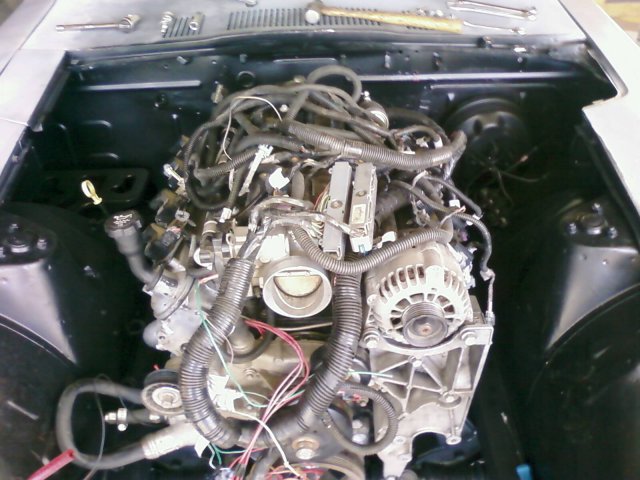

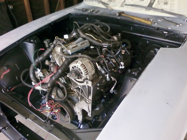

  14. Okay the motor and trans are in. However I noticed when I got underneath it to install the starter that there is no way I am going to get to my trans coolant fittings on the trans (4L60e) without some serious relieving of the passenger side trans tunnel/firewall. The servo cover is also making slight contact with the trans tunnel too. Others have mentioned the trans pan hitting too, although I haven't noticed that happening (yet). I am using the JTR's crossmember and JCI's LSx mount kit. The trouble is I don't wanna pull the motor and trans back out to do it. Luckily I think I can use a buddy's stud welder (used for body work) and a slide hammer from the inside of the car (no carpet atm) to pull the corner away to allow enough room to get to the coolant fittings. Anyone else have any ideas to get the area relieved without yanking the motor/trans back out? Thanks!!
  15. Digging up an old thread..... I got my LSx/4L60e combo in yesterday and today I noticed when I got underneath it to install the starter that there is no way I am going to get to my trans coolant fittings on the trans without some serious relieving of the passenger side trans tunnel/firewall. The servo cover is also making slight contact with the trans tunnel too. Others have mentioned the trans pan hitting too, although I haven't noticed that happening (yet). I am using the JTR's crossmember and JCI's LSx mount kit. The JCI manual didn't mention anything about beating the trans tunnel prior to install or I would of completely done it before installing the motor/trans...... The trouble is I don't wanna pull the motor and trans back out to do it. Luckily I think I can use a stud welder (used for body work) and a slide hammer from the inside of the car (no carpet atm) to pull the corner away to allow enough room to get to the coolant fittings.

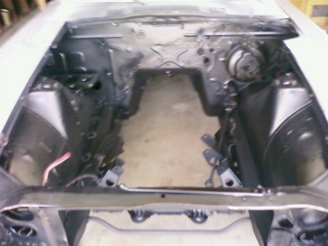

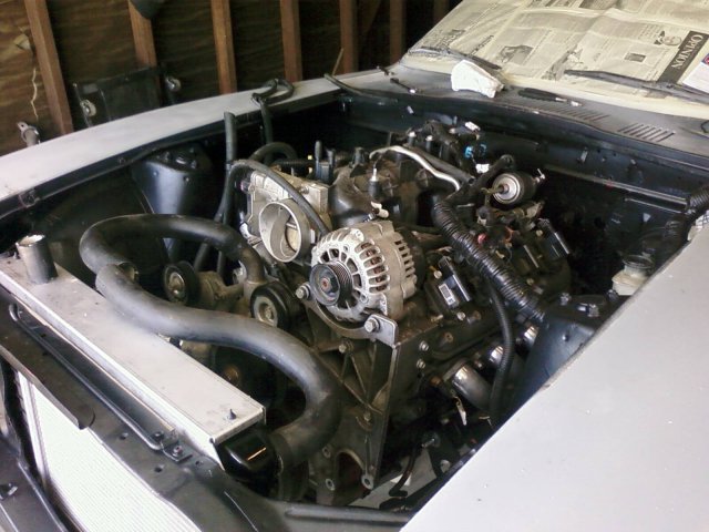

  17. Okay guys, I changed my mind about the color of the car and repainted the engine bay flat black.

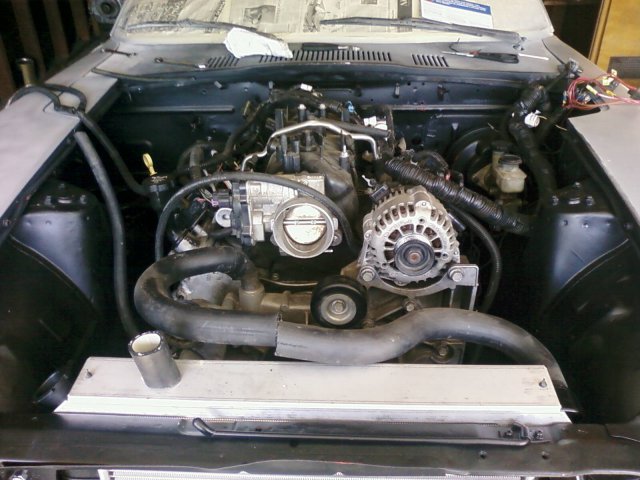

  22. Yes, I will be retaining the stock 5.3 LM7 intake (same as the LQ4/LQ9 intake). I haven't put the motor in the Z yet because I am still raising funds for the re-freshening (budget rebuild). Although I might just use the 5.3 LM7 for the time being. However my buddy Miles has the exact same intake on his 240z and the truck intake and alternator/alternator bracket will not clear the stock S30 hood. Luckily for Miles and myself that doesn't matter because we both are using cowl induction hoods that give us the necessary clearance for both.
