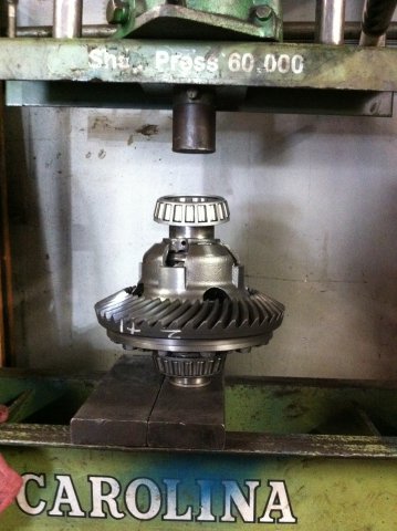

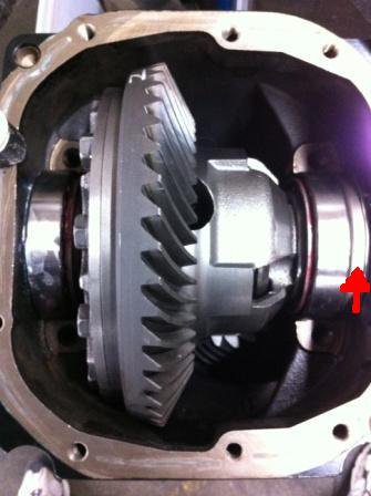

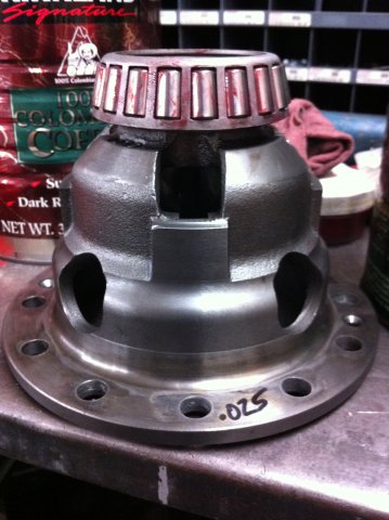

@ yessir - ???????? Not sure what you mean. Can you re-drill the output flanges? Do you mean change the spline count? The reason for using the 300zxtt diff is for the LSD. The reason for using the Armada ring gear is the gear ratio. The reason for using the 300zxtt output flanges is that they are the same spline count as the LSD and they clear the lower A arms on the car better when bolted up to a modified moustache bar. So here is a little progress on my side to side lash issue and back lash. To create the correct amount of back lash needed I milled .025 off the LSD housing shown in the photo below. This moved the ring gear over to the left (driver side) enough to gain just the right amount of back lash. I'm left shimming the side to side lash now. Issues others have had is not fully seating the bearing into the race as shown in the photos above. Additionally, there are no off the shelf shims you can use, so they have to be fabbed or use what you have. I'm using the shims from both the 300zxtt and the Aramada and I'm close but too tight. I will sand down the shims to fit. I'll post a photo showing this process later. Almost there. Sorry it is taking so long, but it is possible. Let it be known that it is difficult to do this without some machining and replacing parts. I'll be in about $1000 when all is said and done. That includes the cost of two rear ends, all new bearings, races, seals, and powder coating.

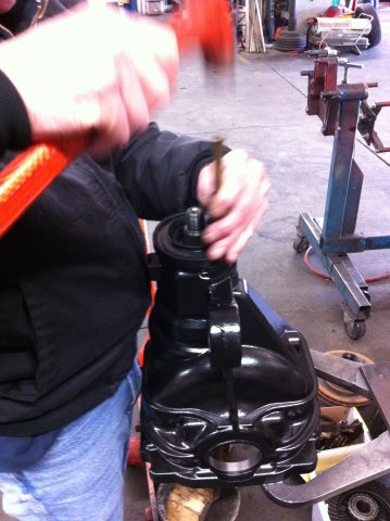

Having the right tools has made this job much easier. My friend Lewis at Oller Brothers Auto in Santa Clara (2555 Lafayette St) has also been a huge help. He's put up with my questions and led me every step of the way. Here are some more shots:

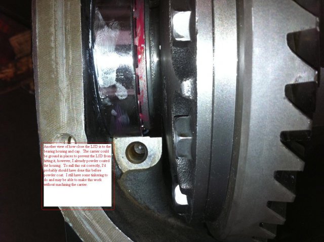

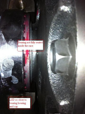

I've hit a road block as mentioned in Cyrus's post at this hyperlink: http://forums.hybridz.org/index.php/topic/40615-2941-3111-and-3361-gears-in-a-r230-i-did-it-sort-of/page__p__331349__hl__cyrus__fromsearch__1#entry331349 CYRUS WROTE: "The set up will work but I need shims of ~1.6mm on the left and ~3.54mm on the right, but nissan only sells 2.0 mm-2.5 mm. The shims are 99mm in dia. The only other issue is the right bearing only is in contact with 2/3 rds of the machined case. This leaves 1/3 of it to float in air. I am not sure if this is significant." The pictures below demonstrate what the issue is. The Armada comes with one set of shims from the factory that are the same size (2.1 MM). The 300zxtt has different size shims. I saved mine and the ones from the 300zxtt to mock up the LSD fit into the Armada. The factory shims will not work to provide the right fit. The issues are back lash and side to side lash. Back lash is the slight "play" in the pinion and ring gear movement (about 5-7 thousandths is what I'm told is correct). By moving the pinion in one direction then the other, there should be a slight play before the ring gear engages. You can feel this in your hand and hear it when you are setting this. The issue in my case is that if the side to side lash is too tight, I lose the back lash when spinning the pinion gear. So a loose fit determined what I've shown in the pictures below. I set the LSD into place with no shim on the left side and stacked up shims on the right side (8 MM shim and a 2.1 MM). With no shim on the left, I maintained some back lash. When I put in a 2 MM shim, the back lash went away. I have a little room to play here, but not much. The bigger issue here is that the bearing does not fully seat inside the race. If I do push it all the way in by moving the LSD over more to that side, I lose my back lash, but the LSD nearly hits the inside of the case where the bearing caps bolt to. To correct this I think I'm going to have to shim the back side of the bearing to move it into the race. I still have a lot of playing to do and right now, I could easily put in another 20 hours to figure this out. I've got a call into Z-GAD and Cyrus who have both done this. Hopefully they will have some insight on this issue. It is going to take some playing around. Unfortunately, Nissan only makes shims from 2 MM to 2.7 MM in .05 increments. I will have to make custom shims or find the Ford Raytech shims that Cyrus used. More to follow as I figure this out.

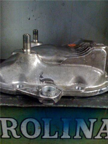

And I was wrong, the ABS sensors can be pressed out and will not interfere. Sorry for any mistakes. The finned 300zxtt cover fits great.

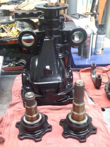

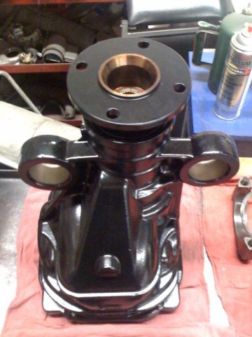

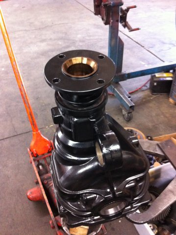

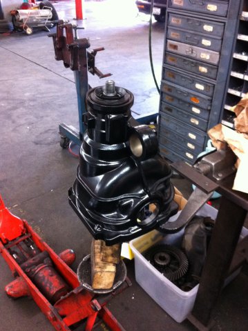

Got the diff case back from Spray Technology (Santa Clara, CA). I went with 40% black on the case and pinion flange. Also did the stub axles in 40% wet. I'm waiting on the last of the bearings to put it all back together. On the next phase, I should have it back together less the shims for the side to side clearance of the LSD. Tyson

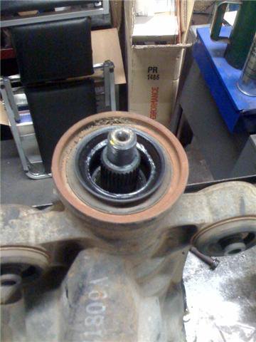

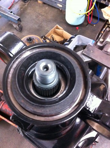

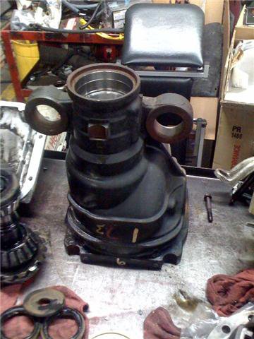

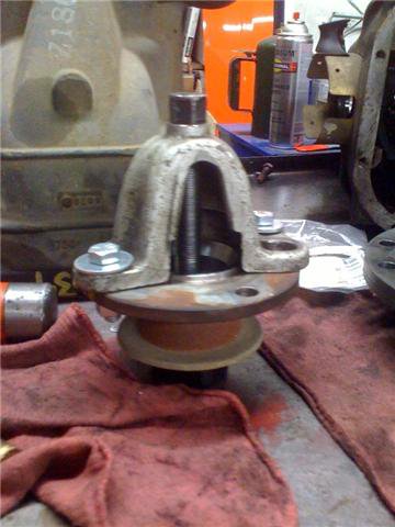

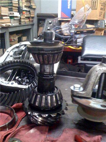

Finally got some time to hit the project again. I removed the pinion flange. The pinion took a huge beating before I gave up and looked for this puller. The pinion was in there super tight. I removed the remaining gaskets and finally have a bare case to work with. I've sent it out for powder coat, along with the inner stubs and pinion flange. I noticed that the 300ZXTT cover where the anti-lock brake sensors go, where pressed in. SO...I WAS INCORRECT ABOUT THE FITMENT OF THE 300ZXTT COVER ONTO THE ARMADA DIFF NOT WORKING. INFACT, IT WILL. When the parts come back, I'll show the reassembly. Making progress.
Okay, so I'm back on track with some new updates: Here are two photos showing the LSD Finned Cover from the ZXTT R230 on the carrier of the Armada R230...it doesn't fit without shaving the ABS sensor provisions. Next was removing the inner stub axles from each differential. I'll show the Armada as the ZXTT R230 inner stub removal is the same process. Notice that each inner stub has a ring to help hold the inner stub in place inside the differential. The inner stub axles are removed with a slide hammer: Now you can see the visual difference between the Armada R230 inner stub axles and the ZXTT R230 inner stub axles. They are very different. From the top working down to the flange the Armada stub diameteres are approx. 34mm, 36mm, 50mm and the same length. The ZXTT stub diameters are 32mm, 40mm, 50mm and vary in their length. ALSO NOTE, THE ARMADA STUBS ARE 33 SPLINE, THE ZXTT STUBS ARE 31. THE ARMADA R230 STUBS WILL NOT FIT IN THE LSD FROM THE ZXTT R230. Lastly for this series of the post, notice the difference in the ring gear. The Armada on the left, the ZXTT on the right (LSD). The Armada and ZXTT use 17mm bolts to secure the ring gear to the gearing or LSD. The Armada bolts are larger in diameter though and will not fit through the LSD holes from the ZXTT. These need to be drilled out to pass the Armada bolts through to secure the Armada ring to the ZXTT LSD. A quick trip to the machine shop and this was done in 5 minutes. The LSD is not hardened, it almost appeared cast for as easy as it was to cut through. Armada: ZXTT: Armada bolt in ZXTT LSD. The spider gears from the Armada and the LSD from the ZXTT show bearings/races at each end. When inside the housing, the side to side lash is minimized by shims as shown beneath the bearing/race cover in the next photo. This shim varies based on the tolerance difference in each item made from the factory. Once I've determined what my variance will be, I'll photo what I've used. That's it for now. I still have to remove the pinion. To make this right, I'll buy new seals, races, and shims. I'll send out the carrier, inner stubs, and pinion to be powder coated. Stay tuned.
